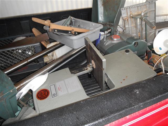

Purchase an older model...price was right and it looked in very good shape.
It will be even better after I am done cleaning and replacing any worn pieces.
Question concerning when replacing the belts..?
Should a person do an upgrade from the Gilmer style to the Poly V set-up..?
The Quill assembly now has a two bearing set-up on it already.
Pro and cons, of such.
DSCF2602 (Small).JPG (64.88 KiB) Viewed 2922 times
DSCF2603 (Small).JPG (59.28 KiB) Viewed 2922 times
DSCF2604 (Small).JPG (49.93 KiB) Viewed 2922 times
DSCF2612 (Small).JPG (45.69 KiB) Viewed 2922 times

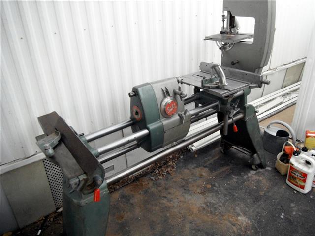

This is the Greenie before even a clean up, I do know the band saw is at the wrong end..
Bring a old tool back to use. 1956 Greenie

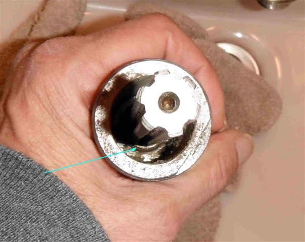

As for the the quill the part that I thought was another bearing must be a
split two piece washer, pic of the end.
DSCF2677 (Small).JPG (45.54 KiB) Viewed 2879 times

That is a spacer used to hold the end of the quill shaft near the center so as to facilitate insertion into the sleeve when installing it into the headstock. Without it the end of the shaft wobbles all over the place.

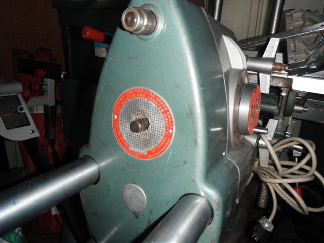

To many irons in the fire right now, am in the process of cleaning up the inside.

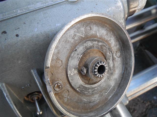

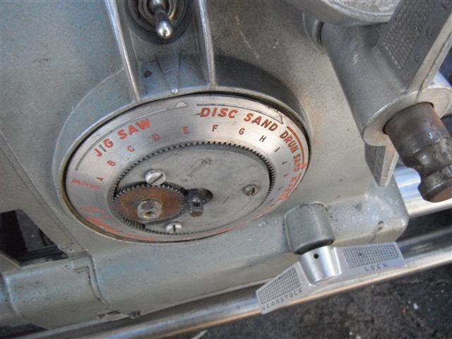

Everything is working but the speed control looks a little offset, plus the Allen screw has been replaced.
I am going to upload some photo's, would appreciate any suggestions or if someone see something that may be wrong.

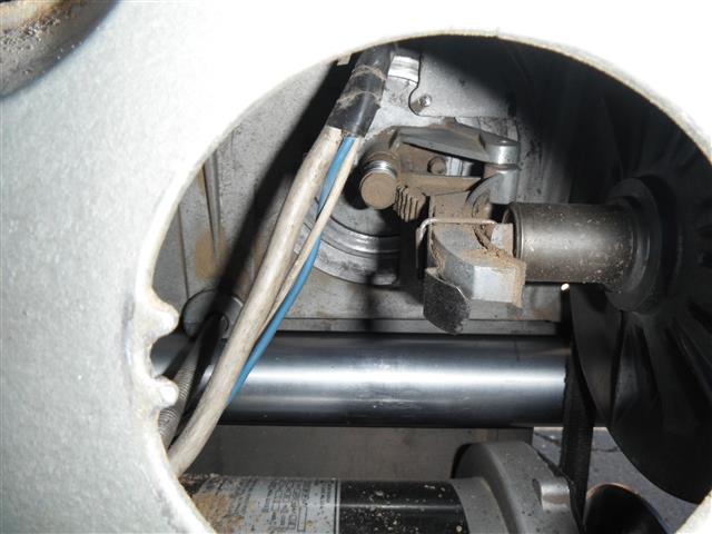

DSCF2697 (Small).JPG (45.55 KiB) Viewed 2683 times
DSCF2700 (Small).JPG (50.14 KiB) Viewed 2683 times
DSCF2701 (Small).JPG (54.98 KiB) Viewed 2683 times

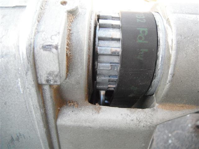

The Gilmer sprocket and belt...which appears to be loose.
DSCF2698 (Small).JPG (45.77 KiB) Viewed 2683 times

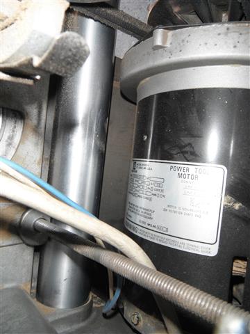

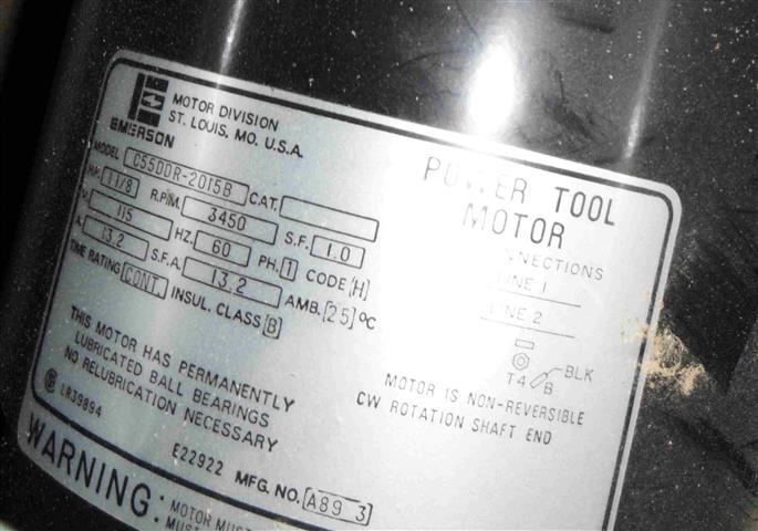

Finally the motor..which looks to be a replacement
DSCF2713 (Small).JPG (35.76 KiB) Viewed 2683 times
Looks to be larger than the original.

Better pic of the motor..
DSCF2718 (Small).JPG (57.29 KiB) Viewed 2683 times

Pic #2701 speed control has been modified to accept a standard machine screw. There should be an allen screw with a 3/32 socket. Also the flange of the speed control has been ground away to permit a screw driver to get to the screw.
The set screw is supposed to engage the dimple in the hole visible in the shaft seen in pic 2700.
The speed control "porkchop" seems to have some wear but is fixable using a repair kit from Bill Mayo on this forum. I am not familiar enough to comment on the Gilmer drive sleeve so I don't know if the wear on the sprockets is normal or not.
Others will chime in with more details.

That is a later Mark V 1 1/8 HP motor. The Gilmer pulley wear looks normal. It looks like there is a Gilmer clutch in this pulley that may have problems. I test for around 12 to 16 ft pds of torque on these clutches. I have parts and tools to rebuild these Gilmer clutches.
