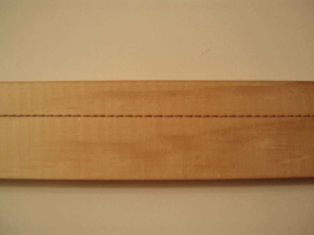

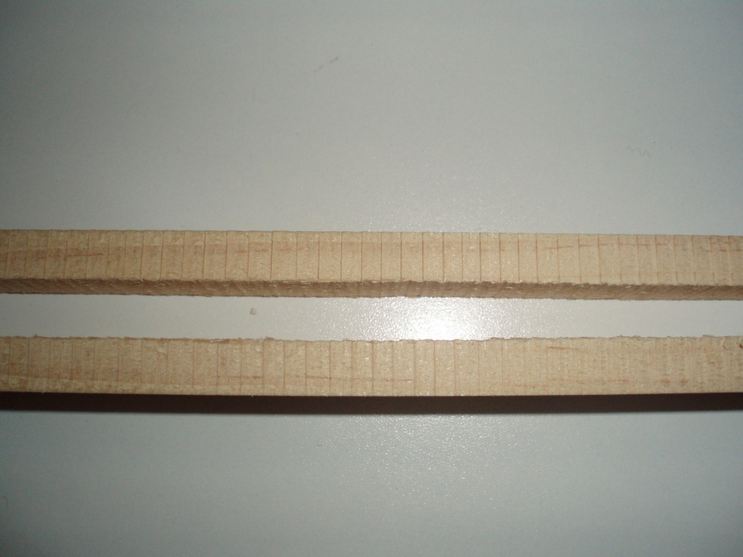

I got up this morning anxious to check out my other band saw with the previous resaw blade. Immediately I recognized that it is not a resaw blade. As best I can tell, it is a 1/2" combination 6or7 TPI raker (555196). It cuts straight both when ripping and when resawing. Cut quality is terrible (for a resaw blade) but may be what is expected for a combination blade.
This is the Shopsmith Description of the blade that I think I am talking about:
E. 1/2" Combination Bandsaw Blade:
1/2" Combination - 6 TPI Raker - Heavy-duty, general-purpose blade for wood, plywood and nonferrous metals. Suitable for wood up to 6-inches thick and metal work on stock up to 1/2-inch thick. 2-inch minimum radius.
A couple pictures of the cut quality:
Blade Saw Cut Quality 004 (Large).jpg (480.66 KiB) Viewed 62374 times
Blade Saw Cut Quality 007 (Large).jpg (661.92 KiB) Viewed 62374 times
I guess this might be an example of "the right tool for the job". In other words, I'll use this blade for cutting plywood and 2/4s.
