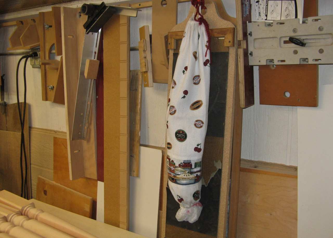

I Keep a supply of grocery sacks. They are useful for all sorts of things. Some time ago I found this sack holder tube you can stuff sacks in the top and pull them out one at a time from the bottom.

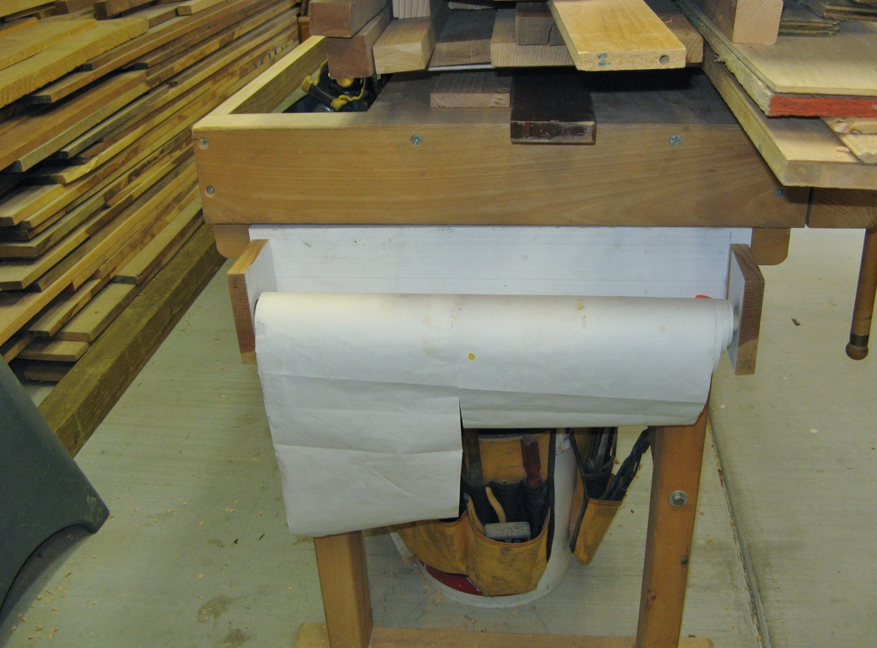

Because freezer or butcher paper has a plastic coating I have used it for many years to protect the bench top from glue,stain or paint. Also the uncoated side can be used to write on.
