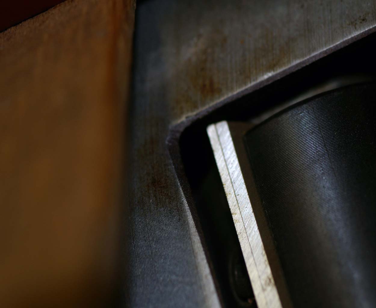

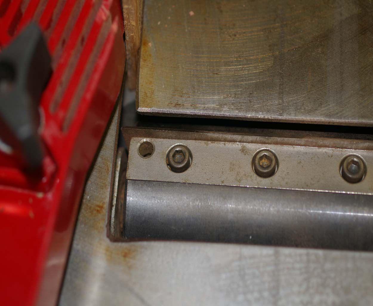

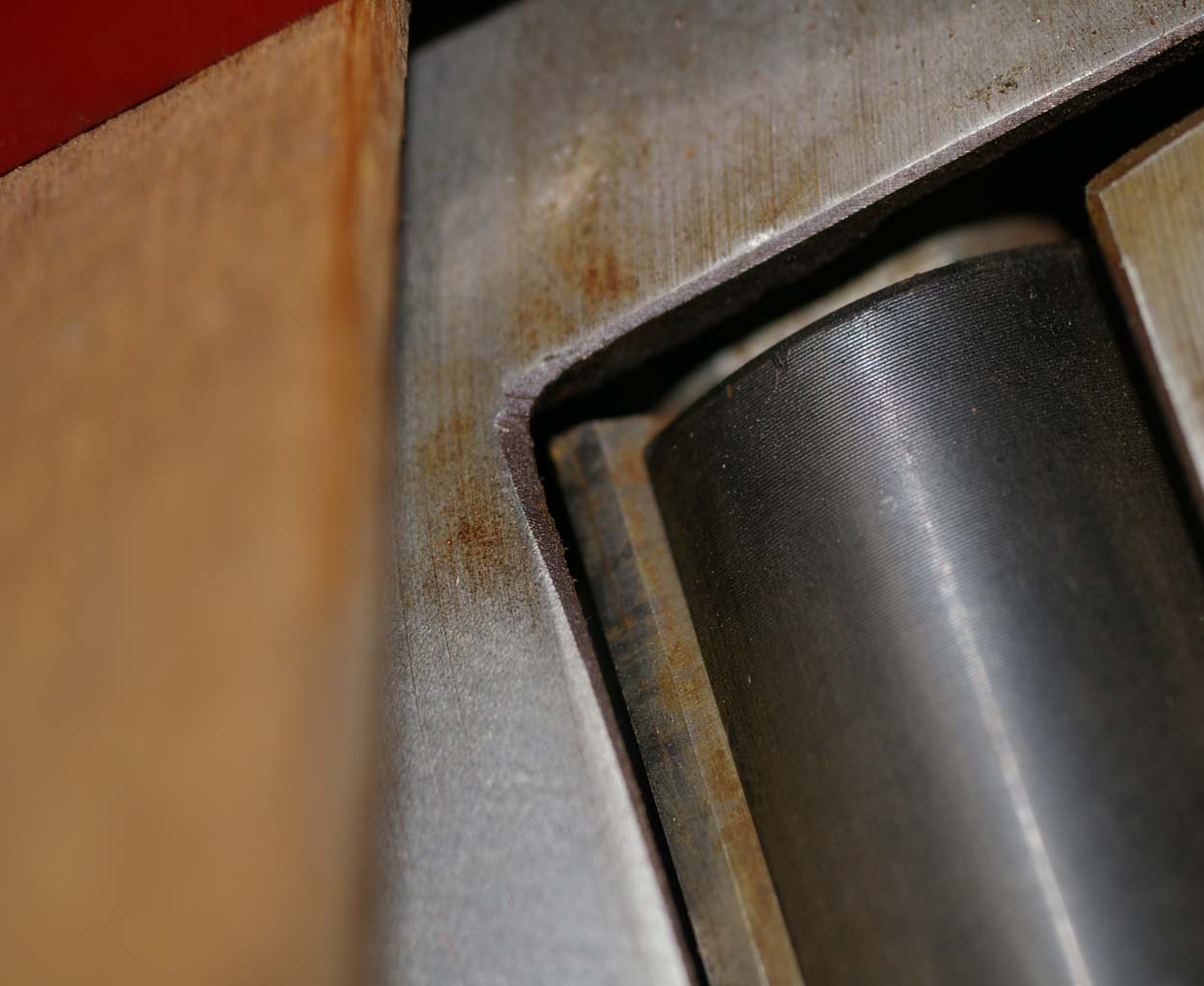

After looking at your pictures, I am not convinced my knives are SS. If I am reading the owners manual correctly, they should be proud of the left side of the out-feed table 1/32". These appear to be at least 3/16 or so. They could be relocated to the right a 1/16' or so. Can you tell me what is the exact length of a SS knife? These appear to be too long to me. Look at the attached pics.
Before I start taking them out I would like to know if in fact they are the correct length. It won't be the end of the world because it wouldn't hurt to get them sharpened anyway.

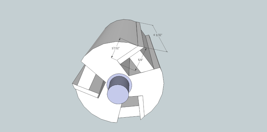

My jointer blades are 4 1/32" long. They measure 1/8" thick at the back side (non-cutting edge). Mine measure 17/32" from the non-cutting edge to the cutting edge but mine have been sharpened (meaningless dimension).

I just measured mine and they match Dusty's, though they vary by 1/32 total. Notice there is a significant angle on the outer edge (away from fence/headstock) - the tip is undercut a bit. Look at my second and third photos. I can't tell if yours are like that, and I only assume all SS knives are.
The very very important thing to verify is that they are thicker at the base than at the edge side. Unlike other makes, SS uses this to lock the knives in place, and without that wedge shape they won't stay in. This means - far as I know - you have to use SS knives in their planers and jointers.
It looks like you can move them inwards a bit. Is it enough to make a difference? If they are ss knives it should be.

The 'correct' IMHO lateral position for the knives in the cutter head will extend very slightly beyond the outer side of the outfeed table. When so, a rabbet cut will just clear the vertical 'side' of the outfeed table.
Yes the knives ends are undercut slightly so the 'inner' surface of the end will clear the workpiece surface the 'ends' create.

P.S. After taking another look at the pix above, the knives extend too far out. See 'IMHO' above.

Are you saying my photos show knives too far out as well, or just his?
I noticed there is still chalk marking both tables with a large "18". The date in the castings differ by a month or so, so I assume this is to track which were ground together. Like a little time capsule, seeing that.
Re: ss Jointer questions?
I cannot tell for sure in his pix, but in yours yes.fitzhugh wrote: . . .
I did not get the line correctly aligned with the side, but you should get the idea.

My never used set of blades measure. 4 1/32 long. 49/64 in height. 1/8 thick at the bottom and 7/64 thick at the bevel start.
