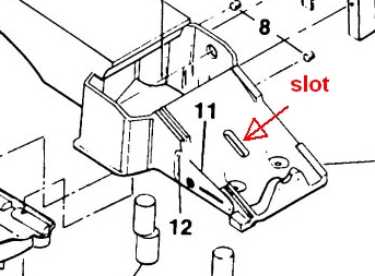

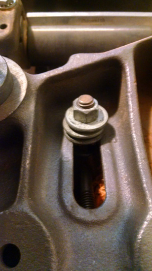

Re: ss Jointer questions?
washer/spring stack sequence
jointer stud stack.jpg (55.44 KiB) Viewed 2529 times
slot
slot
jointer slot.jpg (51.51 KiB) Viewed 2529 times
The stud passes through the slot, then the washer/springs and finally the nut. The washers/springs and nut are all below the outfeed table, NOT between the two tables(the exploded pix is misleading re the sequence).

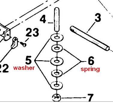

wa2crk
Obviously I wasn't very clear in my original post. JPG's diagram shows what I was trying to say in an unclear manner.
Don G

The stud #4, in JPG's post, with the washers and nylock nut should be tightened just enough to prevent the infeed table from moving when the jointer is in use. If the table moves while in use the depth of cut will change and cause problems and possibly a dangerous condition.
The purpose of the washer/spring stack is to tension the sliding surfaces. Consider them a gravity assist or bump up stop! ;)
As for inadvertent movement, the infeed table is captive in the adjusting 'knob' groove. As long as 'final' depth of cut adjustment is made while raising the infeed table, it should not move.(eliminates backlash)

Here is what the washer and spring set look like from the <b>underside</b>:
Washer and spring stack from underside
Jointer Washer Spring Stack from Underside.jpg (82.17 KiB) Viewed 2406 times

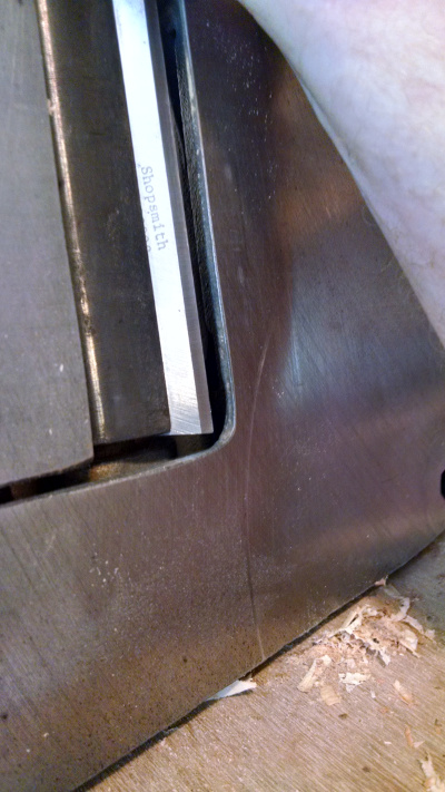

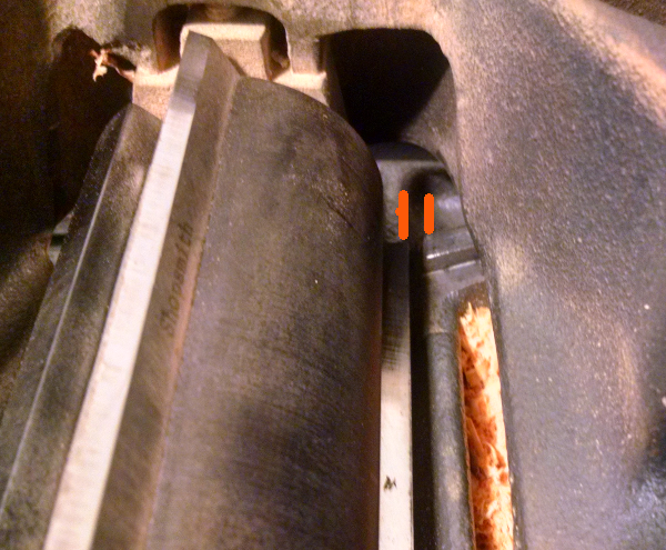

From the top I see this much clearance when the infeed table is adjusted all the way past zero until it reaches the end and the adjustment bottoms out. There is still a fair amount of space and the table is above the outfeed (not very useful):
Clearance when infeed table is bottomed out beyond zero (infeed is ABOVE outfeed)
Jointer Clearance Bottomed Out From Top.jpg (130.7 KiB) Viewed 2406 times

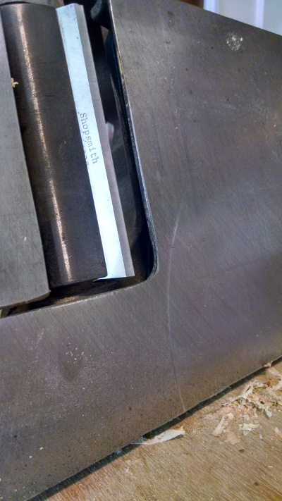

Here it is when set at zero, tables at same height:
Clearance when infeed is at zero
Jointer Clearance At Zero From Top.jpg (138.2 KiB) Viewed 2406 times

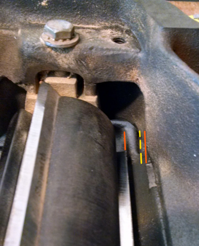

And bottomed out viewed from the bottom, with closest clearance point inside marked (about the same as the clearance with the table from top):
Clearence when bottomed out from underside
Jointer Clearance Bottomed Out Underside.png (517.42 KiB) Viewed 2406 times
From bottom, set to zero:
EDIT: The green dashed line shows about where the knife is when bottomed out, since I didn't take the photo from the same angle as the previous one. Forgot to explain that.
Clearence at zero<br /> from underside
Clearence at zero
from underside
Jointer Clearance At Zero From Underside.jpg (94.08 KiB) Viewed 2406 times
I tried to configure my jointer so they would hit and found nothing to change. When I loaded the photos just now I saw that that may be why. Check where they are side to side. Note that my knives are new, so they aren't just worn down and shorter. Hmmm - make sure you do have actual shopsmith knives. If you don't they may not just be taller but they won't safely work, as shopsmith knives are thicker away from the edge (as you probably know, but just to be sure). Anyhow, hope this helps. My jointer needed a cleaning anyhow since I used it without the dust collector yesterday. Sure fills up fast!

Just realized - I don't think anyone asked: where is it hitting?
