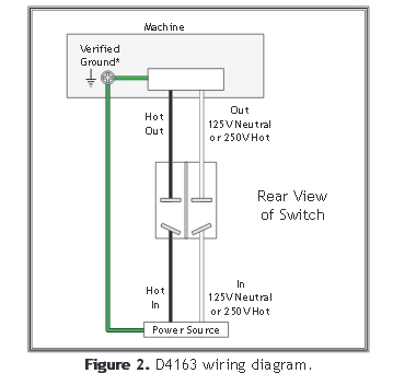

http://www.grizzly.com/products/Toggle- ... itch/D4163
Bill V
That is a good price for this switch and it meets the electrical specifications.
How many terminals does it have? In the image, it appears to have only two (a single section switch) which might explain the price difference from what I have been paying.

Re: 20 Amp Safety Switch for C Series Headstocks
While it is true that a DPST switch will have four terminals, I reiterate that in the image linked to in this thread the switch does not appear to have four terminals and the component description does not indicate DPST. I suspect it to be a SPST switch thus the lower price. This is not necessarily bad. It simply means that there is no "spare set of contacts".
dusty wrote:While it is true that a DPST switch will have four terminals, I reiterate that in the image linked to in this thread the switch does not appear to have four terminals and the component description does not indicate DPST. I suspect it to be a SPST switch thus the lower price. This is not necessarily bad. It simply means that there is no "spare set of contacts".

I did state " This appears like you say to have only two, that are bridged side to side when switched."
It would indeed have been helpful to have a view of the back of that switch.

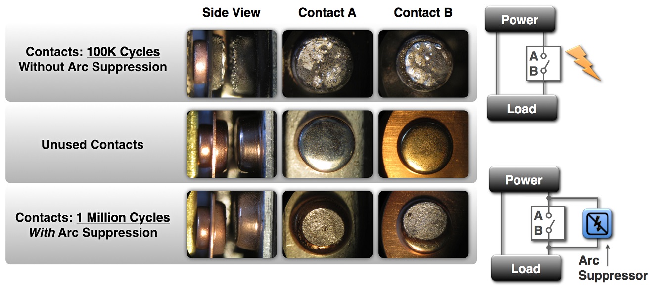

I am trying to mitigate the damage caused by contact arcs present when inductive load of the motor starts and stops. Some sort of Arc Suppression similar to that used in relay circuits which often switch rapidly, is very similar to a power switch in that the relay manually engages and disengages contacts by action of a magnetic field pulling on a spring loaded actuator, while switch contacts are manually moved by a lever mechanism which manually engages and disengages contacts.
Below I have placed an illustration that shows the result of switching loads with and without suppression. My point is only that if we can determine an affordable option for similarly arc suppressing Mark V Shopsmith power switches, we can significantly prolong their life.
