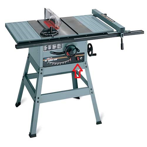

Delta 36-600 Type 2 Table Saw.jpg (40.44 KiB) Viewed 7468 times

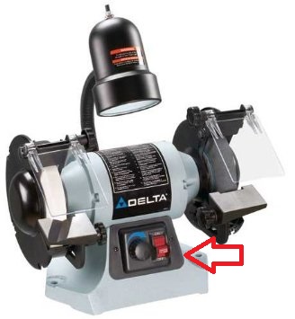

Delta GR275 6 inch variable speed grinder.jpg (28.91 KiB) Viewed 7468 times

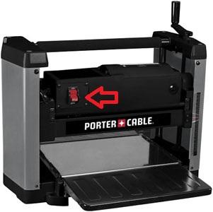

Porter Cable PC305TP.jpg (38.89 KiB) Viewed 7468 times
And there are dozens more out there. I also know that folks sometimes choose to replace this with a 20A Rocker Switch that is not a Safety Lock-Out Switch, when kids safety is not a concern.
