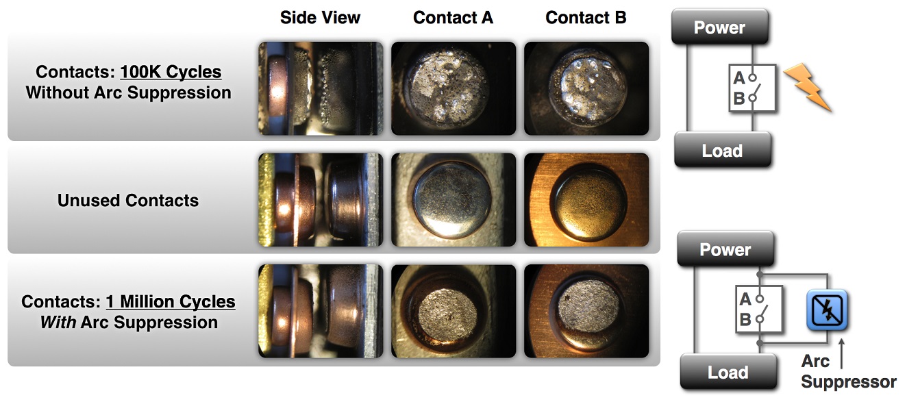

I am trying to mitigate the damage caused by contact arcs present when inductive load of the motor starts and stops. Some sort of Arc Suppression similar to that used in relay circuits which often switch rapidly, is very similar to a power switch in that the relay manually engages and disengages contacts by action of a magnetic field pulling on a spring loaded actuator, while switch contacts are manually moved by a lever mechanism which manually engages and disengages contacts.
Below I have placed an illustration that shows the result of switching loads with and without suppression. My point is only that if we can determine an affordable option for similarly arc suppressing Mark V Shopsmith power switches, we can significantly prolong their life.
