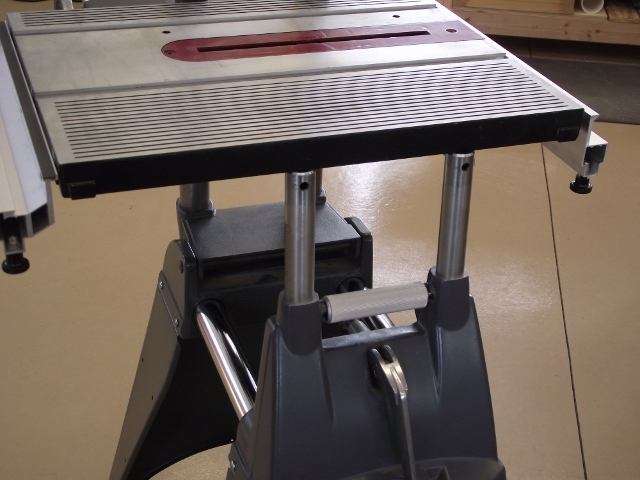

As far as sharpening, I use the cone shaped stone that SS provides for that purpose. I also hone the outside flat surfaces of the chisel on a granite surface plate using 600 grit and then 1200 grit paper. I sharpen every time before I use the chisel.
I have not used the mortiser with my dedicated MK V drill press yet but with the angle iron support for the carriage and the front table support I am using the table is going no where and not flexing.
