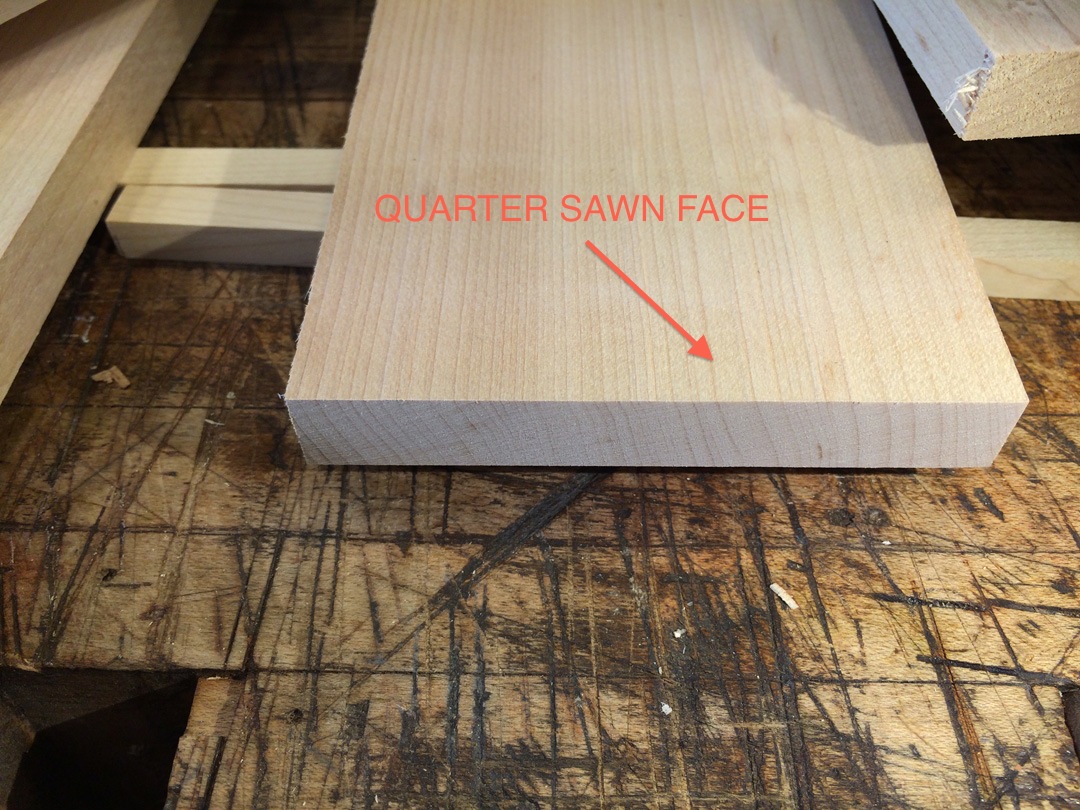

JPG wrote:I would be looking at the grain on the wide sides. Are you 'face' jointing them?
I am face jointing the boards.
Here are pix showing grain patterns on face and on edge.
Based on Ben's comment I think that I have to learn to better read the edge for grain pattern.
Forrest
Re: HELP! Jointer has started to taper boards
Forrest
In that last pix, the left end of the board need be the leading end.

JPG wrote:
Forrest
However the grain direction may vary over the entire length.
Right on, JPG! That one was easy to read, I wish they all were. Grain direction change is very likely so I keep cuts to 1/32 or less.
Forrest

JPG wrote:
Forrest
With that point in the grain, I'd try it the other way. The left end being the trailing end. A lot wood depend upon how the rest of the edge looks. Sometimes it's just a crap shoot to try one end, then the other end. :eek:
