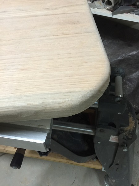

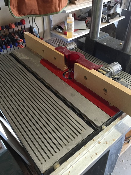

The diameter of the hole in the router table insert for the SS is 2 1/8 or perhaps 2 3/16. A 1 in rounding over bit is too big for this opening--about 2 1/2 in. Even a 3/4 rou8nding over bit is very tight. So I decided to use a 5/8 rounding over bit with 1/2 shank. Using the under table router configuration, the set up is straight forward and very safe. See attached photo. While this works and is safe it does not quite give me the radius that I wanted. I accepted that as a trade off for safety and will smooth the edge with sanding to get as close to the edge as I can. Moving forward I may look for a used SS table and have a machine shop create an opening that is around 3 in so that I could use such a table in a safe set up. Thanks for all the input.
- Under table set up.jpg (154.46 KiB) Viewed 3488 times
- finshed edge.jpg (86.22 KiB) Viewed 3488 times

Yes that is much safer.
Now you might want to make your own table insert. They are reasonably easy to make and you could increase the hole size up at least a bit. I think the insert is like 3" wide but without checking I might be off on that. You also have to look at the table to see just how big a hole you can use. I have a post somewhere here on making an insert to hold collars and inserts so you can get an idea of how that would look.
