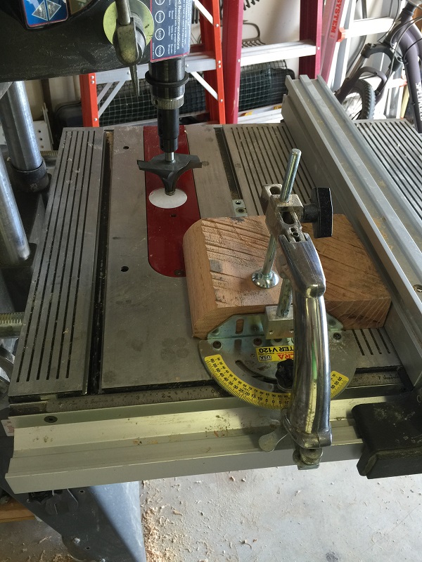

Thanks guys. The round off bit is to big for the normal insert, that is why I went to above the table configuration. For the fence I have been using the SS fence like that for a Mark VII. I will send pictures. If I do go to under table then I will have to make a special table and fence.

Here is a picture of my set up
- set up for 2 in oak bull nose
- large round over set up.JPG (220.1 KiB) Viewed 4284 times

Your instincts were right on -- that is a very dangerous setup. Trapping the workpiece between the bit and the fence is a recipe for a severe kickback.
To avoid that, you need something configured like the Shopsmith shaper/router fence.

I just did some grooving in the rails/stiles for paneled cupboard doors in the under-the-table mode using the speed increaser and shopsmith split fence. Worked great and felt very safe. I completely agree that taking the time to make an auxiliary table with oversize hole for that big bit would be time really well spent. Just looking at that monster bit and imagining it spinning around above the table scares me. Looks even scarier than a fly cutter, which is already scary enough. With a bit that big I think it might also be worth while making some sort of a box that would bolt to the standard fence to cover all but the working edge of the bit.
I had an idea similar to that after I got the split fence set up the other day. I wondered if maybe I could have simply used the regular rip fence with two sacrificial pieces bolted on, leaving room for the bit between. In my case the bit was a 1/4 inch straight bit, so it would not have required the sacrificial pieces to be very thick. I think I would try to come up with some variation on this if I had to work with that 3" bit.
