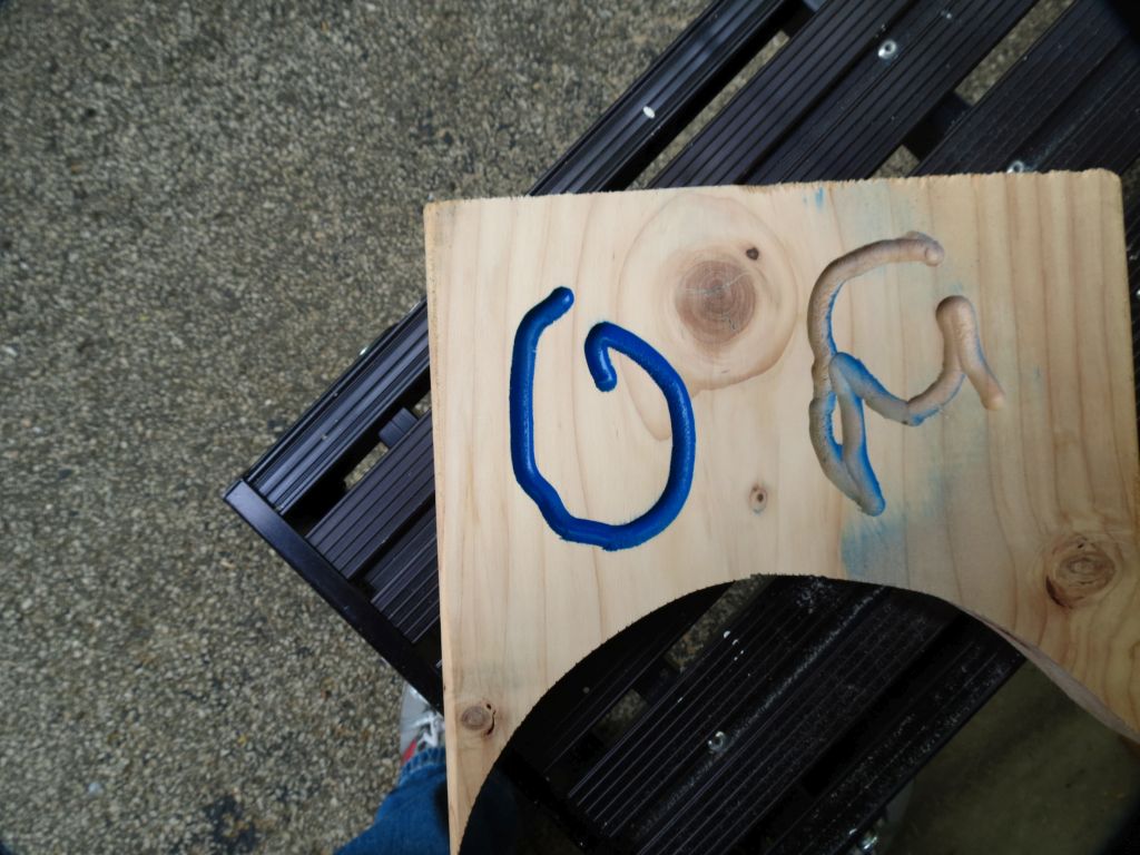

I haven't placed my order for ink yet but I might just get a can to try. I have a test piece I've coated with Thompson's WaterSeal that I will be painting tomorrow weather permitting. The outcome of that test will let me know if there is any hope in that direction.
As time permits I will test a few solutions just for my own sake and understanding of the process. Since I ruined the design on my plank chair and had to sand it off I've been on a quest for a better way, or better materials.
Again thanks everyone for your contributions to the thread.
Re: spray ink question
Don't want to bore you too much but the finals came down to the waterseal and the deft. Due to cost and the facts of my testing the deft is the winner. Here are the two finalist in their sand-off state.
First the runner up
and the winner.
I had used just one coat of the deft, I think a second coat might be worth the couple of minutes and extra material used.
The end results are not perfect but soooo much better then my first try with a spay of clear over and then the blue paint which bleed a LOT. Either of these two methods would be a solution.
