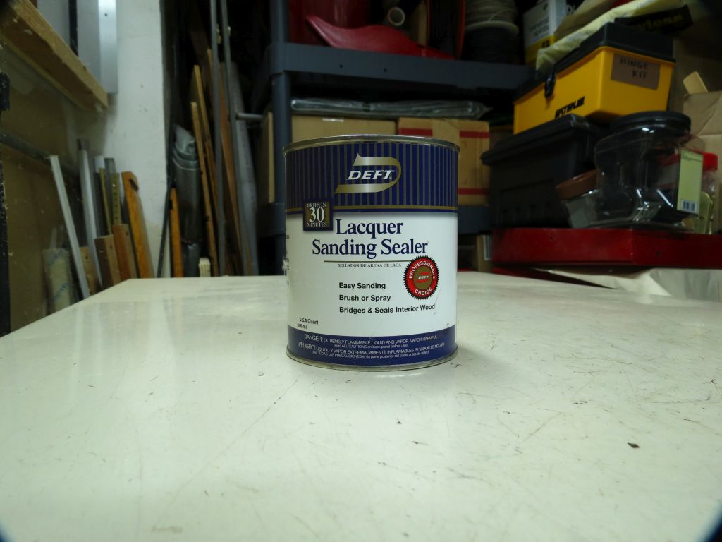

So here is the project, well the parts we are talking about in this tread. As you can see it is a vanity sort of thing but none the less I still want it to look good.
The only sanding sealer I have on hand is this:
I guess I could try it as well.
roy_okc
Posts: 818
Location: Moore, OK
Re: spray ink question
Post by roy_okc »
Ed,
That is worth a shot on a test piece. Still recommend several coats to ensure that end grain is completely stoppered up. Show us the progress.
Roy
