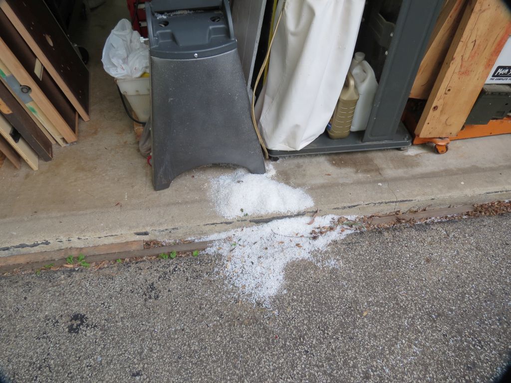

The plastic is HMW plastic but I can't tell you anymore then that as I got it as a piece in box of various sizes and colors. It mills like polyethylene and it looked like we had snow here in IL. This is a picture of what got away.

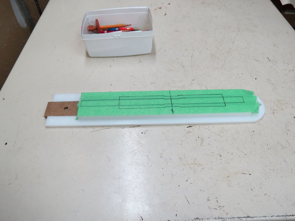

For reference this is a picture of the under side with tape in place and the outline of existing shopsmith inserts cut outs. The center line is also shown so if I need to make modifications for the hub it will be center there. I also do not for see needing to cut out the area in the plastic that matches the metal inserts, just enough to cover the normal blades I use.
The maximum width of dado I can cut is I believe 15/16" with my 8" dado but I will start by making a cut that is only as deep as I normally go and not full depth. Once I have a feel for how things are going I will decide if I will chance going full depth...... I can always remove more material but never add material back on.... Something you learn early on in woodworking.
