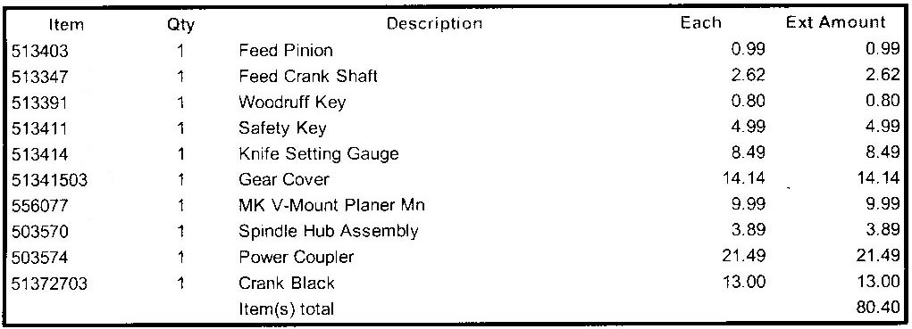

I was the original poster to thread referenced above that rjent was kind enough to remember and locate for you. I was asking many of the same questions that you are asking, and I'm sure I was not the first with this type of problem. With the help of jpg and other members, I was able to add a hand crank to mine, although the Texas heat and other projects have not allowed me to experiment with planing anything yet ... 2 more months and cooler weather and I hope to post an update with planing results. If you haven't already viewed my story, I hope it will prove to be of some help. After I made my last post, the topic morphed somewhat into a discussion of converting the voltage, so be sure to start at the beginning, not the most recent post, for information that may be of help to you. I was able to purchase many of the parts I needed directly thru Shopsmith at very reasonable prices ... I have attached a copy of my order to give you an idea of what I needed. If your new acquisition did not include some of the things like Owner's Manual or knife setting gauge, I would recommend getting those too.rjent wrote:There is a thread about converting to a hand crank. Mine is manual and I like it. It allows you to control the feed rate which I like. I will see if I can find the thread .....
Found it .... http://www.shopsmith.com/ss_forum/maint ... 16009.html
- Parts I ordered from SS
- ss001.jpg (70.7 KiB) Viewed 12137 times

Just a note here to scorelessteve regarding comments made in the thread "lock-out key".
It was reported that the safety key is not sold separately but here it is in an order to Shopsmith (513411).
