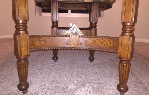

You may ask - Why that design on the legs?
I tried to mimic the shape of the legs on the dining table (an antique).
Gave up on making the curved stretchers.
Re: Once more - the Mark V comes through
With a carving knife and carving "V" and rounded gouges. You will notice I only made 1/2 of the original grooves.rjent wrote:Outstanding as usual![]()
