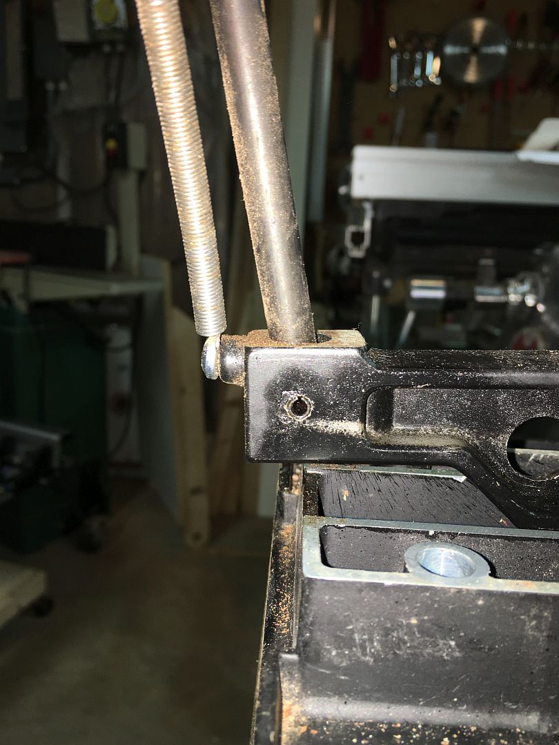

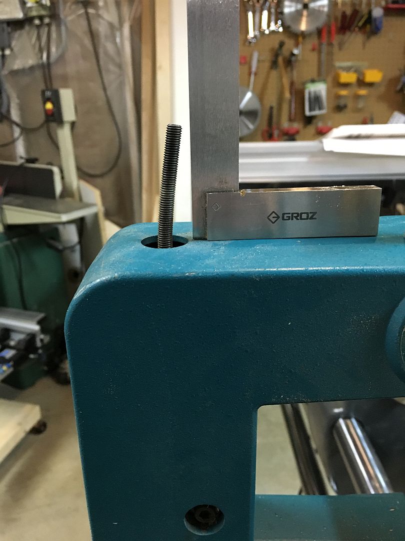

Well, I unscrewed the rear tension cam/lever and immediately discovered at least part of the problem.
I have a hard time believing that this would bend before the cam/lever would break, but hey, I'm no engineer. Is it possible that over tensioning caused this?
There also does seem to be play in the rod, so I suspect I will find the roll pin wear issue JPG had.
So, it is time to disassemble and figure out what other parts I need to order and hope the mothership can get em to me.
To be continued....

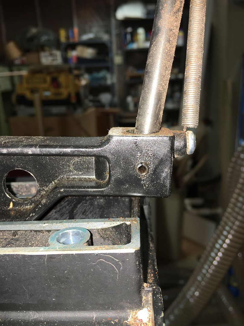

Further disassembly reveals that the tension pin holding the tension rod has NOT damaged the arm casting. :) Slop must solely be in the tensioning rod itself, which needs replacing anyway because it is bent.
Waiting on replacement parts from Shopsmith.
Maybe that will give me time to ponder how I'm going to drive out that tension pin. I can't take the arm over to my bench because the arms is held in to the base by another tension pin (part 16A, which connects the arm to the piston for the air pump as seen here http://www.shopsmith.com/service/scroll ... iagram.htm). I can't figure how to drive either pin out and am afraid of whacking on the arm in place.

Re removing the tension pin.
3 to 4 hands required. :D
Hold a heavy object against the arm, but do not obstruct pin exiting.
Use a pin punch to drive the pin through the arm. It may scarf the inside of the hole depending upon the wear.
