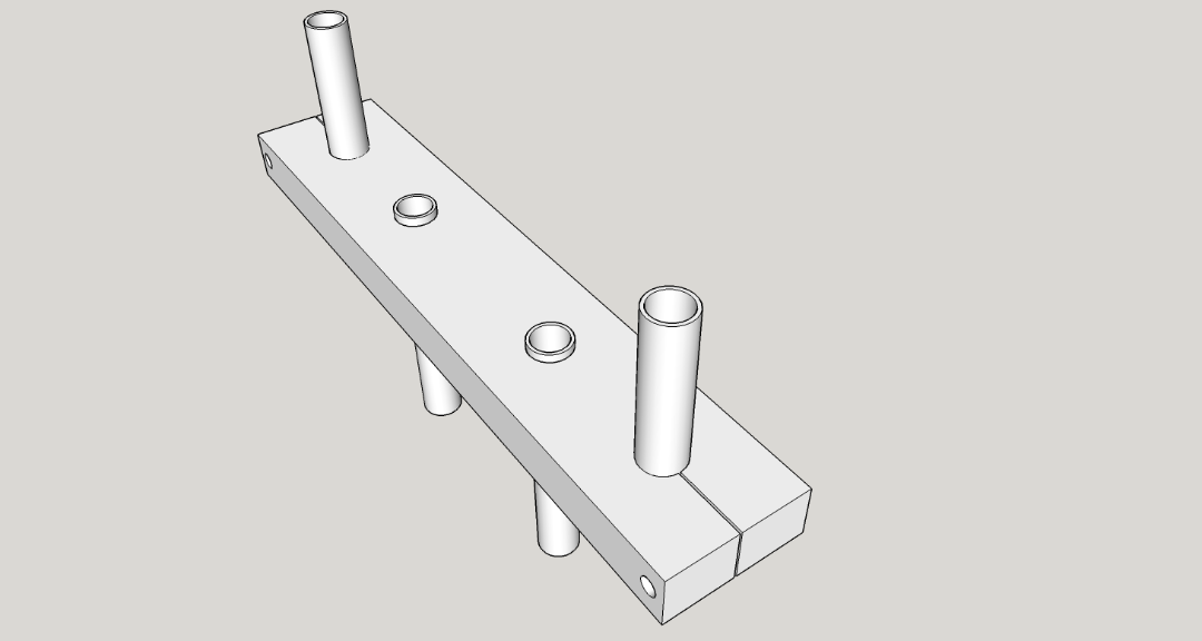

Maybe one of these.
I have one of these that I occasionally use on the Power Station to mount the Main Table there. I use stop collars to control table height.
Extension Table_Main Table Adaptor.png (45.93 KiB) Viewed 5015 times
cooch366
Posts: 337
Re: Sanding station design question.
Post by cooch366 »
dusty wrote:Maybe one of these.
YES
I assume the outer tubes fit the trunion? Did you fabricate it? Great idea. Now I'm thinking I could use a set of extension table legs and add tubes for the table. Or maybe even add tubes to an extension table to accept the main table.
To the shop...
THANKS Dusty.....

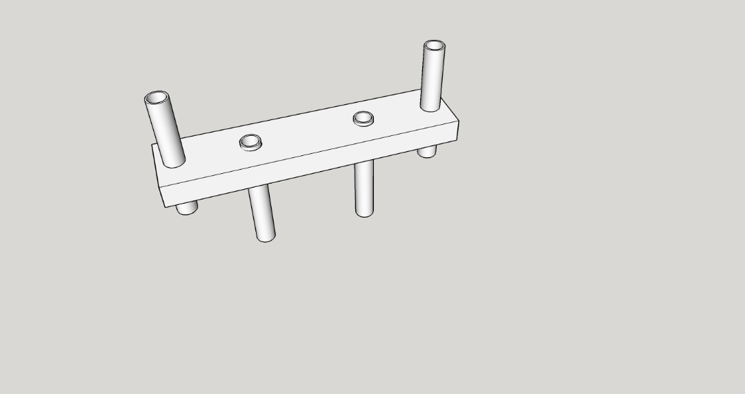

YES
To the shop...
THANKS Dusty.....
The inner pair of tubes were inserted where I would normally install an extension table. I happened to have a pair of legs from a damaged trunnion that I used for this application. Extension table legs would work the same way and would provide "built-in stops.
Yes, the outer holes fit the trunnion (main table legs).
What I have was made from either 2 or 3 pieces of MDF laminated together but for what you are contemplating I would suggest using solid hardwood.
If you are considering this approach, I made a couple small changes to make it easier to use. A couple of bolts with wing nuts make it easy to secure the table height. Stop collars still advised.
Extension Table_Main Table Adaptor rev1.png (62.73 KiB) Viewed 4984 times
algale
Posts: 4841
Post by algale »
This is pretty clever! If I ever build a mini....
