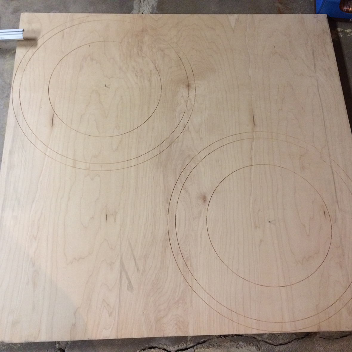

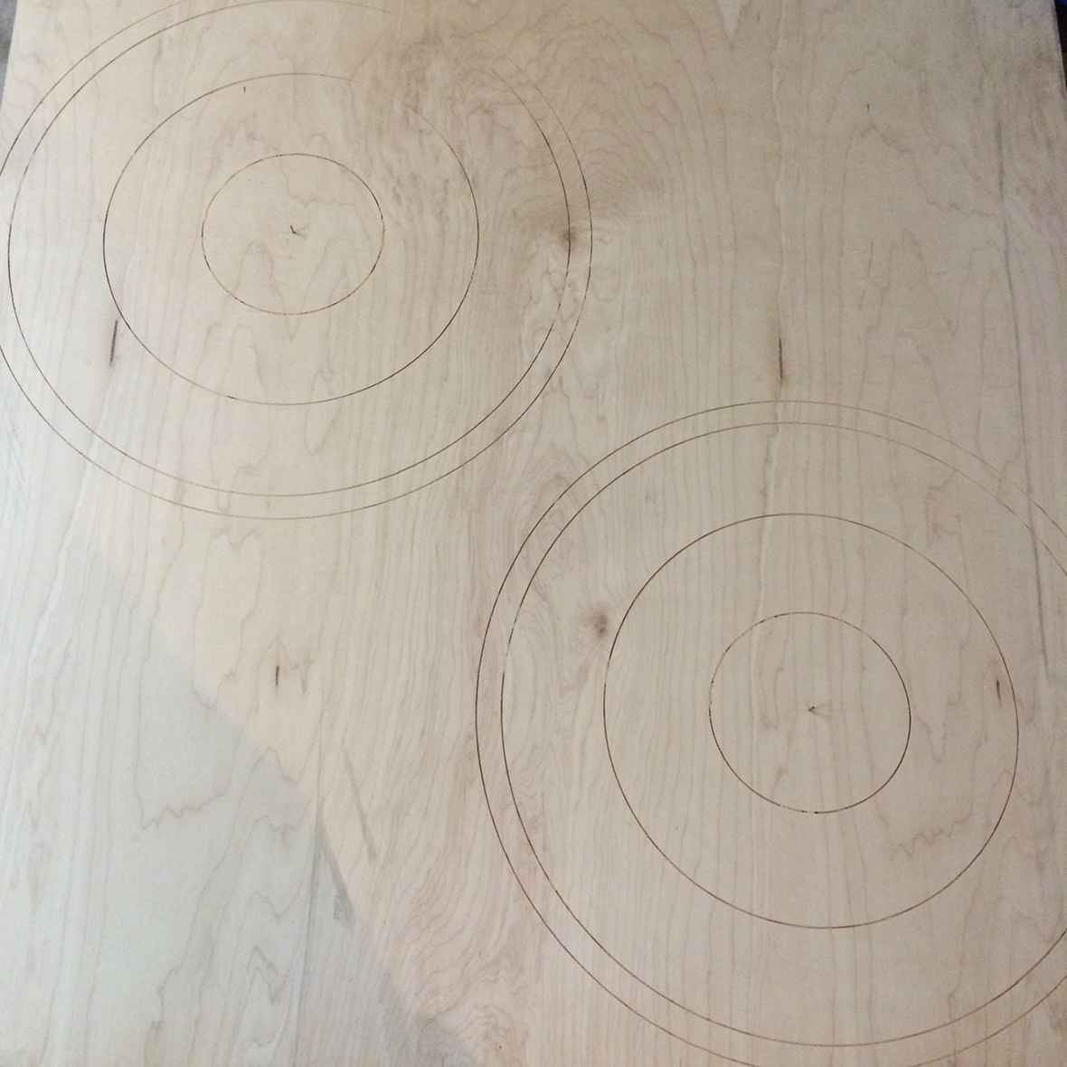

Update:
Bought a sheet of maple ply this weekend, which will get me four boards + ditches. Had a request for a fifth, so will need to go back and buy another, maybe do an oak for change of pace.
I used my Milescraft router circle guide to mark cut lines (13" from center) as well as scoring lines (12", 8" and 4" from center). I routed the lines approximately 1/16" deep (my Skil plunge router accuracy is questionable) and I used the 1/16" carbide straight plunge bit, which gave me some satisfactory lines.
Two of the four boards:
You may notice that the 4" radius scoring line is not in that picture. That is because the Milescraft guide can only be used on 5" radius circles or larger. I certainly would have hit this limitation on my first board, and I obviously came up with some kind of solution, but it was clearly an ugly hack as I neither remember it nor kept it.

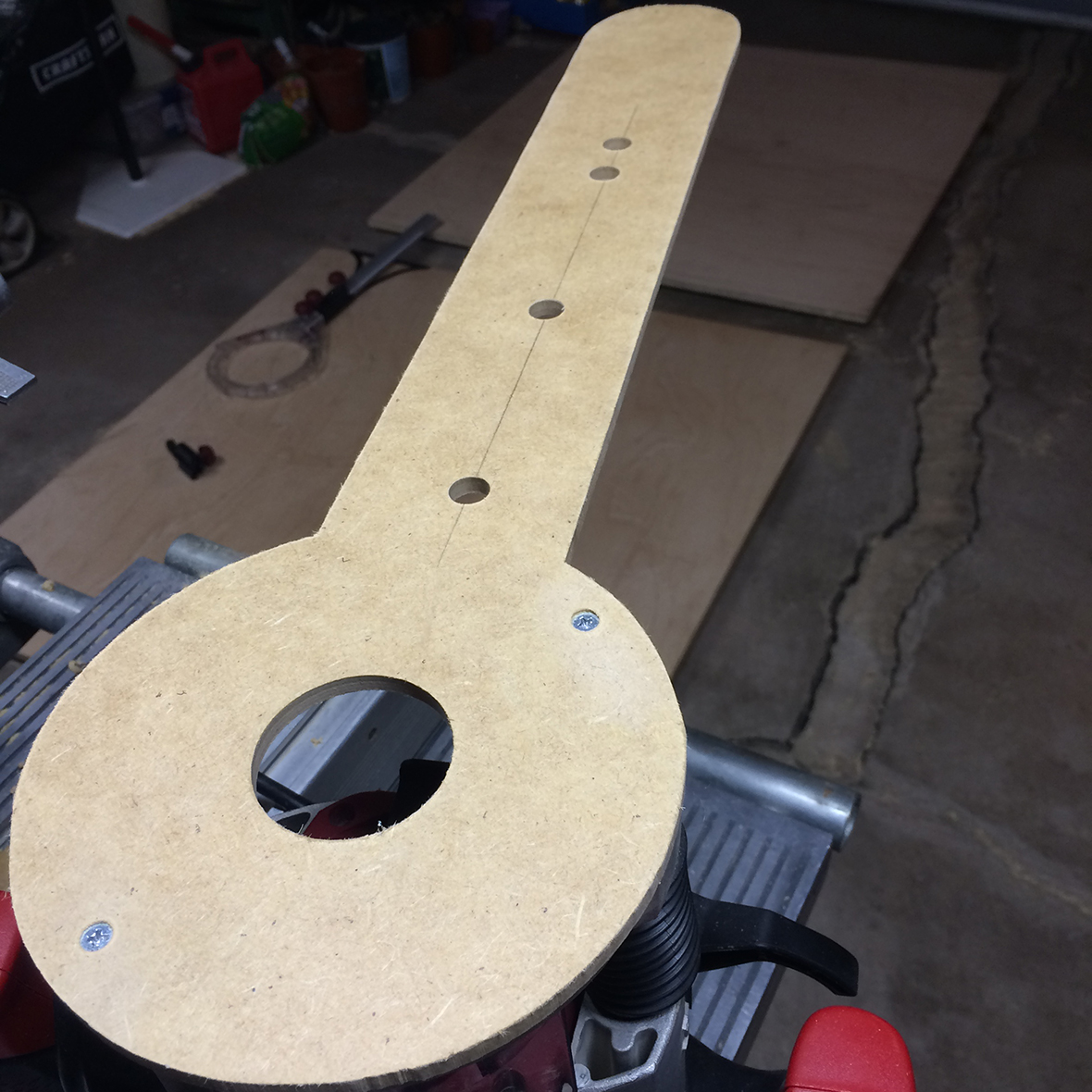

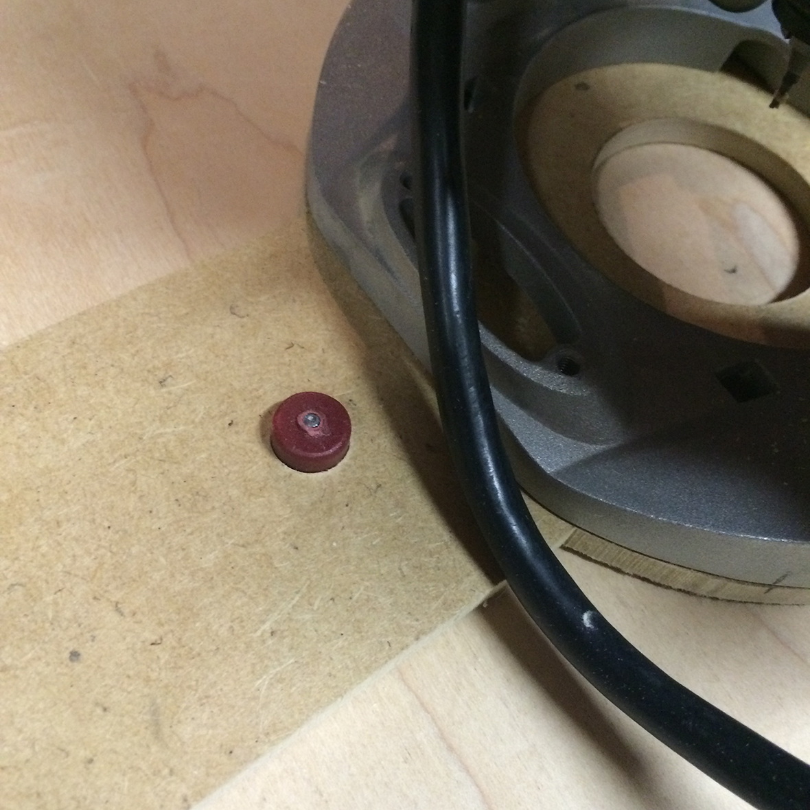

To get around this problem, and to make routing these lines easier in the future, I made my own circle routing jig tonight. I used 1/4" hardboard and made a base to attach to the router, and extended it out with 1/2" holes marked at 4", 8", 12" and 13". The 1/2" holes are made to fit over the 1/2" plastic bushing that the Milescraft guide uses (no sense reinventing the wheel) and the bushing, in turn, is inserted on top of a finish nail.
Happy to report, it worked like a charm, and I was able to get the final scoring circles routed on all four boards.

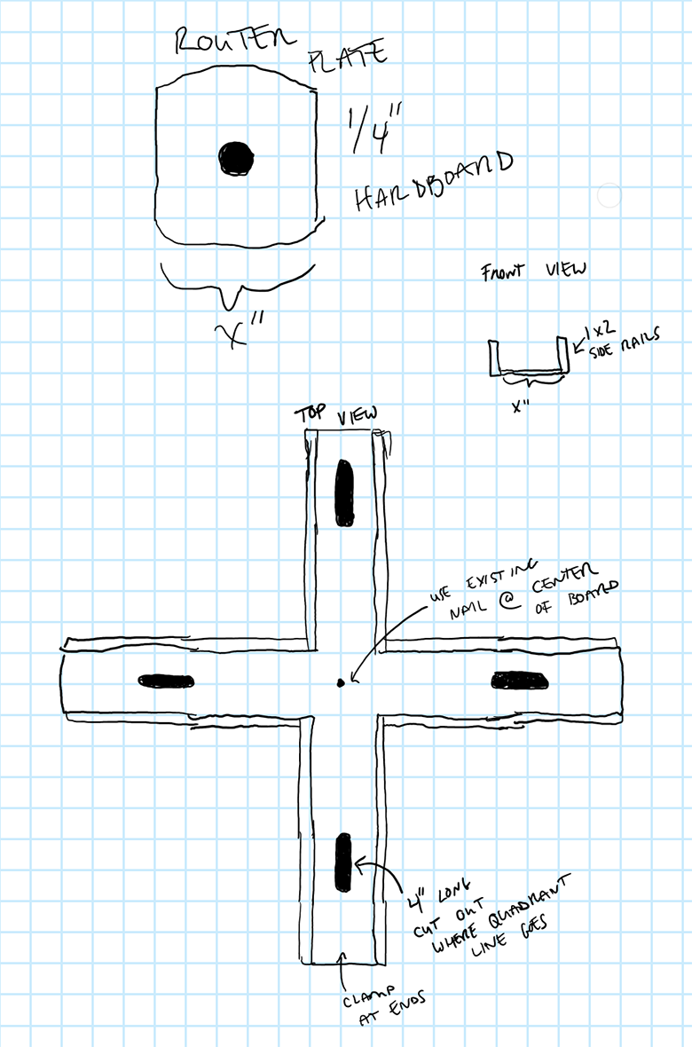

Short version--here is a not-to-scale, quick and dirty drawing of the jig I intend for making the quadrant lines.
The idea is a custom base plate with squared sides that ride in a channel with raised sides. The jig itself is basically a cross, clamped on each end, and centered by using the pin (finish nail) that is already in the center of the board from routing the circles. Holes are cut out in the bottom where the quadrant lines are to be routed. The jig should allow all four lines to be in-line with their opposing sides and perfectly perpendicular to their adjacent sides.
Any comments, criticisms, improvements, suggestions are welcome before I actually build such a contraption.

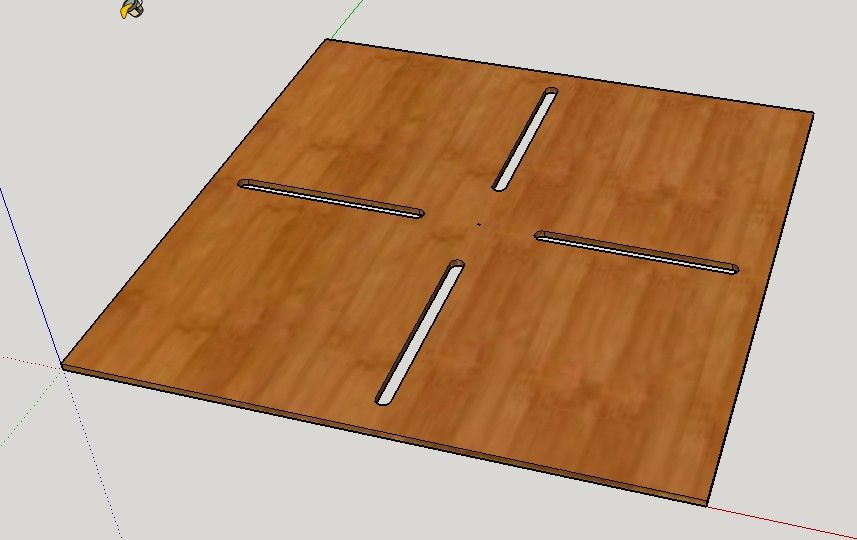

Re: Crokinole Boards - New techniques
It would be easier to just route a template and use a guide bushing to do this. A piece of say 1/4" mdf as a straight edge and another for the template, and a 1/2" router bit to to make cuts the length you want plus the extra length so a guide bushing will result in making your lines the correct length. This is then a template and you put in the correct bit and the 1/2" guide bushing and away you go.
It might look like this:
The template guide bushing will ride in the slot and limits the location and length of the cut.
