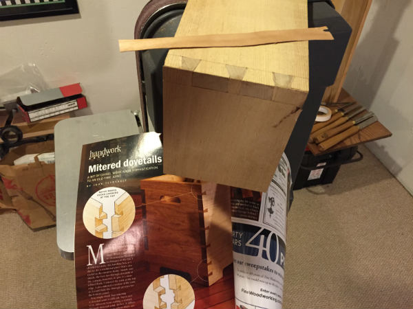

The Sassafras is pretty soft, and I've been wanting to try to some hand-cut dovetail techniques. The board had a split in it, but I thought I'd go ahead and use it. Trying out some mitered through-dovetails, I screwed up one corner pretty bad on sawing. So I just started assembling that one first. I cut some shims up to about 3/32" manually. But other spots needed shims less than 0.020" thick. So I used the Strip Sander to 'wedge down' some already-thin veneer stock. It helped! The end product may not be gift-worthy, more like something I keep to remind myself of mistakes and lessons...

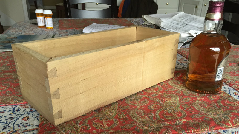

"Medicinals" Dimension checking
Post by nuhobby »
Should this Sassafras-cushioned type of box ever get finished and go to my old friend out East, who knows what could be stowed in it....

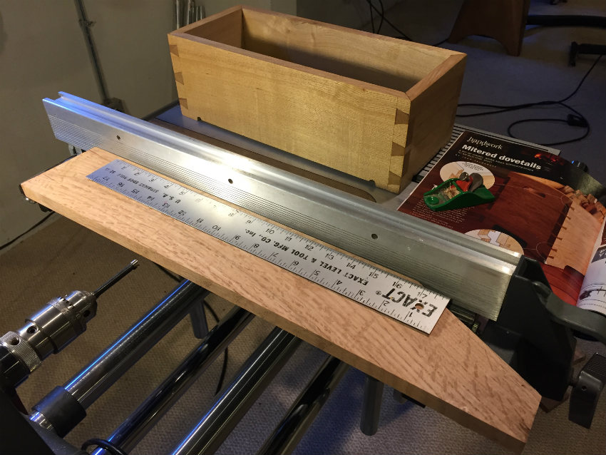

I was contemplating putting this box on a base with exposed moldings at the bottom, but I decided it might look cleaner if I just 'carved out' some corner-legs from the bottom edges of the 4 sides of the box. I didn't want to saw out very much wood (and lift the base level too high), because this box might be used for certain bottles of larger diameter. I decided to Horizontal-Bore some small terminal points, and then used the overarm router to remove material between those 2 small decoration points per side. Here's progress to date:
