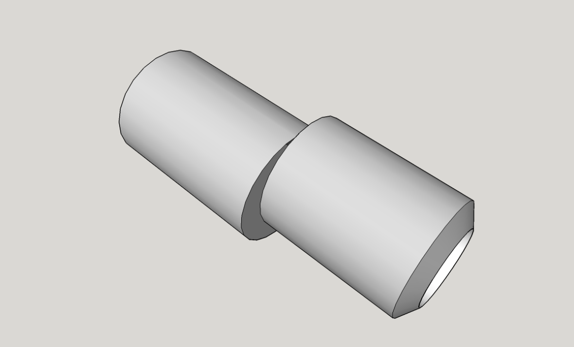

Re: SPT Leg Length
Eccentric_Short (502080)...vs...Eccentric Tubes(555626)
It is easy to see why the wobble issue exists when using Eccentric Tubes (555626).
- Eccentric_Short.png (74.15 KiB) Viewed 1865 times
- Capture Offset Tubes.PNG (49.46 KiB) Viewed 1865 times

Re: SPT Leg Length
Sure can see how and why those from SS would wobble.

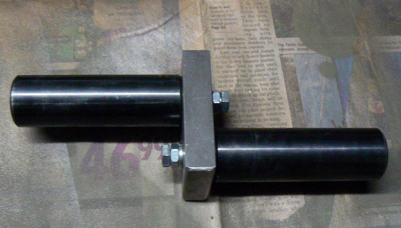

Re: SPT Leg Length
Anti 'wobble' fix.
