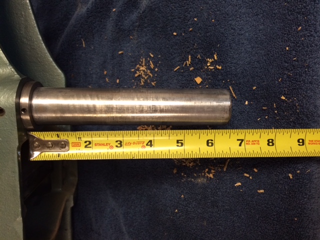

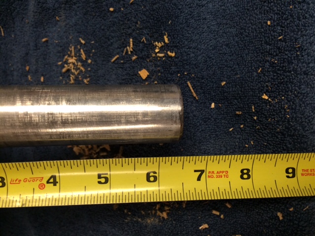

I was looking at some of the recent SPT photos on some of the threads here and was trying to figure out how long the legs were. My band saw and jointer legs are about 6 1/2 inches long; is that the right length?
- IMG_0547.JPG (129.92 KiB) Viewed 1788 times
- IMG_0548.JPG (134.09 KiB) Viewed 1788 times
Jake
Spokane, WA
Spokane, WA

That's interesting because the legs in the photo are from my jointer. How short should they be?JPG wrote:I assume you are referring to the 'external' length.
Now the criteria is the allow secure mounting and height positioning to the shafts.
The jointer 'legs' are quite short(much shorter than 6 1/2"). That reduces the height it must be raised over the mounts to insert them.
6 1/2" seems about right for the bandsaw.
Relying completely on memory here.
Jake
Spokane, WA
Spokane, WA

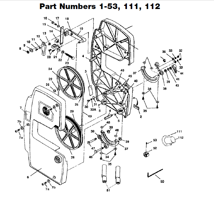

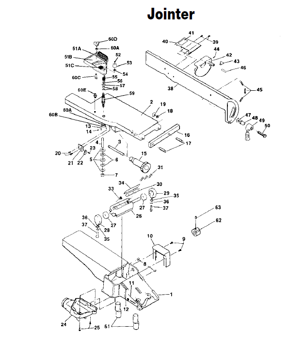

Eccentric Tubes for Band Saw and Jointer Not the same.
Band Saw..5137779...$17.72 ea
Jointer...5020809...$15.02ea

Thank you for the parts breakdown Dusty but what I am really looking for is to know how long the legs should be on the jointer? The band saw leg length makes sense it's just my jointer leg length that I think is a little excessive or do they need to be that long for support just like the band saw legs???
Jake
Spokane, WA
Spokane, WA
ERLover
- Posts: 3914
Re: SPT Leg Length
From the 2 SS jointers I have dealt with those are longer, mine are about 3.5 inches, maybe some one at some time put the wrong ones on it.greasemonkey2275 wrote:Thank you for the parts breakdown Dusty but what I am really looking for is to know how long the legs should be on the jointer? The band saw leg length makes sense it's just my jointer leg length that I think is a little excessive or do they need to be that long for support just like the band saw legs???

It was my intention when I posted the two parts breakdowns to show that the two are not the same length.
The one for the band saw is 6 1/2" long ((total length). The one for the jointer is 3 1/2" long as previously reported).

Re: SPT Leg Length
[/quote]From the 2 SS jointers I have dealt with those are longer, mine are about 3.5 inches, maybe some one at some time put the wrong ones on it.[/quote]
That is what I was looking for! Thank you!!

Re: SPT Leg Length
What do you recommend cutting these down with? A pipe cutter or a metal cutting band saw blade?
Jake
Spokane, WA
