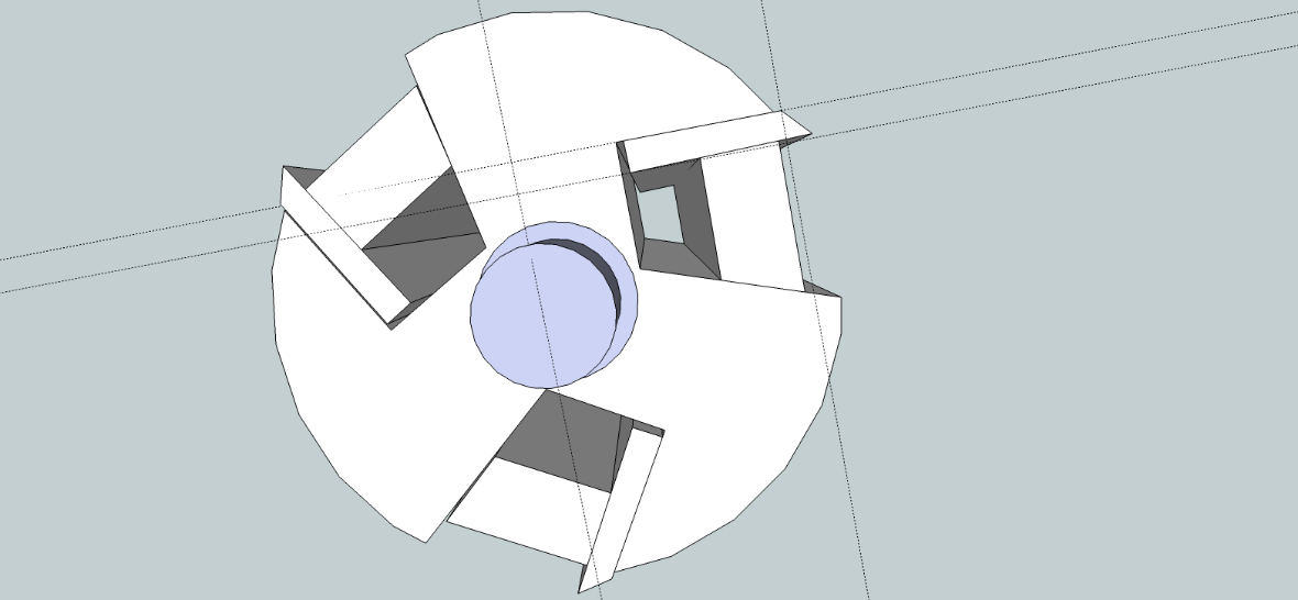

I don't know what you consider the attack angle.
A Cutter Head with blade and wedge.png (74.53 KiB) Viewed 2838 times

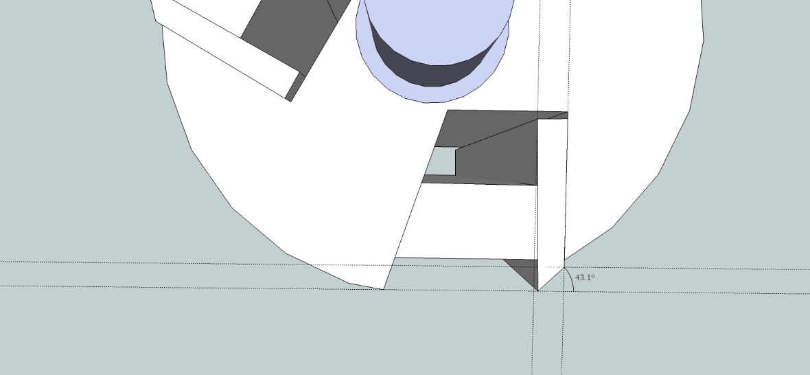

Re: Using the Conical Disk along with the Planer/ Jointer Knife Sharpener
The angle that the leading edge of the blade makes with the workpiece at the point of contact.
90° and you are 'scraping'.
Less than 90° and you are slicing.(like a plane of all things)(bevel down no less).

Is this what you mean? Note that the taper is not "near zero". Actually, it is more like 1.4°. The jig angle upon which the tapered face of the blade rests is at an angle of 43.5° with respect to the worktable surface.
A Cutter Head with blade and wedge angle of attack.png (52.91 KiB) Viewed 2833 times
