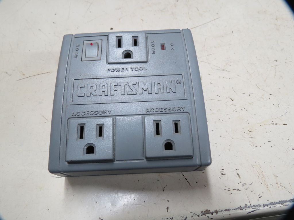

This is the box that I have.
It works for some of the tools I have and the older vacuum but I will not even try it with the shopsmith and vacuum.

I was holding that box in my hand about 24 hours ago in my local Woodcraft store. It sound good and was on sale but since I wanted more information I didn't take it. Amazon reviews were not kind. It looks like a good idea that wasn't carried forward. A sticker says current limit of 9A or was it 10A but either way that is not going to work with either the shopsmith or the 12A shop vacuum.
It does have the other things I was hoping to find but.......

Yeah. I can see why it may not work. The Woodcraft ad says that both circuits are protected by 15amp breakers. It does not say that it can be used under 15amp load. You report 9 or 10amps. That is really some safety margin. Yes, good concept and then it ends there.

reible wrote:This is the box that I have.
I have that exact same box. Been using it with my 520 and a large Ridgid vac for years, no problem, on a 20A dedicated circuit. But there's a couple of things I don't like about it. One, it has a turn-off delay for the accessory (vac), but no turn-on delay. It would be better if it staggered the turn-on. Before I put in the dedicated circuit, it would sometimes pop the breaker on a shared 15A circuit. Two, it doesn't have a switch to turn on the accessories independently. So if I want to simply vacuum the floor or something, my choices are to use the 520 as a "power switch", or else unplug the vac from the box and plug it in to a different receptacle. PITA, that is.
For around 20 bucks, you could use one of those Aux outputs to power the coil of a 20A relay, and use that relay to switch the vac on and off. Powered from an entirely different circuit if you want. For quite a few more bucks, you could use a time-delay relay to stagger the turn-on time. Either way, I'd wire in a switch to start the vac manually. The only reason I haven't done this myself is that it would take time to properly package the relays and stuff.
