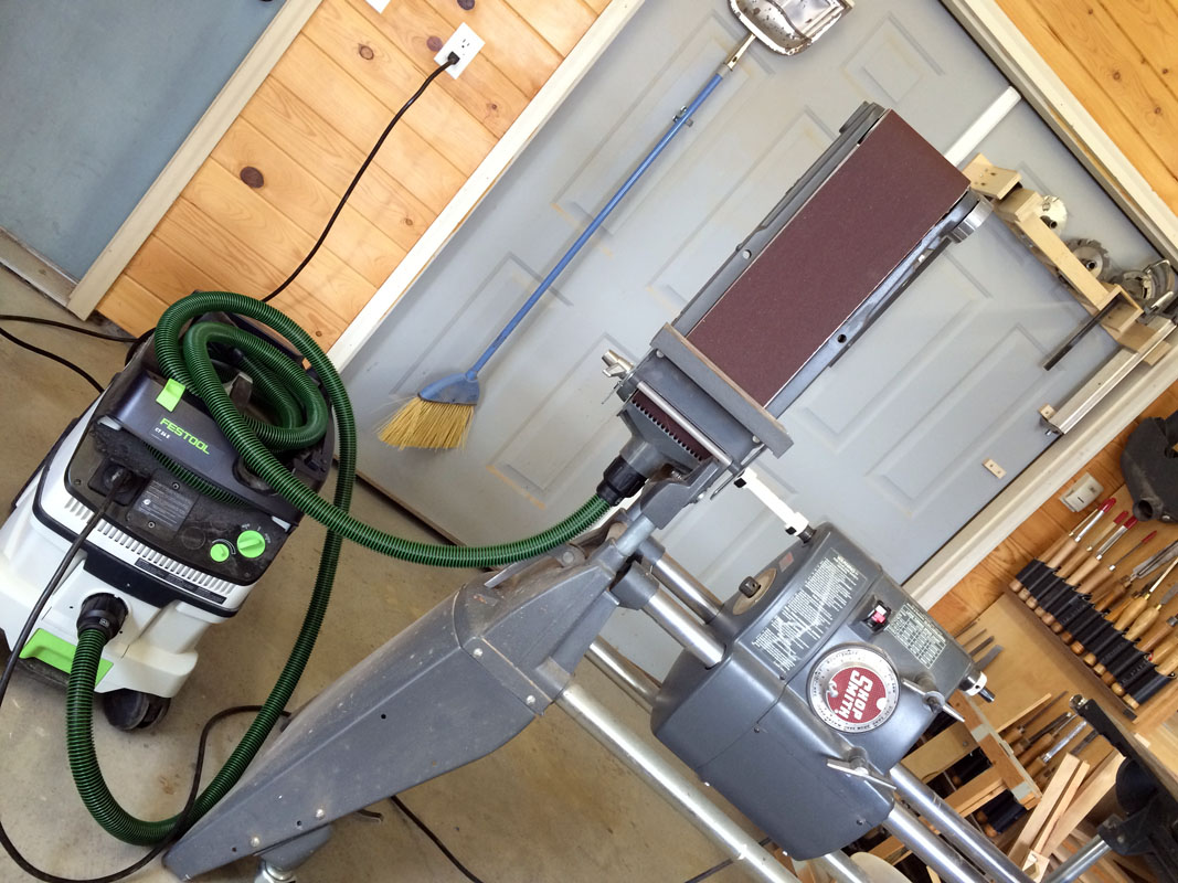

reible wrote:So how are others doing this? Ed
Here's how I do it Ed. The SS plugs into the Festool. The Festool plugs into the wall. Turn on the SS and the vac comes on. And that vac really sucks. They're on sale at Woodcraft now too.
