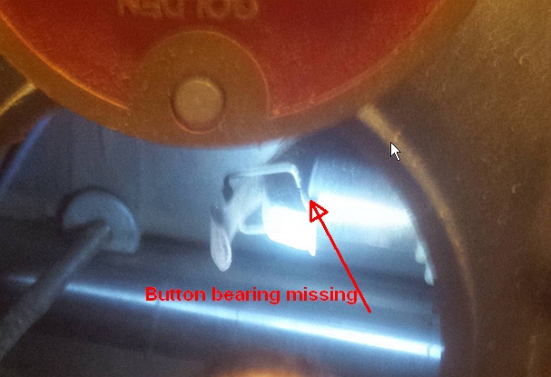

However the first revealed a problem. The button bearing attached to the end of the control sheave hub is 'missing'. Likely resting in the bottom of the motor pan.
missing button bearing.jpg (170.89 KiB) Viewed 1592 times
Cause? Possibly a combination of too rapid adjustment of speed towards fast AND a sticky floating sheave on the motor pulley. Getting the floating sheave well oiled is problematic as the spring gets in the way.
Normally the loop does not pull on the bearing, but if the floating sheave is slow to react, the porkchop can pull it. The purpose of the loop is to prevent the button from rotating. The button on the bearing should also have a small tension pin(may be separated and also in the bottom of the motor pan). The hook ends of the loop fit into the ends of the pin.
Do send the other pix as there may be more to this 'story'.

Taking it off not necessary nor desirable at this point.
The speed control knob and porkchop gear etc. are easily removed. That allows removal of the control sheave.(it simply pulls off the end of the idler shaft).
I understand it all looks bad, but this is a machine that is quite easily restored to running. Keep the faith!!! ;)
