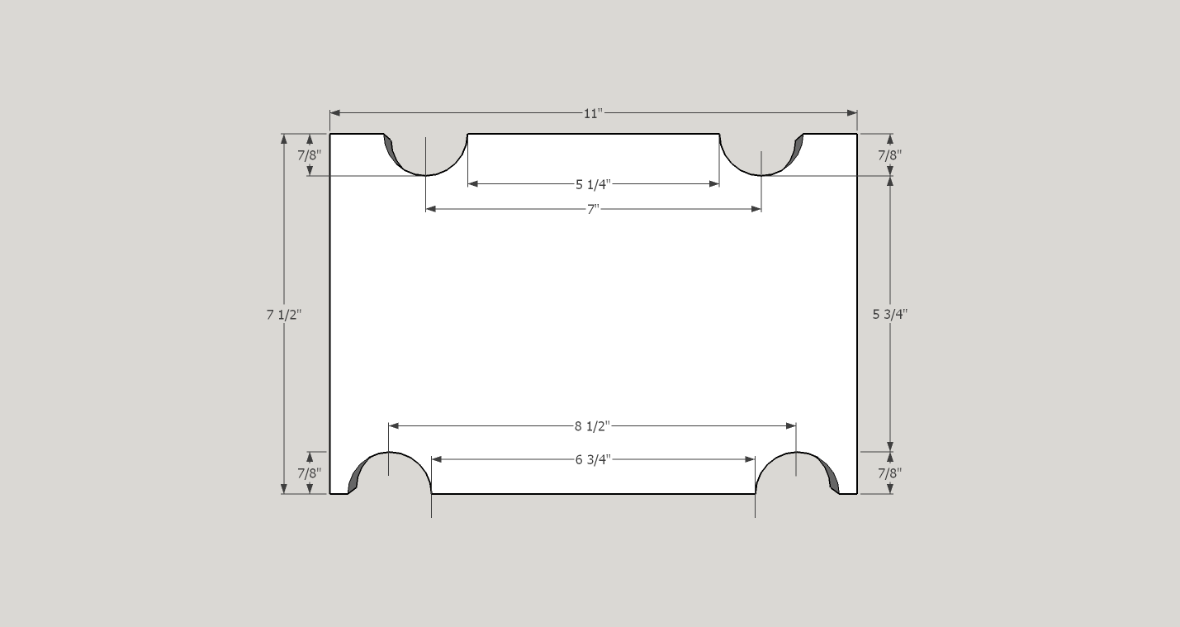

Question for Double Tilt Owners: The Shopsmith documentation for the DT make reference to a drawing in attachment A. Is the attached a reasonable facsimile of that jig.

Re: Preping for the Double Tilt
A couple of dimensions missing.
What is it used for????

JPG wrote:A couple of dimensions missing.
I don't know, JPG. Which dimensions do you believe are missing?

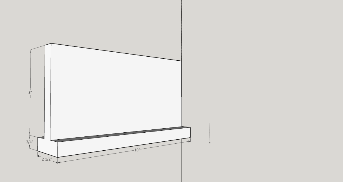

The jig (Attachment A) is used during the Double Tilt upgrade to support the Bench Tubes when the machine is turned up side down and the end castings have been removed. If the new castings did not alter that relationship (between Bench and Way Tubes), the dimension is 5 3/4" as shown in my Sketch.
If I can confirm that the intended dimensions did not change, I am going to build two jigs per the attached Sketch. I will be doing my upgrade in the upright position as others have done. I won't have the required horse power available to flip it over.
Double Tilt Proposed Tube Jig.png (29.32 KiB) Viewed 1565 times
If I have done this correctly, with it in place, I should be able to pull an old end casting and slide the new ones right on with no alignment issue. Since both ends are now made up of two pieces, I may get some surprises.
'Web' thickness and offset from edge.
Sure about the 9 3/8"?(9 1/4?)

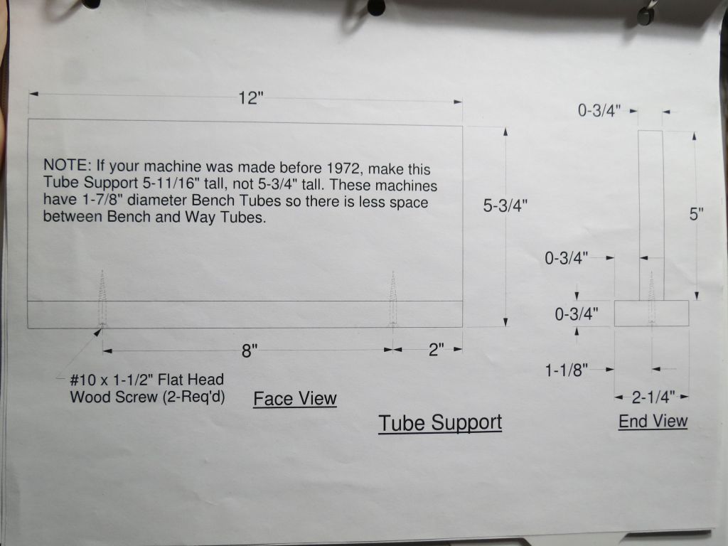

For educational use only.
reible wrote:For educational use only.
Mission Accomplished!
Thanks!
