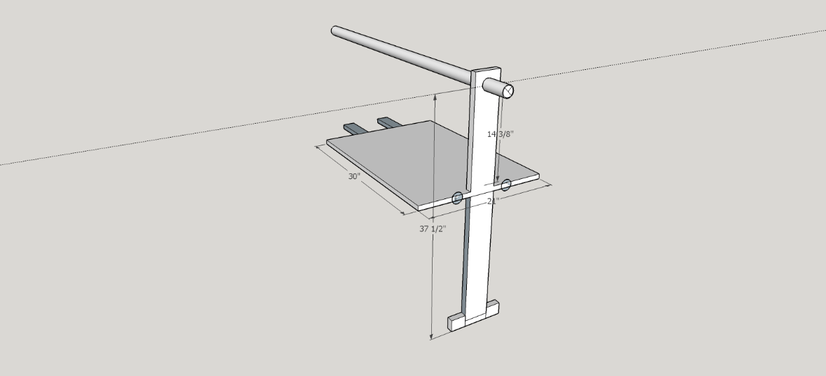

For polishing 52" tubes on a Shorty.
Jig to polish tubes.png (48.36 KiB) Viewed 1846 times
