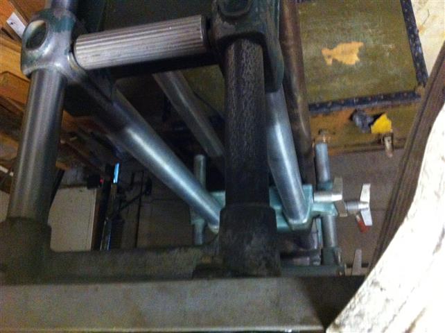

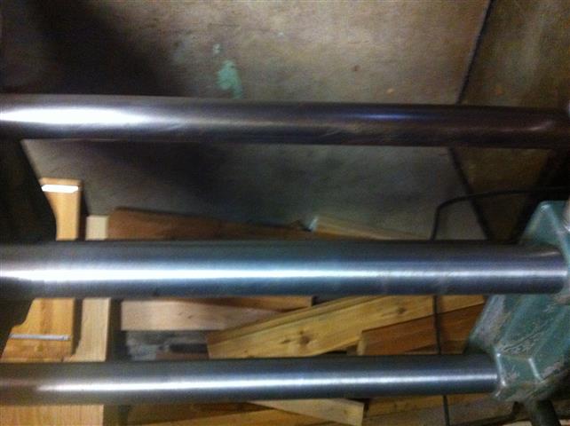

I sanded/polished the bottom tubes until I'm blue but they still have this 'bronze' tinge. Do I just live with it or is this the time for that Orange cleaner?
I'm not concerned about cosmetics. I just don't want the 'cancer' to spread. If wax will keep it at bay I'm good.

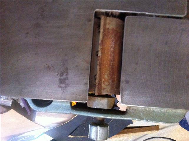

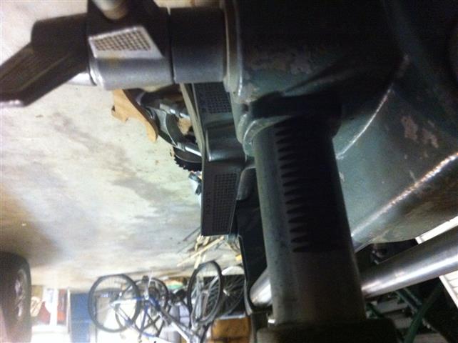

And while I'm at it, here is a piccie of the Jointer, one of the racks and some tubes. How does one de=rust those? I'm not concerned about the visuals. I just want them to arrest the rust.

I do not 'see' the bronze?
The jointer cutter head and blades - use evaporust soak'.(remove bearings and wedges/screws)
The jointer bed looks decent for it's age.
The table tubes, I would use electrolysis. The one extension table looks ok is. The other one, electrolysis.
You stand on your head to take those pix?

Sorry they're all upside down. I can't stand smart phones. I'm old. What can I say.
Anyhoo...
See the first one, the lower tubes are more 'coppery' colour?
If I just keep 'em waxed does that arrest further corrosion? I'm trying to do the absolute minimum, but I don't wanna worry about it breaking.

OK. The bench tubes(lower) are a different alloy than the way tubes.
Hence the color difference. Yes the way tubes are more 'silvery', but they are both steel.
So wax em (often) and move on.
Johnson's paste floor wax(original formula).
