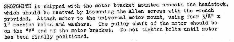

ERLover wrote:Page 6 on the PDF file, page 3 of the E manual discusses the V mounting position. Could not Copy and paste the paragraph.
http://www.vintagemachinery.org/pubs/338/8465.pdf
Nice find!!! That is the 10E preliminary manual that I have an original copy of. Some day I guess I should sit down and completely read all the Model 10 documentation I have.
Interestingly in the "real" 10E manual it just says to mount the motor to the bracket with no mention of orientation.
I also agree that the V allows various motors/motor frames to be used and still have access to the set screw.
10E Motor Mount.JPG (39.82 KiB) Viewed 2278 times
10E manual.JPG (18.15 KiB) Viewed 2278 times

I too subscribe to the set-screw access theory.

I don't see why one want access to the setscrew in that location. If anything I would think you would want it harder to access like on the older shopsmith units with the set screws puddy-ed to prevent someone from getting at them unless they are cleaned out....... top of quill and ring on quill as examples.
If you need to change tension of the belt you could access them and well that is not how you do it.
Any other theory, I'm not buying this one.
Posts: 35599
Re: 10E / 10ER noticed something and now I'm wondering
Agreed! The set screws in the bracket are set and forget. Belt tension adjustment uses the set screws in the headstock end of those posts.
