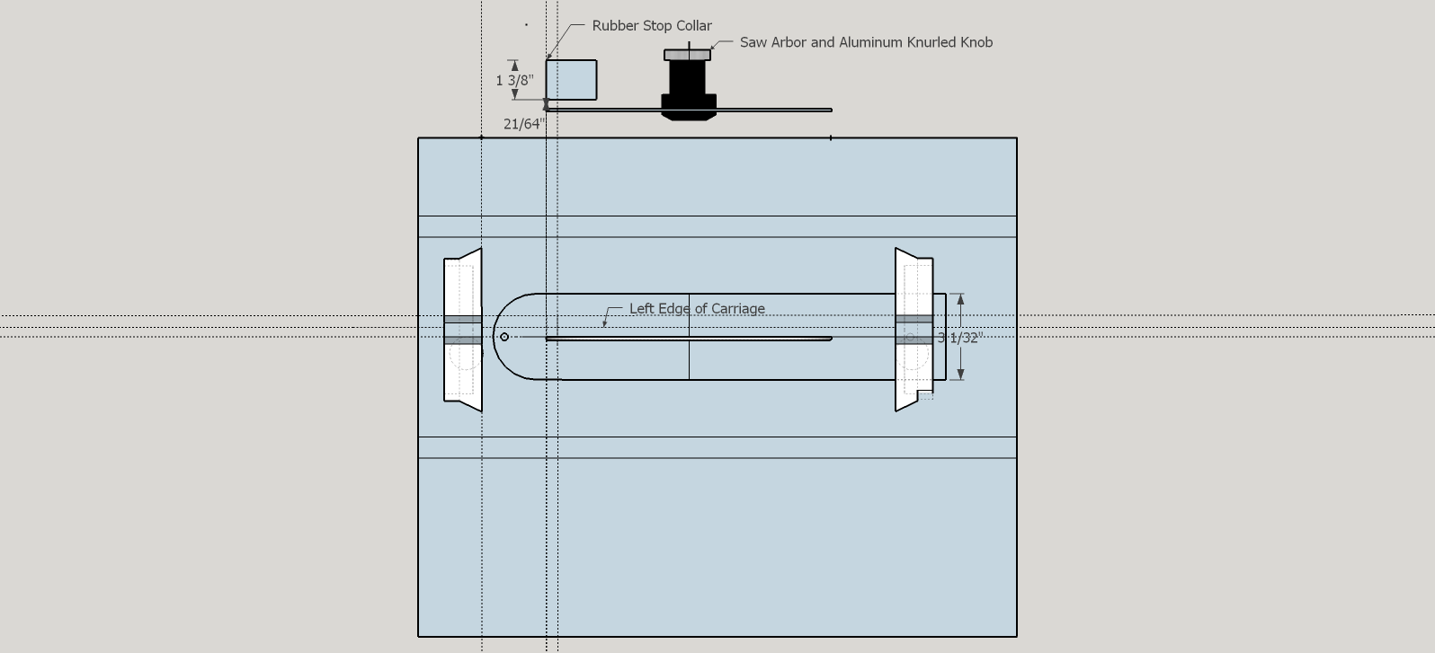

Re: A Whole Lot of Coincidences
The more I work on my Mark V the more I find that this machine was designed to be simplistic while being precise.
