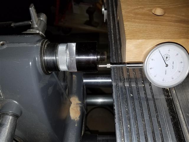

It is advertised to be flat to within .002". So far, I have no reason to doubt that. But before I do any Table Alignment changes, I have a few things I want to check out.
I have attached two new photo images. Please tell me what conclusions I can logically draw from the setup that you see here. The readings hardly change at all when I rotate the shaft.

Re: My Newest Toy

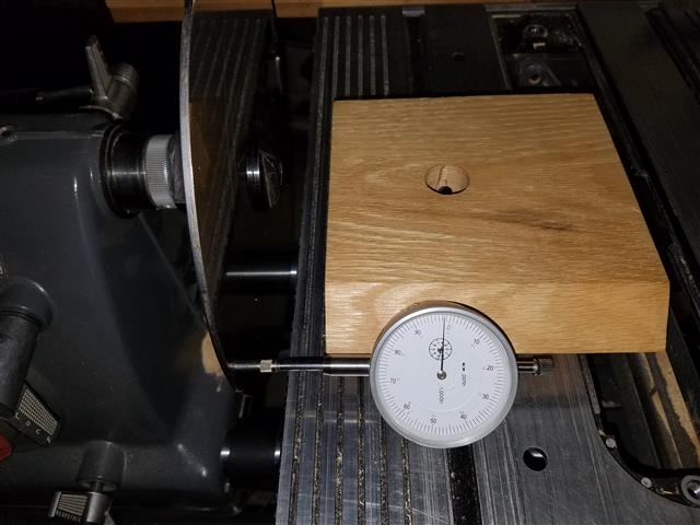

When I mount the plate and take measurements at the edge, the story changes somewhat.
Measuring on the infeed edge of the plate and rotating the disk slowly, the dial indicator changes from -.002" to +.002".
I think this indicates that the plate is introducing most of that change since the arbor measurements are so tight.

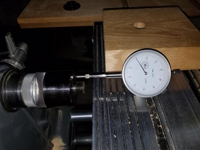

New Measuring Plate 016 (Small).jpg (60.71 KiB) Viewed 8838 times
We are not going to discuss (at this time) what it looks like when I move the dial indicator to the far side of the blade and take a comparative measurement there. Table alignment then comes into question and the readings do not support what I believe table alignment is. Also in question is main drive shaft runout.
This plate may not be darn bit better than the Shopsmith Sanding Disk.

When I measure at the outer edge of the disk on the outfeed side and rotate it the measurements change from 0.0" to .004" (never going in the negative direction). Don't know yet if this means anything. Just recording test results. I did zero the dial indicator when it was reading maximum positive. Maybe if I zero when it is at minimum it will read differently. (This is an example of what I frequently refer to as technique.)
The online catalog states that "This disk is laser cut from the same premium steel plate that we use for our saw blades and is guaranteed to be within .002" flat".

It appears the gauge is contacting the arbor adapter directly above and directly below the center axis of the shaft.
The lack of appreciable difference for either as the shaft is rotated implies the surface being 'tested' is 'normal' to the center axis of rotation.
The minimal difference between the two locations indicates the table top is parallel to the shaft axis.
Re: the flatness of the plate.
To my mind "Within 0.002" is not the same as "± 0.002". The latter is twice the deviation of the former.
Re: The runout at the periphery of the disk.
Rather than the rifle/pistol analogy, stick to simple ratios. If the plate surface is not consistently perpendicular to the axis of rotation, the gauge reading will vary. A reading taken with an identical setup closer to the center will be less by the ratio of the distance from the center. That however assumes the 'deviation' is linear from the center to the periphery. Considering the significant difference in the radius of the arbor adapter and the disc, a miniscule deviation at the arbor will indeed be much greater at the outside edge even if the plate were perfectly(linear) flat.
I assume your goal was to eliminate the need to rotate the reference surface(saw blade tooth/disc) when aligning the table slots to the shaft axis.
IMHO your reading ± 0.002 is adequate for that purpose regardless of the cause of that runout.
This ain't no machine shop tool Dusty. ;)
Re: My Newest Toy
JPG wrote:Re: The initial question(etc.) and pix.
Re: The arbor adapter.
I know so very well that this ain't no machine shop. I can tell by the "sawdust".
You would be wise not to assume anything about "my goals". This is simply another one of my "toys".
This toy has the potential to become a key tool in my arsenal of alignment tools but at the moment it is not.
I could have/should have done a better job of selecting the images to post. Those first two images are with the dial indicator at 3 and 9. Same difference with regard to your comments however.
I appreciate the feedback.
