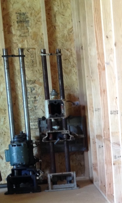

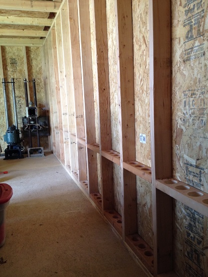

The photo shows where I will be storing those way and bench tubes between wall studs after tear-down and after they are restored as I work to perform other services, such as media blasting as I prepare to paint. That’s a whole new project on its own as I restore and upgrade my Econoline blast cabinet, which, like other things are being shifted around.
The point is, what you do, or what you may have to do depends entirely on the conditions of the systems you are working on.
Storage for Tubes in Queue.JPG (95.4 KiB) Viewed 9415 times
Rusted 10ER out of Houston.JPG (87.62 KiB) Viewed 9412 times
