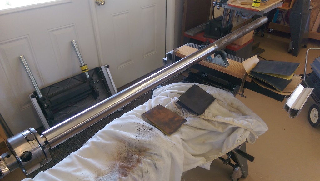

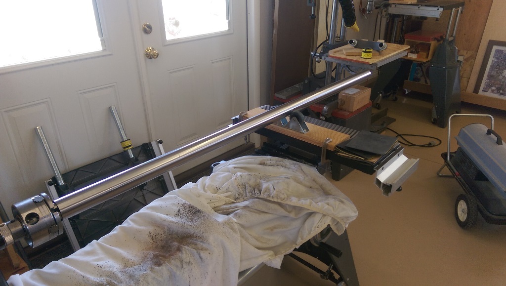

Most of what you want to do should be fine. As for the way/bench tubes there are a couple of things. The SS 1 1/2" drum sanding mandrel will fit the tubes. If you have one you don't need to buy a freeze plug. Use the drill chuck in horizontal mode. You will have to support the right end of the tube since the tubes extend past the end of the SS you are spinning them on. See the attached pictures. I didn't use the drum sanding mandrel since I have a lathe chuck but the principal is the same. I would start with 320 grit, then 400 grit, then 600 grit and then finish with 0000 steel wool. Clean with mineral spirits and wax with Johnson's. If you use WD-40 or such the wax will not stick.
The castor rods can be chucked directly in the drill chuck. Due to their length and diameter you will probably have to support the right end. I would use a block of wood 1"X1" and drill a shallow hole in the end to fit the castor rod. Then support it in the tail stock with a live center.
As long as you don't get carried away with the 320 grit paper you won't remove enough material to make a difference.
- IMAG0096.jpg (193.82 KiB) Viewed 14222 times
- IMAG0097.jpg (185.27 KiB) Viewed 14222 times

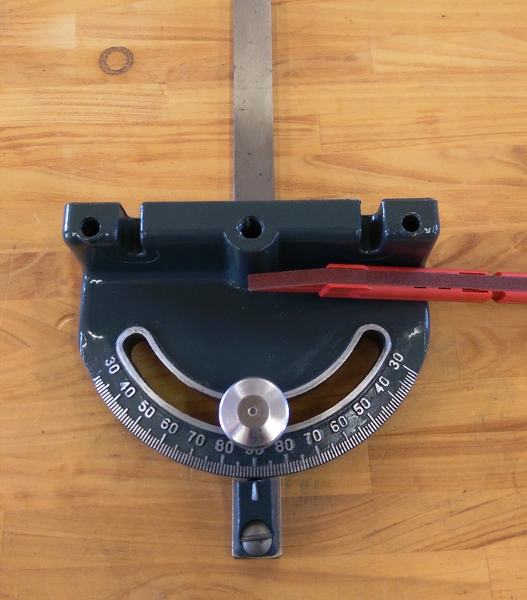

1. The indented numbers I don't know. Raised numbers with a painted background I have done. I paint the entire item and use detail sanders from Woodpeckers to remove the paint from the top of the letters. It really does not take that long to remove the paint.Phil72 wrote:I will start that soon. I only have three more questions then:
1. Is there any way to repaint the little red numbers on the tilt control, miter gauge, and fence, the letters and words on the speed control, or the "waffle" patterned red area on the Shopsmith logo on the front and back of the headstock without very tediously masking all around the little letters?
2. If the wax will not stick if I use WD-40, how am I supposed to clean off the top layer of penetrol as it was suggested in the linked thread in BuckeyeDennis' response?
3. Would the paint for the tubes alter the color a lot? I'm used to seeing Shopsmiths whose upper and lower tubes are the same color, and I like the way that looks. Is there any benefit other than rust protection to painting? How much advantage against rust does painting vs regular wax give?
2. Don't use Penitrol. In my opinion Jhonson's Paste Wax (JPW) is the only thing necessary and has been recommended and sold with the SS almost since day one. As I said, I use mineral sprites to thoroughly clean the tubes before waxing. I do use a bit of WD-40 with the 320 grit paper if the tubes are badly rusted. After that I clean with mineral sprites and go on to 400 grit +++. Then a final clean with mineral sprites and wax with JPW. I am not sure why JPG says he doesn't use mineral sprites for final cleaning but he will chime in with the answer.
3. Remember, only the early MK 5 bench tubes were painted. Those were the ones that were 1 7/8" as opposed to the 1 3/4" tubes. Don't paint them if you don't want to. Treat them the same as the way tubes. I think paint will alter the color.
- IMAG0511.jpg (213.27 KiB) Viewed 14189 times
