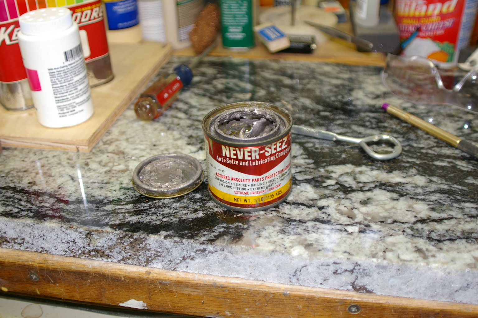

Tip: Back to the topic. Like the screws that hold the table insert for instance, I have found through the years on my old,"Goldie", any fastener made of steel and screwed into SS cast aluminum will most certainly try to "Seez" over time. I think I posted this some where before but I use "Never-seize" on the fastener and haven't had a problem since. I have a 1/2 pint can that I have had since 1952 when it disappeared from a Army machine shop.
Also use it on all the allen screws steel on steel
Don G
Don G

Always a good idea. Tough to get off the fingers though!dgreen810 wrote:Tip: Back to the topic. Like the screws that hold the table insert for instance, I have found through the years on my old,"Goldie", any fastener made of steel and screwed into SS cast aluminum will most certainly try to "Seez" over time. I think I posted this some where before but I use "Never-seize" on the fastener and haven't had a problem since. I have a 1/2 pint can that I have had since 1952 when it disappeared from a Army machine shop.

Fingers arent bad, now clothes are an other story!!ChrisNeilan wrote:Always a good idea. Tough to get off the fingers though!dgreen810 wrote:Tip: Back to the topic. Like the screws that hold the table insert for instance, I have found through the years on my old,"Goldie", any fastener made of steel and screwed into SS cast aluminum will most certainly try to "Seez" over time. I think I posted this some where before but I use "Never-seize" on the fastener and haven't had a problem since. I have a 1/2 pint can that I have had since 1952 when it disappeared from a Army machine shop.
Don G
Re: Joiner Cutter Head Washers
Lacquer Thinner!!
