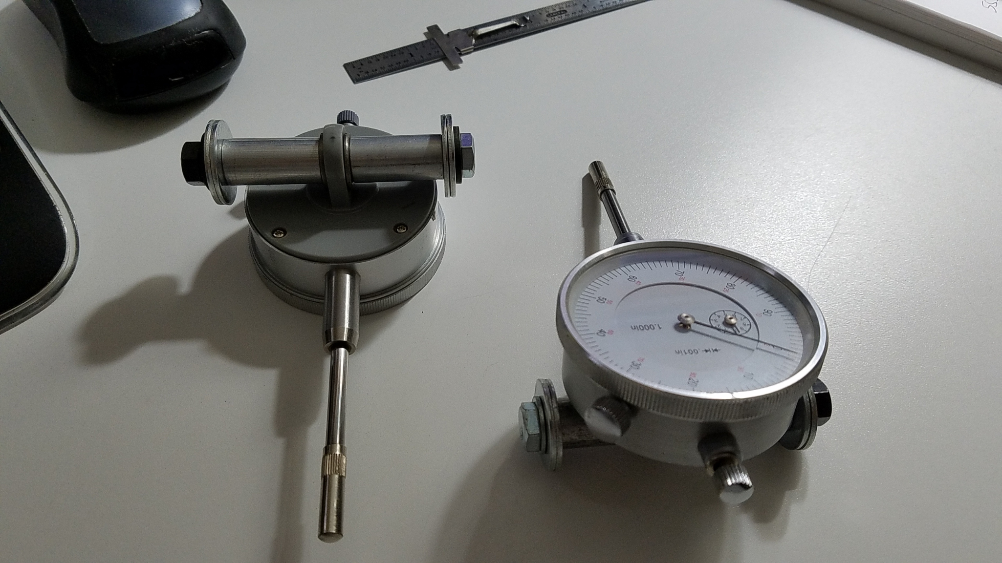

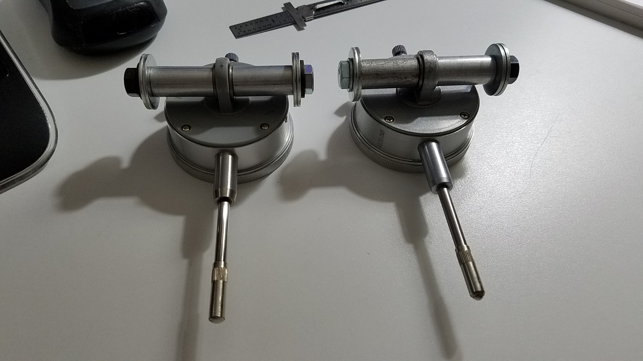

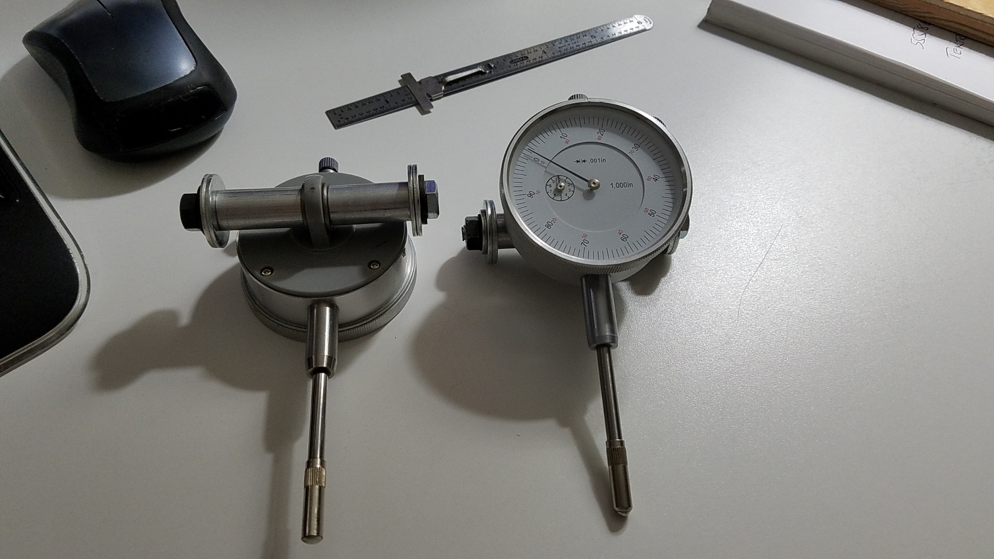

The hardware selection has been slightly altered to get the proper ID on the washers and the bolts have been replaced to get the correct length. Other than hat, these have not changed from the previous posts. I now have a matching pair of dial indicators.

They are not Rockler nor are they Woodpecker but they work.

dusty wrote:The hardware selection has been slightly altered to get the proper ID on the washers and the bolts have been replaced to get the correct length. Other than hat, these have not changed from the previous posts. I now have a matching pair of dial indicators.
What prevents the dial indicator from rotating on its axis, and thus changing its measurement, as the jig is moved along the miter slot to take readings from the front and back of the blade?
I am sorry but I do not understand the question. If you are talking about the stem rotating there is nothing that prevents that but rotating the stem does not alter the reading. The reading changes only as a result of the stem moving in or out.
