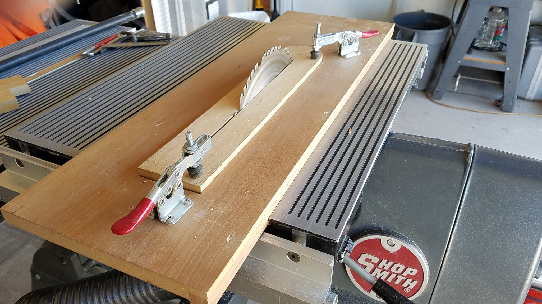

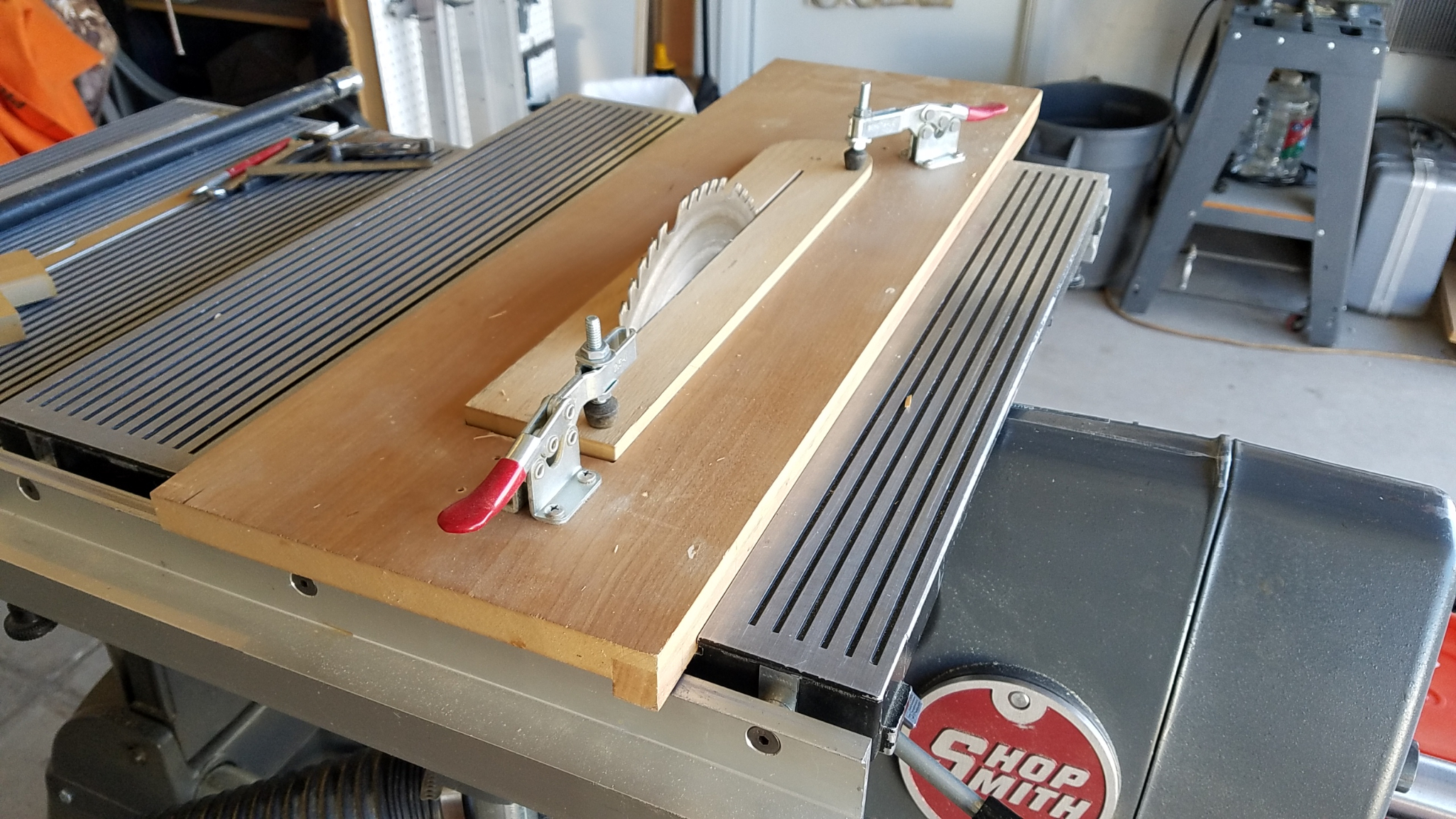

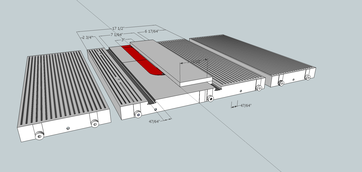

algale wrote:Yes, thanks Dusty, I see. I like the idea a lot.
I may make something similar, only with a tight fitting miter bar of its own. A properly sized plywood board would be screwed/glued to the miter bar and extend over the table and half way across the table insert.
If you browse through the forum posts that discuss table alignment, you will find something like what you are proposing.

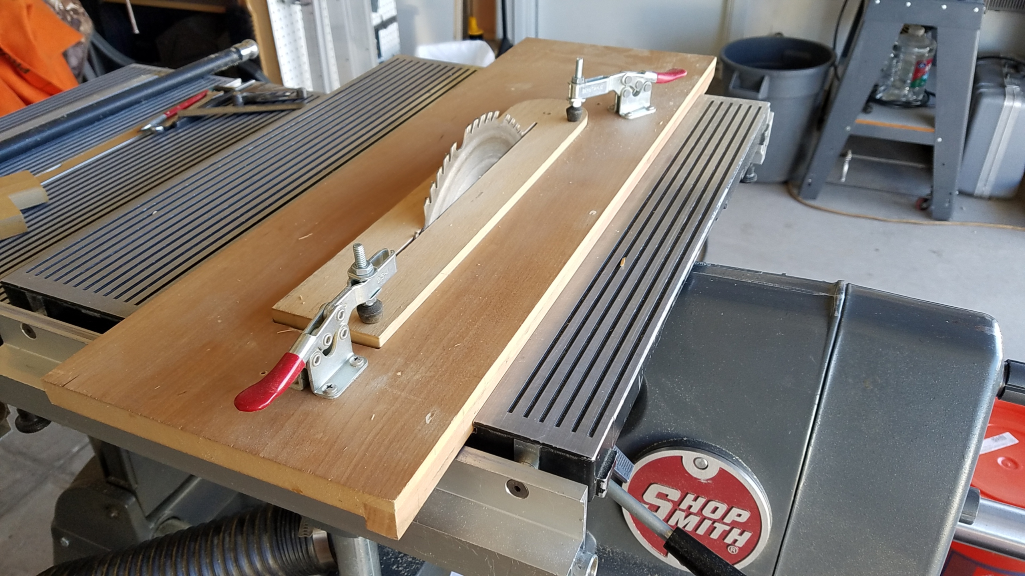

That's what I was thinking of and it may be because you had previously posted it! Why did you go with the current version in the photo (no miter bar) vs the one in the illustration?

algale wrote:That's what I was thinking of and it may be because you had previously posted it! Why did you go with the current version in the photo (no miter bar) vs the one in the illustration?
That is a hard question. Hard because I have been there before and did not carry through. I don't know why. I do like the idea of being able to check the relationship of the miter tracks to the blade. BUT That flies in the face of why this jig at all. The primary purpose (for me) has been to minimize the effort required to align the table while at the same time being very certain that the table was properly and accurately aligned.
If you do anything with your idea, think about a jig using both miter tracks. Sort of like the jig I have been using to make ZCI.

I think I already have a jig that may be adapted to this purpose. My scarfing jig (made to scarf gunwales on the Slow Boat). Basically it is a tight fitting miter bar with a deck and an angled fence on top. The fence on top is irrelevant to this purpose. I usually don't pay much attention to centering the blade, so as is it probably isn't centered. But if I turn the jig around, the deck may be wide enough to recut. What I would do is align the table with the blade centered using the normal (for me) method of a dial indicator but paying attention to centering. Then I would run the jig through the blade. That would the trimmed deck would then be the future reference surface for alignments.
Re: Table Alignment, Using Dual Dial Indicators
algale wrote:I think I already have a jig that may be adapted to this purpose. My scarfing jig (made to scarf gunwales on the Slow Boat). Basically it is a tight fitting miter bar with a deck and an angled fence on top. The fence on top is irrelevant to this purpose. I usually don't pay much attention to centering the blade, so as is it probably isn't centered. But if I turn the jig around, the deck may be wide enough to recut. What I would do is align the table with the blade centered using the normal (for me) method of a dial indicator but paying attention to centering. Then I would run the jig through the blade. That would the trimmed deck would then be the future reference surface for alignments.
Yup. You are on the way to a new jig.
