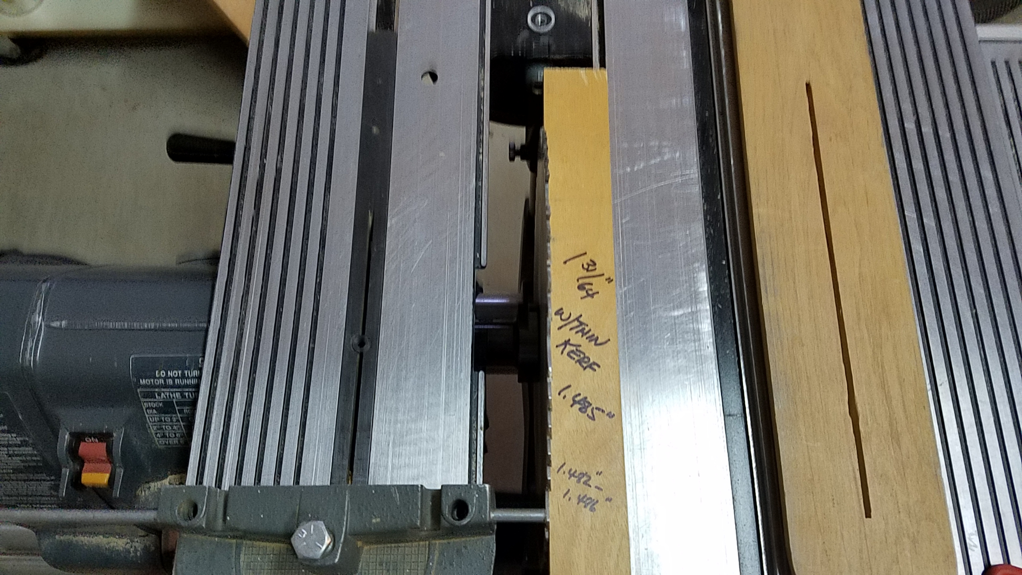

With the headstock and carriage pushed together to meet the rubber bumper, I secured all of the locks. With all of the trunnion bolts loose and the quill fully retracted and the standard table insert removed, I installed a new home made setup block to the left of the blade in place of the normal table insert.
This setup block measures 11 1/2"x 1 31/64". The length is not critical while the width was calculated so as to "center" the blade in the cutout. It was cut carefully to ensure that the long sides are parallel.
The main table was then moved into position so that the setup block was positioned between the table cutout and the blade. Theoretically, this centers the blade and positions it so that the miter tracks are parallel to the blade.
The two trunnion bolts that are accessible were secured, making certain not to allow the main table to shift.
The table is now properly aligned (and if done correctly needs no further alignment). Secure the other two trunnion bolts and the task is complete.

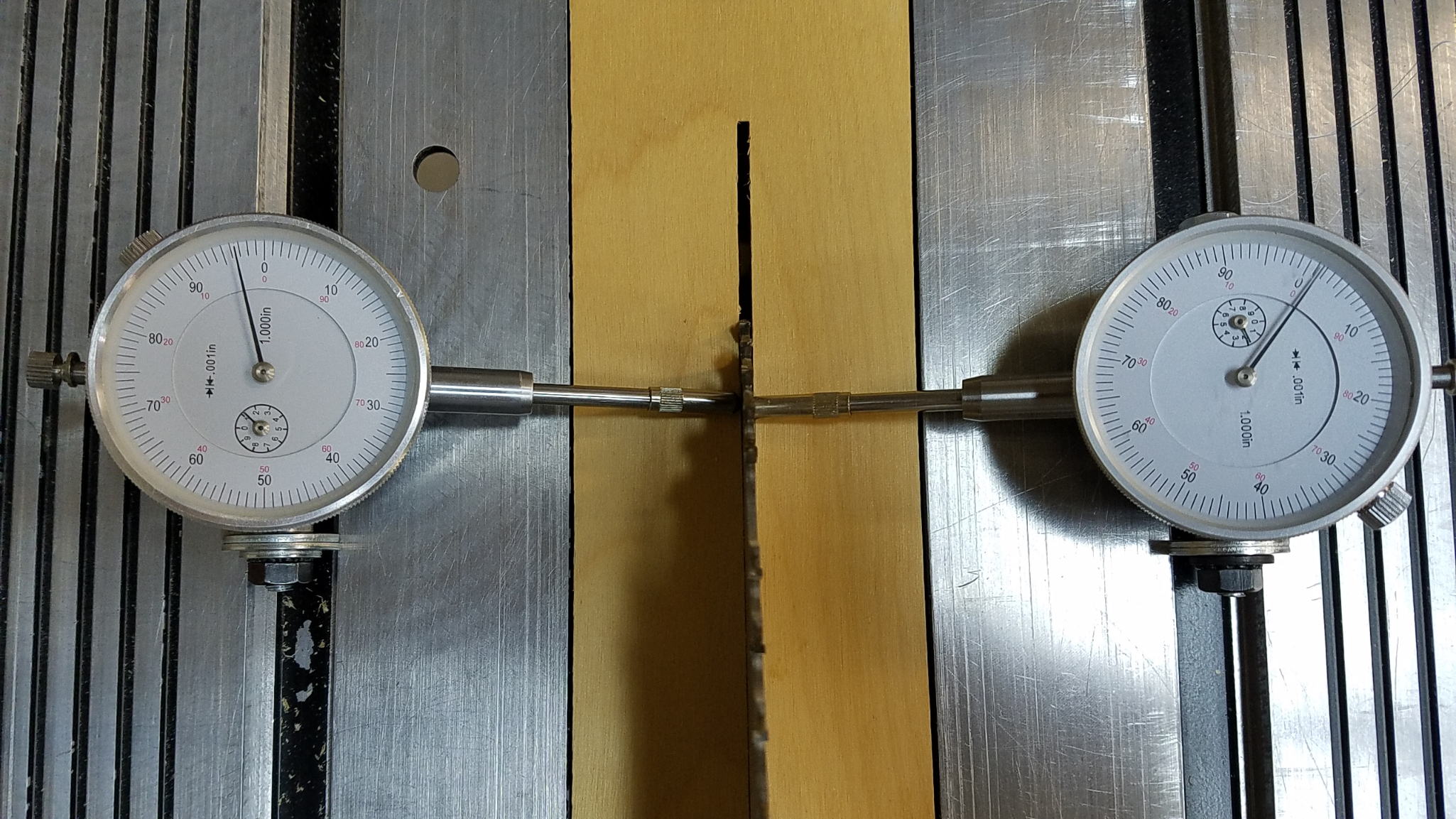

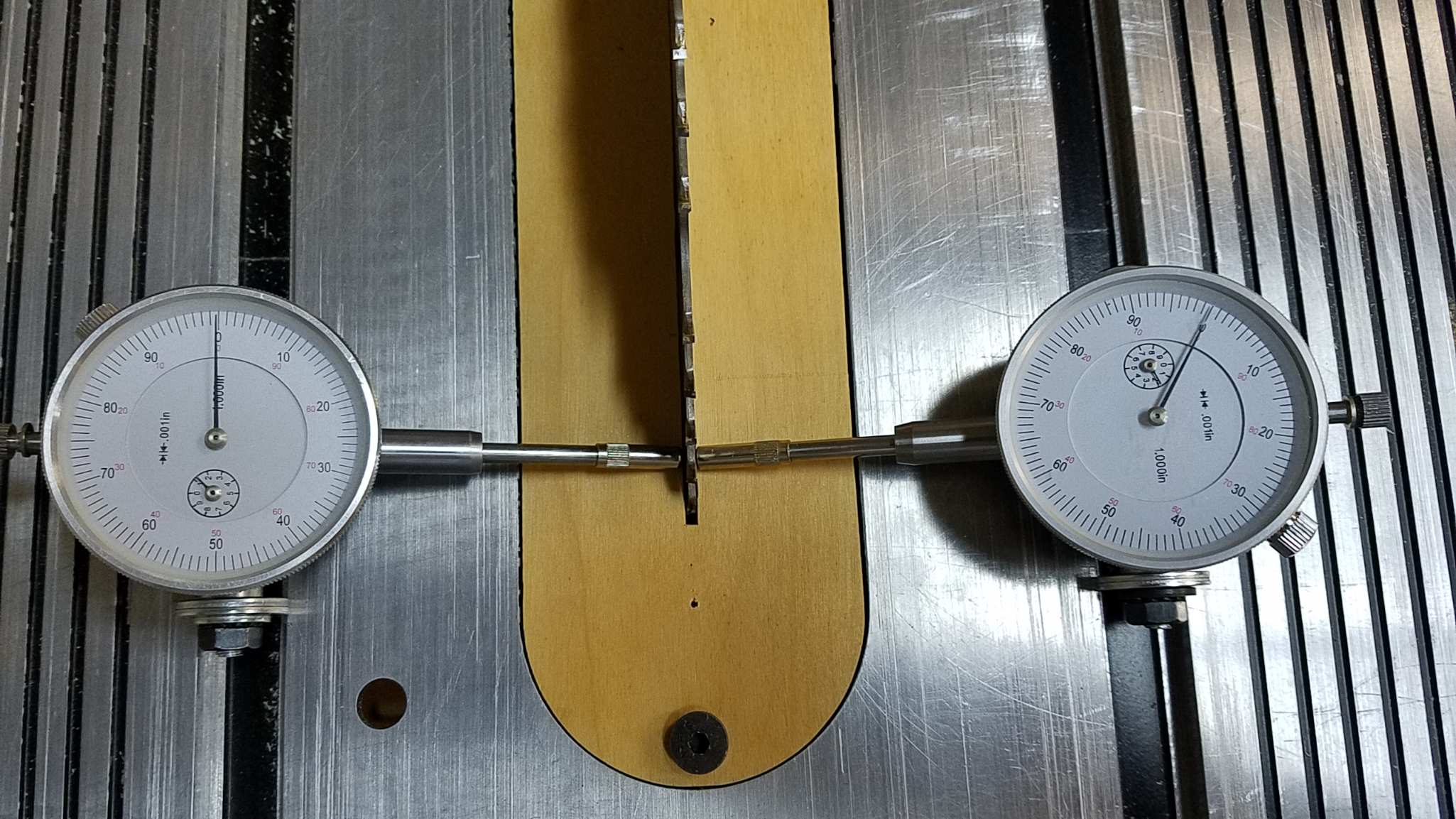

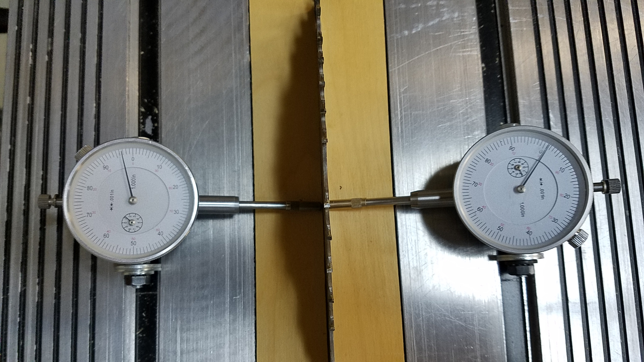

To satisfy myself that this was successful, I used two dial indicators to check 1) infeed edge of blade, 2) center of blade and three outfeed edge of blade. The dial indicators were zeroed together as shown at the infeed edge of the blade.
1 Opposing Gauges Zeroed.jpg (1.88 MiB) Viewed 11122 times
2 Centered on Blade.jpg (1.7 MiB) Viewed 11122 times
3 Outfeed Side.jpg (2.08 MiB) Viewed 11122 times
The dial indications, I believe, indicate a successful alignment. However, as I compare the numbers on the two dial indicators at each of the three locations, I cannot explain the variations. This is the first time I observed dual indicators and they confuse me a bit.
I did rotate the blade to three other locations and took similar readings. This was done to satisfy myself that the two-tooth method previously used was not necessary and could be abandoned as part of table alignment. The saw blade is from Shopsmith and is relatively new so I am confident that it is as flat as any Shopsmith saw blade will be.

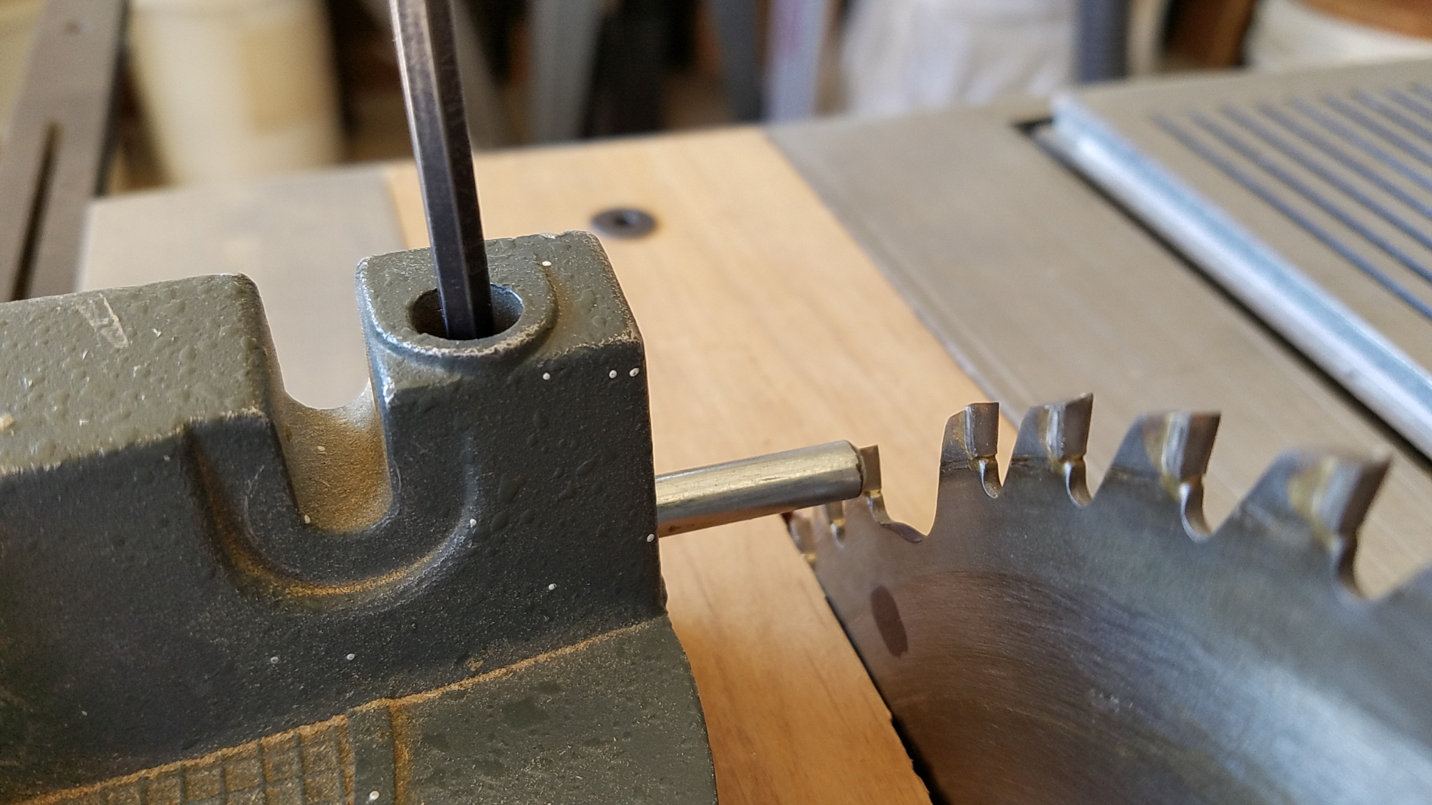

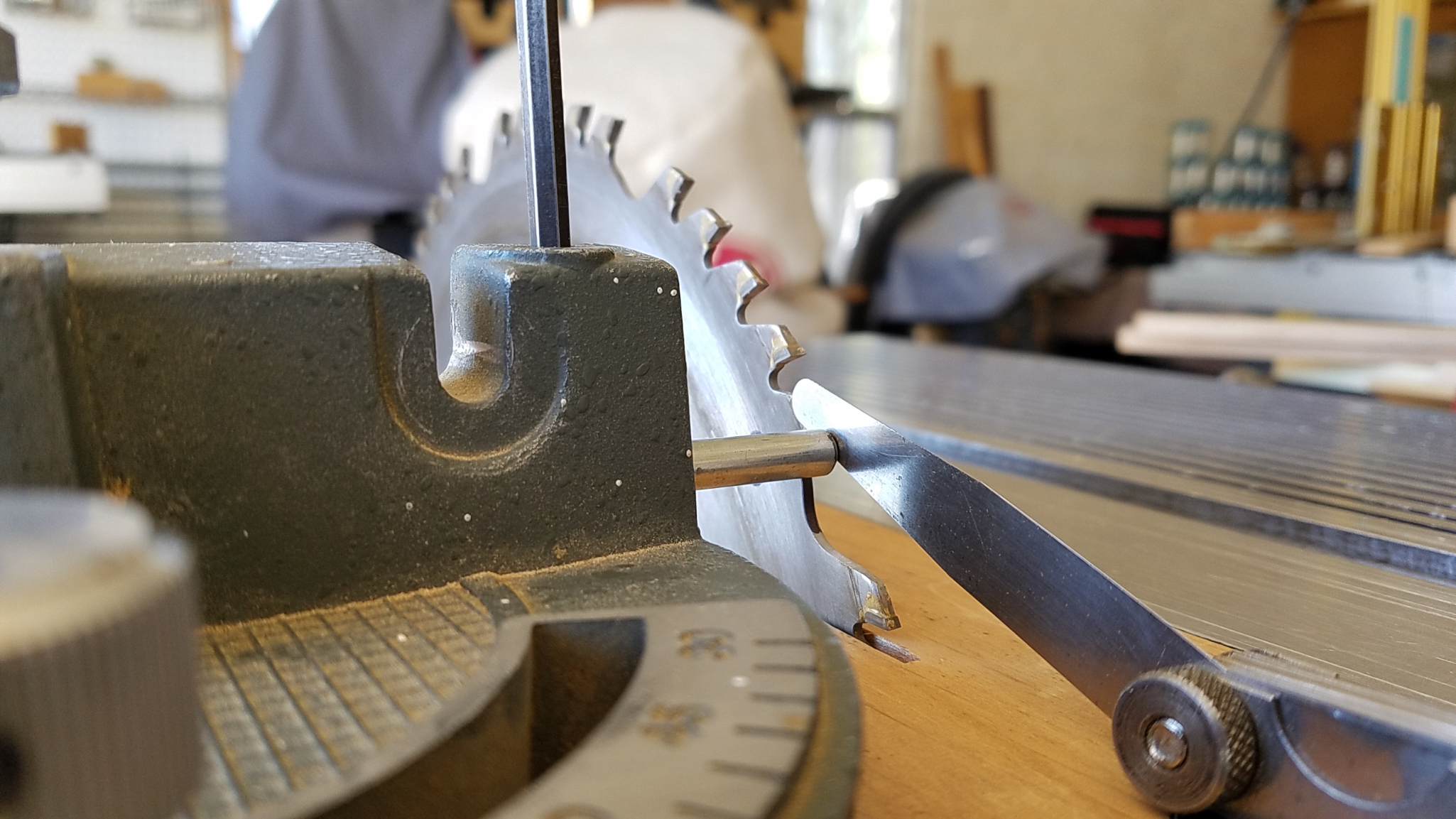

I always aim to please (though that does not always happen). Using the left hand miter track, shopsmith miter gauge and stop rod:
The tooth was closest at the outfeed side. I adjusted the stop rod so as to touch that tooth and locked it in place. Rotated the blade to bring that tooth to the infeed side and relocated the miter gauge and stop rod. I was able to feel a .005 feeler gauge but could not pass it past the tooth. Using .004" feeler, the feeler sides through with some slight drag. I would call it at .004".
Stop Rod and Feeler Gauge 003.jpg (1.74 MiB) Viewed 11086 times
Stop Rod and Feeler Gauge 005.jpg (1.76 MiB) Viewed 11086 times

I will attach a picture later to help explain. In the meantime, I simply removed the ZCI, unlocked the quill feed, located the setup block between the blade and the table cutout and secured the quill feed with the setup block trapped in between. This was done with the trunnion bolts loose. This allows the table to position itself against the setup block. Theory being that the table is now the correctly positioned and centered in the cutout.

Picture attached. Not a well composed picture but I think it answers your question. If not - just say so.
Using a Setup Block 002.jpg (1.79 MiB) Viewed 11065 times
