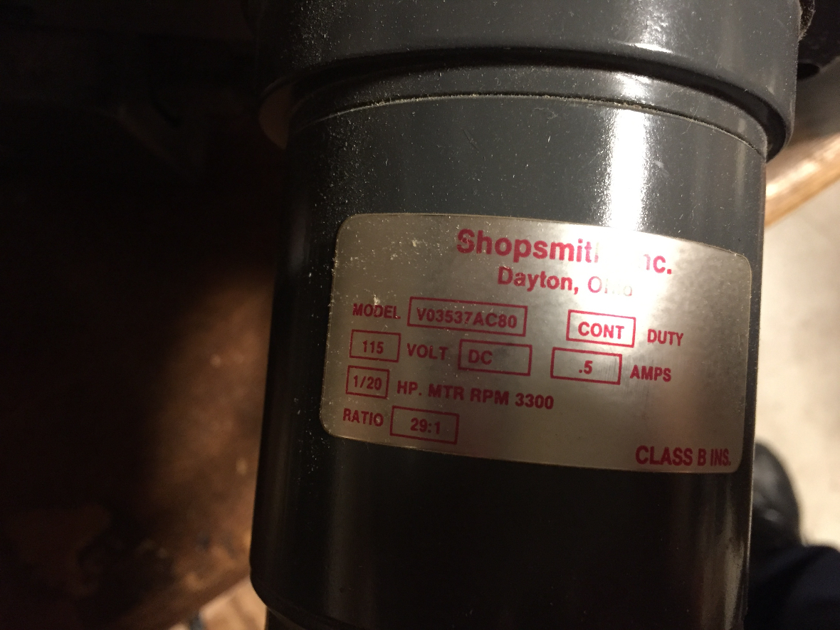

I am glad you posted that pix.
It reminded me that voltage/current is an insufficient criteria.
1/20 HP at 3300RPM is important and applies to the voltage/current specified.

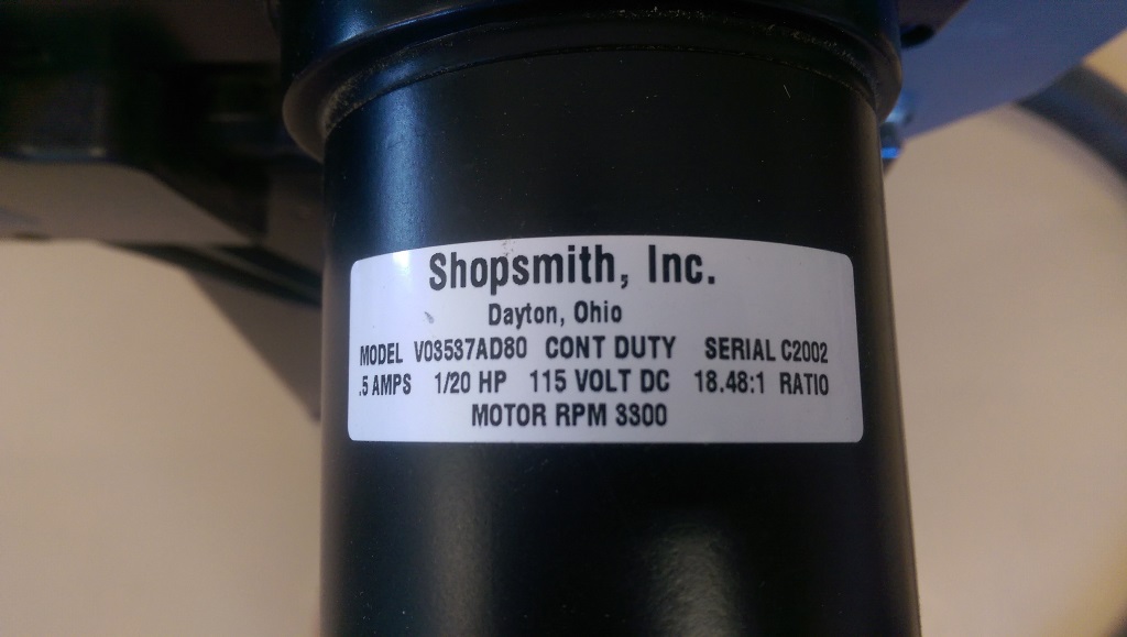

Re: SHOP SMITH PLANER FEED MOTOR
Well that seems to be par for the course. Three reports and three apparently different labels.
Note that the Model Numbers are different.
- Feed Motor 002.jpg (896.7 KiB) Viewed 6294 times
