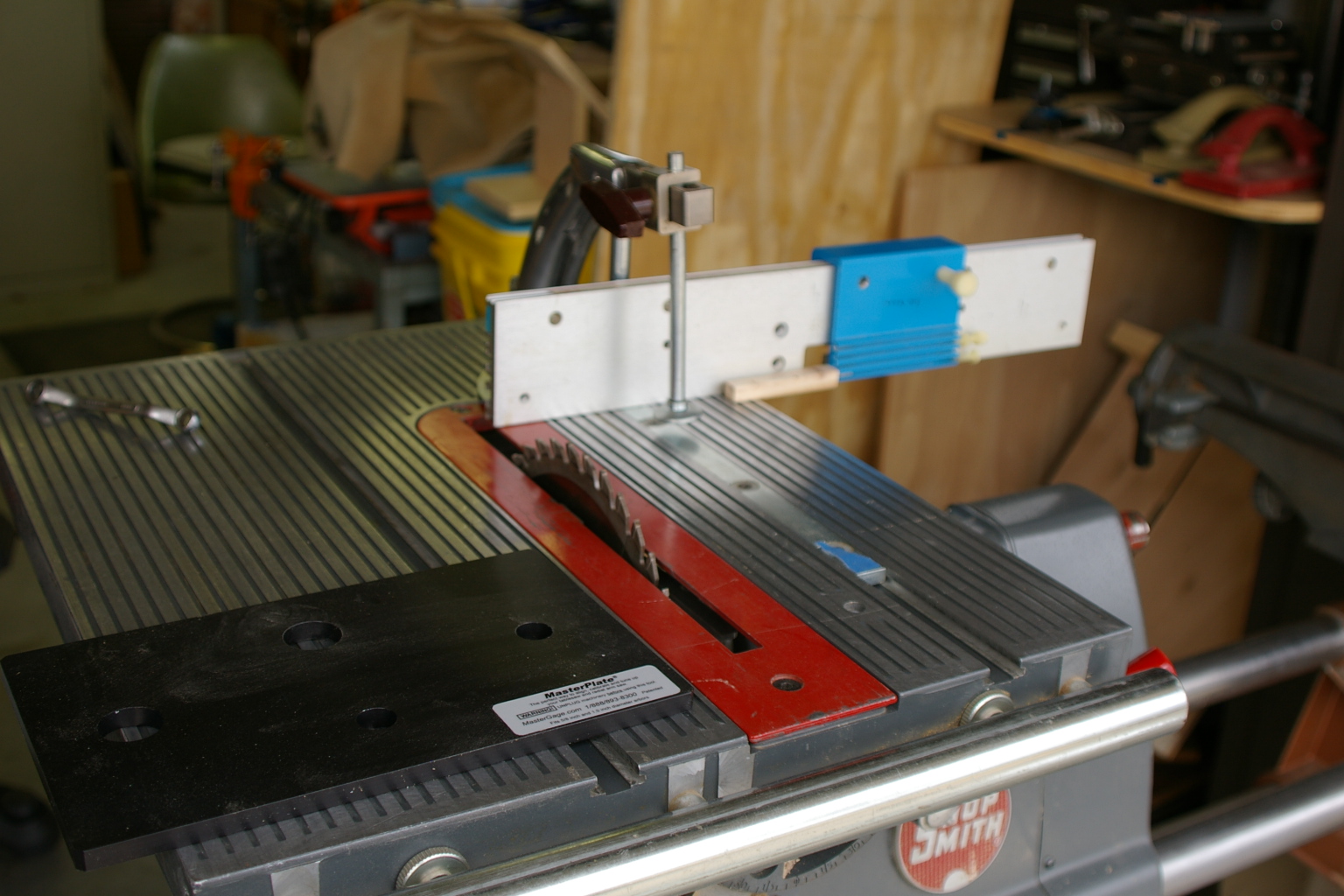

Thanks for all the replies. A few answers.

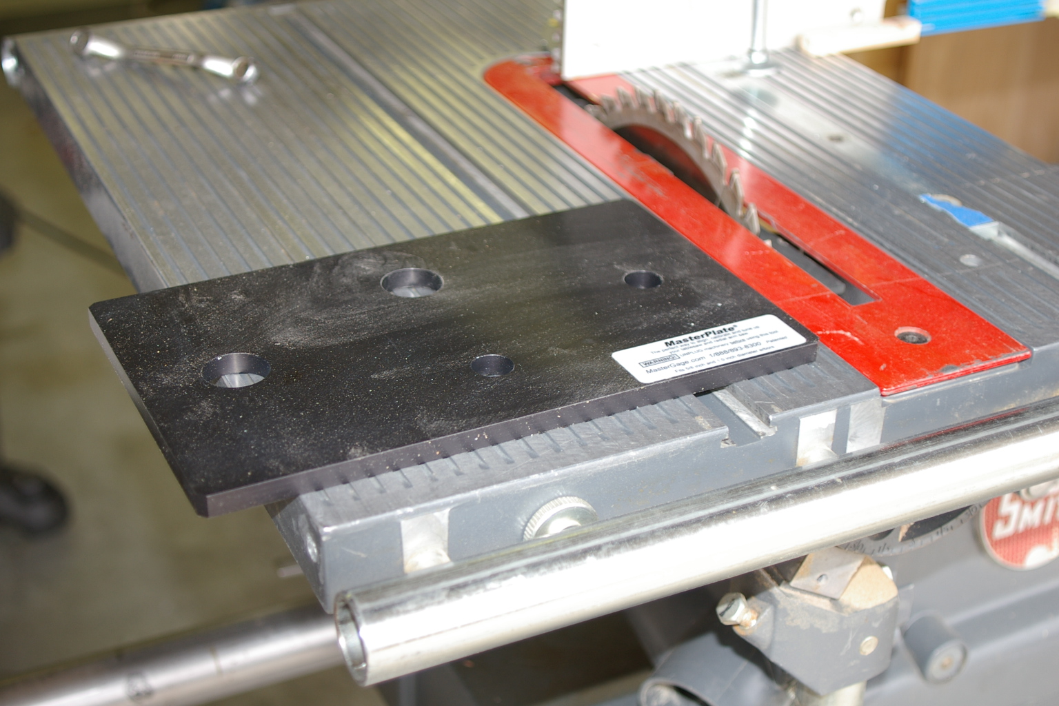

The sled has two runners. The miter slots are square to the sanding disc and is square to a Master Plate.
I took JPG's advice and removed the work piece after making the cut instead of retrieving it back through the blade and the cuts improved noticeable.
I am confident the sled is square to the blade but but somehow the work piece is creeping slightly. In the past I simply used the Incra Miter incorporating the fence from an original Incra Jig and got good results and finishing the cut using the disc sander as was offered as a suggestion.
I just thought by making a sled, it would be accurate and eliminate a step or two. (I tend to be somewhat lazy sometimes).
I did modify the old Incra Jig stop block somewhat as shown in the attached photo
Thanks again for all the suggestions.
Don G
Don G
