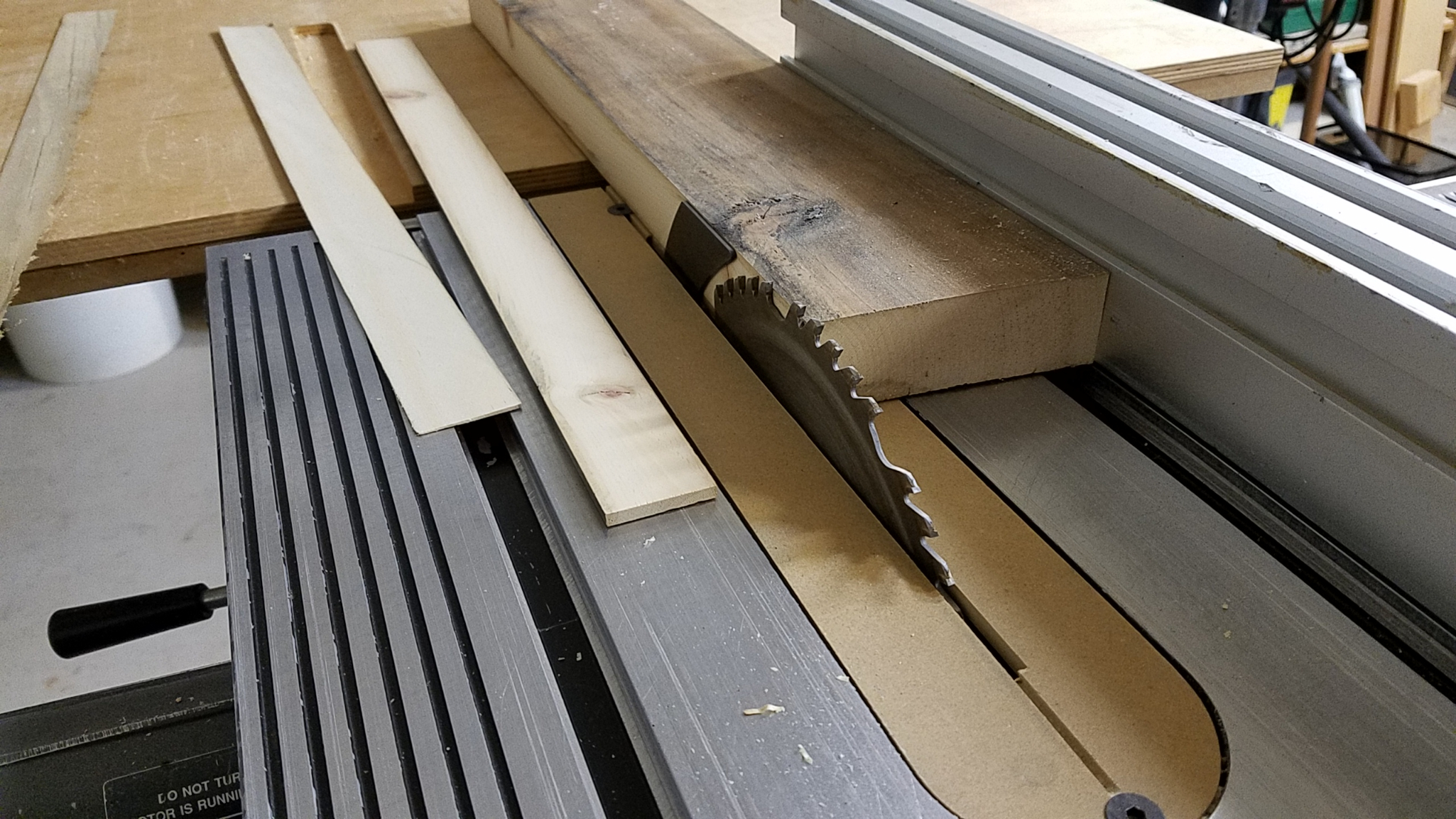

I am not sure whether you were responding to my comments or not but----
the riving knife does not protrude out of the table as high as the blade and the work piece clears the blade only a fraction of an inch before it is retrained by the riving knife.
I have always had difficulty feeling like I understood the value of the riving knife. This image, I think shows why this discussion can be confusing. We each have our own comfort zone.
As for being designed only to be used for non-through cuts--- well I guess it works that way but I can lower the table a bit and I will be doing a rip cut with whatever protection the riving knife is suppose to provide (through cut or not).
Ed, note the "shallow "dado down the center of my table insert. That is my guide line. Note also that mistakes happen. The table insert was cut to be used with a thin kerf but has used with a standard blade.
