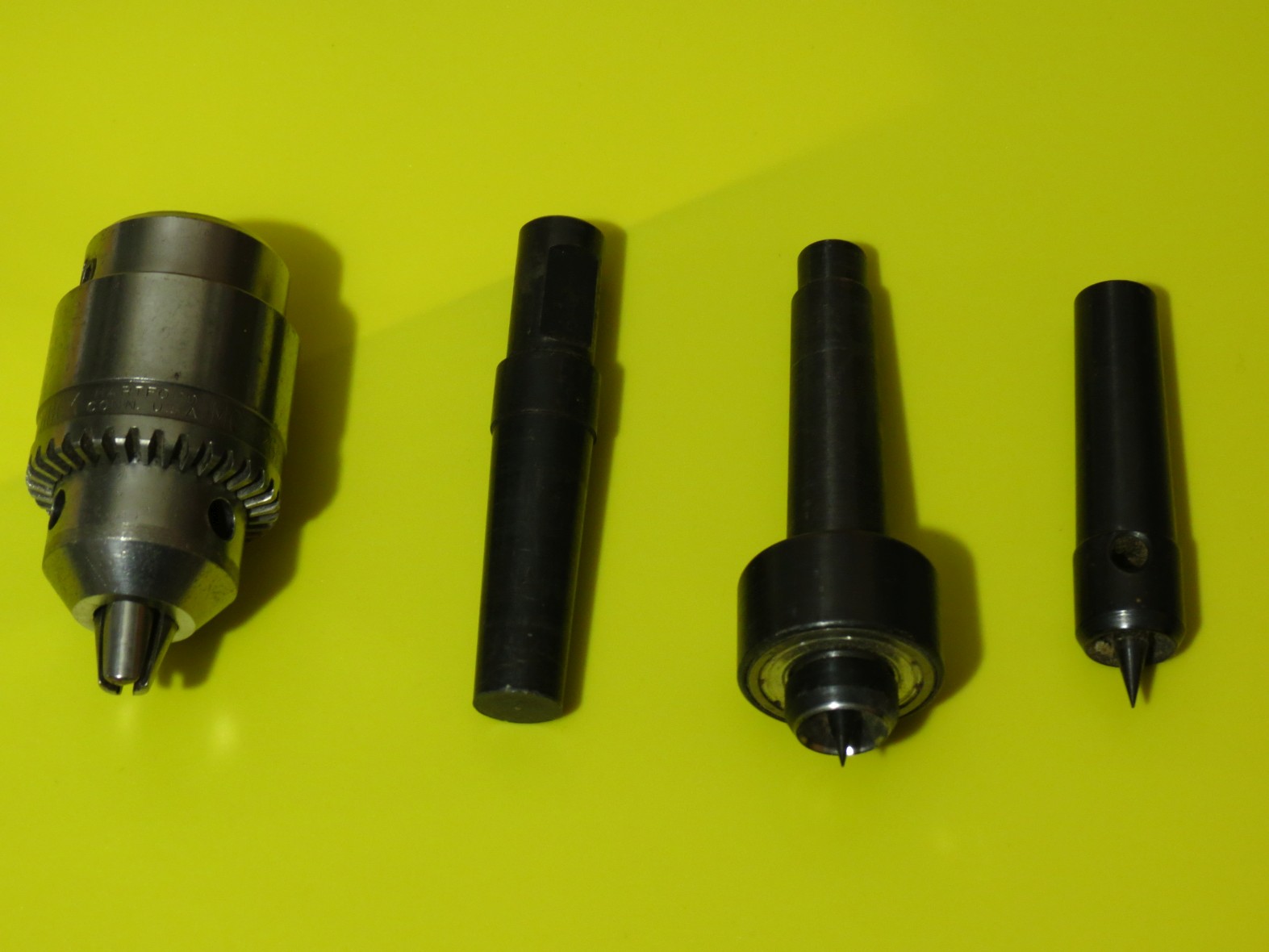

Quazit wrote:Drawing them and taking a pic was more convenient that going out to my building where it was dark lol.
The second arbor as I understand it goes into the drill chuck to mount on the other end like a tail stock mount. Seems like I read that somewhere. In fact now I remember, it was actually attched to the chuck, I had to take it out.
I have no way to attach anything to the shaft that comes out of the motor, so Im still looking for what kind of mount is used. I am looking now, it has been a long day.
Take a breath, take a day or two, take some pictures and we will be able to give you some definitive answers.

The drill chuck(far left) fits onto the quill shaft.
I am guessing the far right thingie does also. What is the thread od on it?(1/2 or 5/8 or ???)

JPG wrote:The drill chuck(far left) fits onto the quill shaft.
5/8 JPG.

I think the sketches are very good and this is a picture of what I think the sketches are of, well minus that last item which I don't have....
Are these the items you are missing?

it may not look exactly like the drawing. Guessing it is a tapered shaft the fits into the tail stock and the other end of it fits into the chuck. This way you can drill holes into wood instead from head stock. Like in working on a pepper mill.
