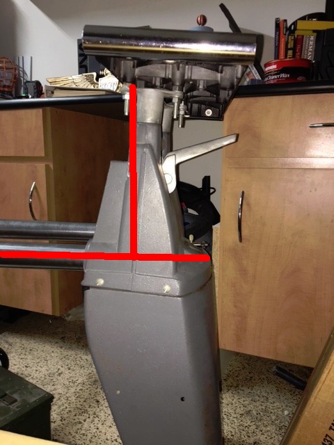

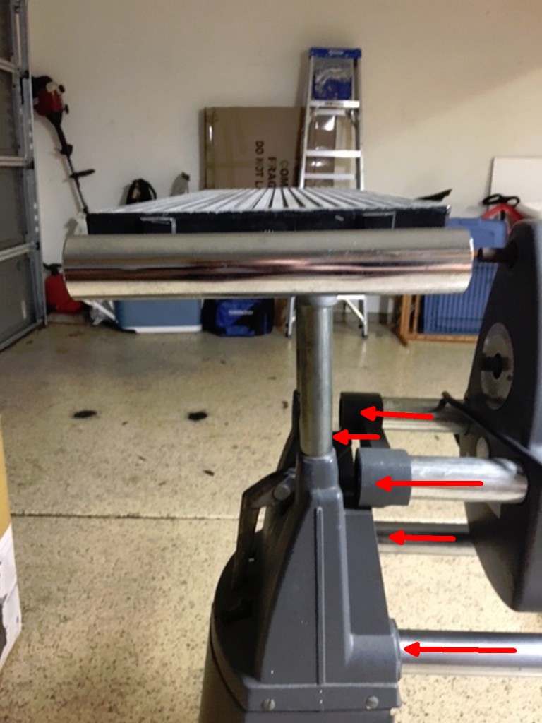

I think if you do as dusty says and measure you will find that your distance is different then it should be and the legs are now tipped.
We recently had a user with a similar problem and his pictures clearly showed the issue. These are two of the pictures that might show the issue you are seeing:
The second one show the tilt that can occurs when the tubes are not installed correctly.
Please get this corrected before using the machine or moving it about as damage can occur if left in the current state.
