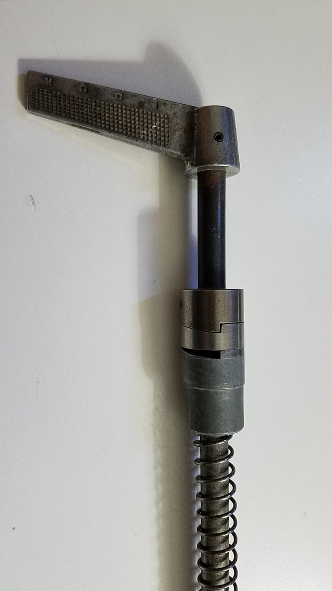

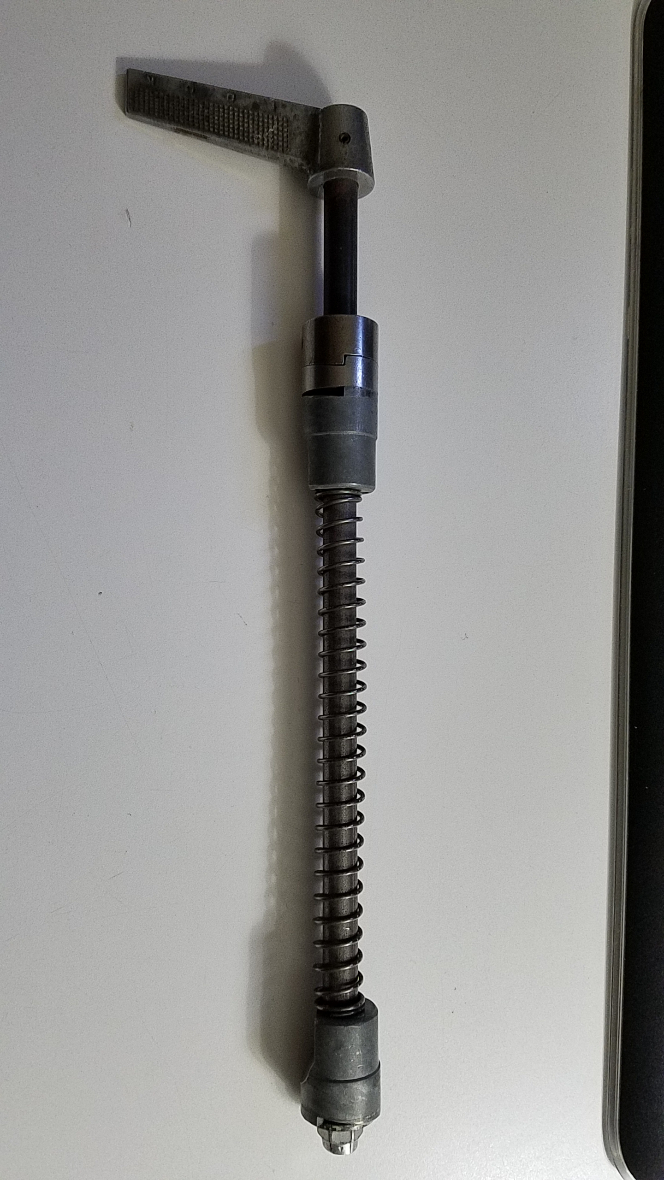

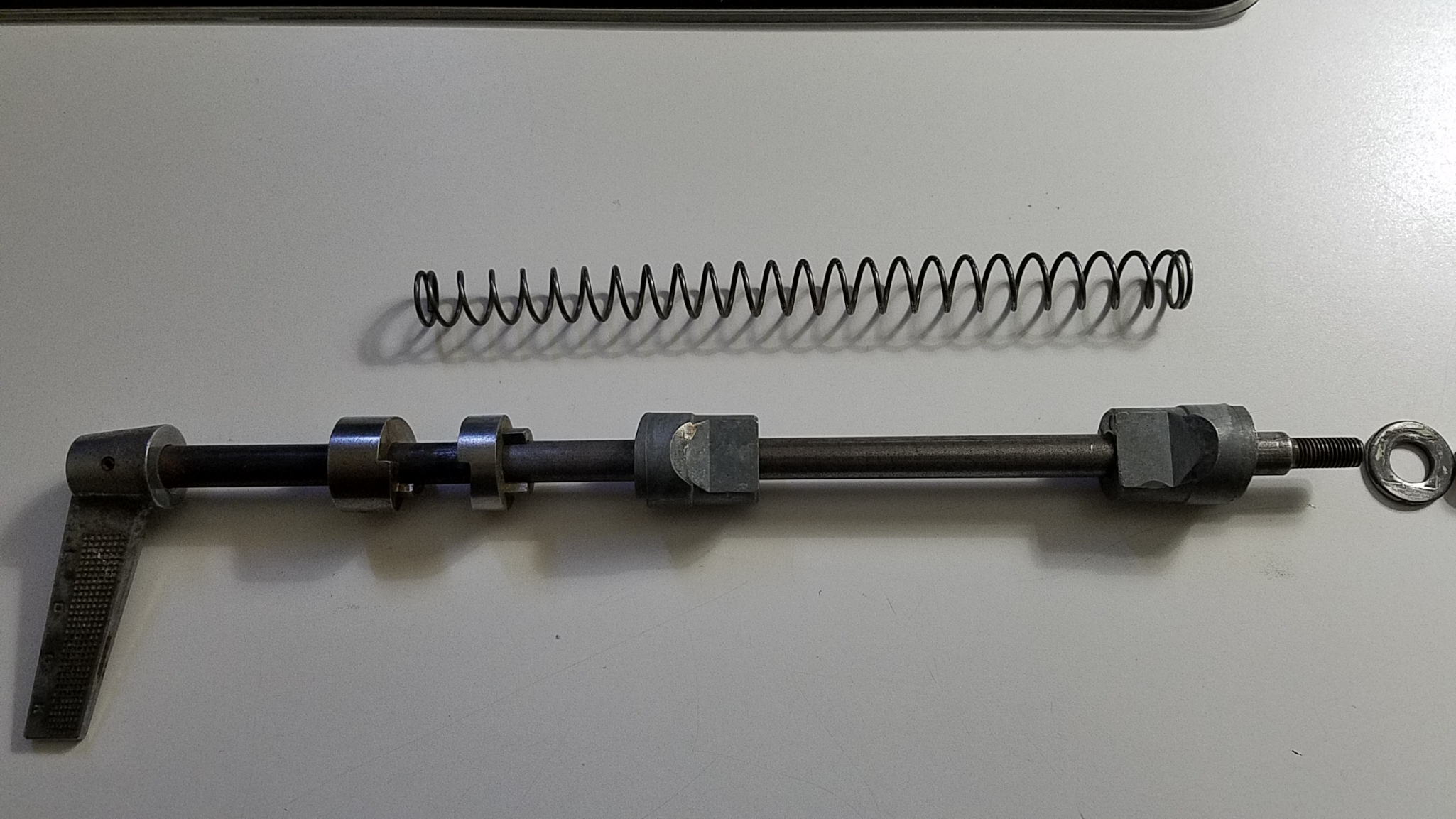

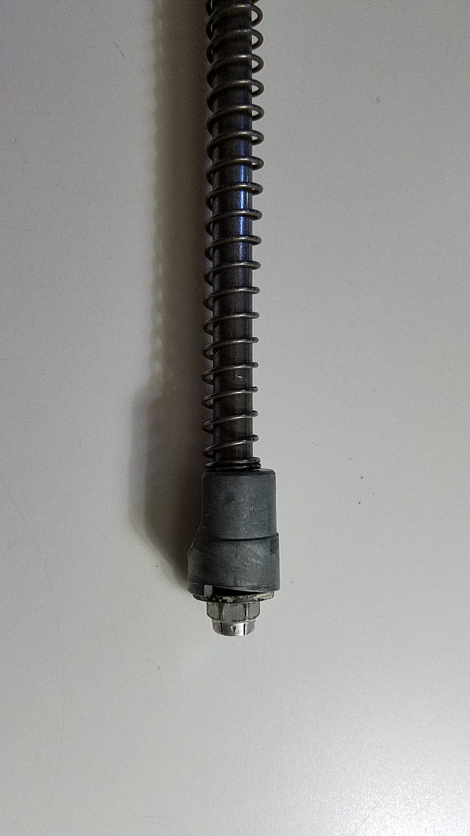

Some pictures of my spare carriage lock assembly. Comments please. Other than the flat washer on the rear end, does the hardware all look to you to be correct.

Well lets get you started. First off you are going to need some hardware 'cause I don't see it in your pictures. Lets start you going to this page:
http://www.shopsmith.com/service/mark/5 ... iagram.htm
You can pick one of the tables, perhaps you can identity which one was used before for this purpose. I don't see any of the hardware but at this point you can either start a list to order from shopsmith or to take to the hardware store. Basically you will need the 4 studs or similar, 8 nuts, 8 washers. But before going shopping made sure they are not taped in place somewhere or in the packing materials.........
Assembly is as simple as putting the parts together as shown and set it aside for later when you will do the alignment.
