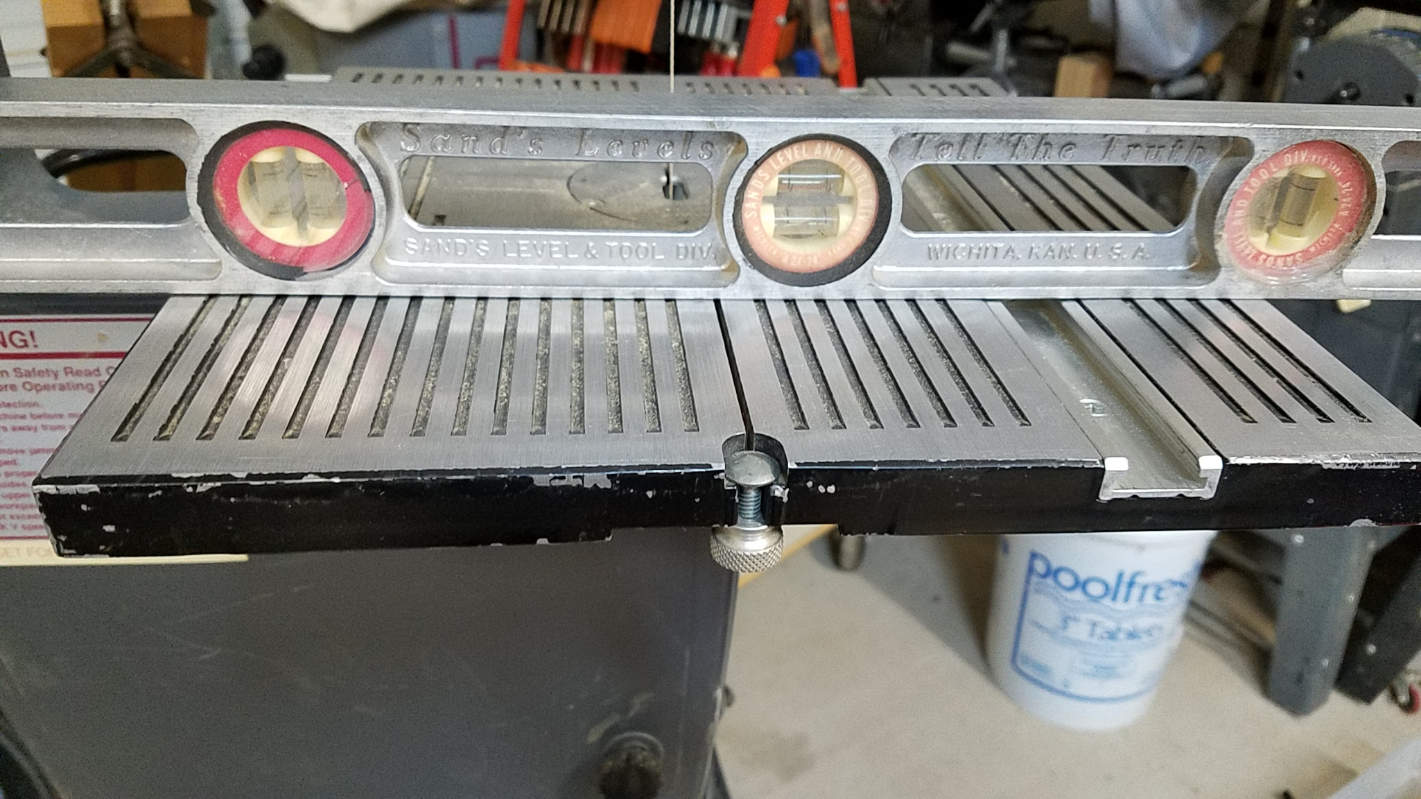

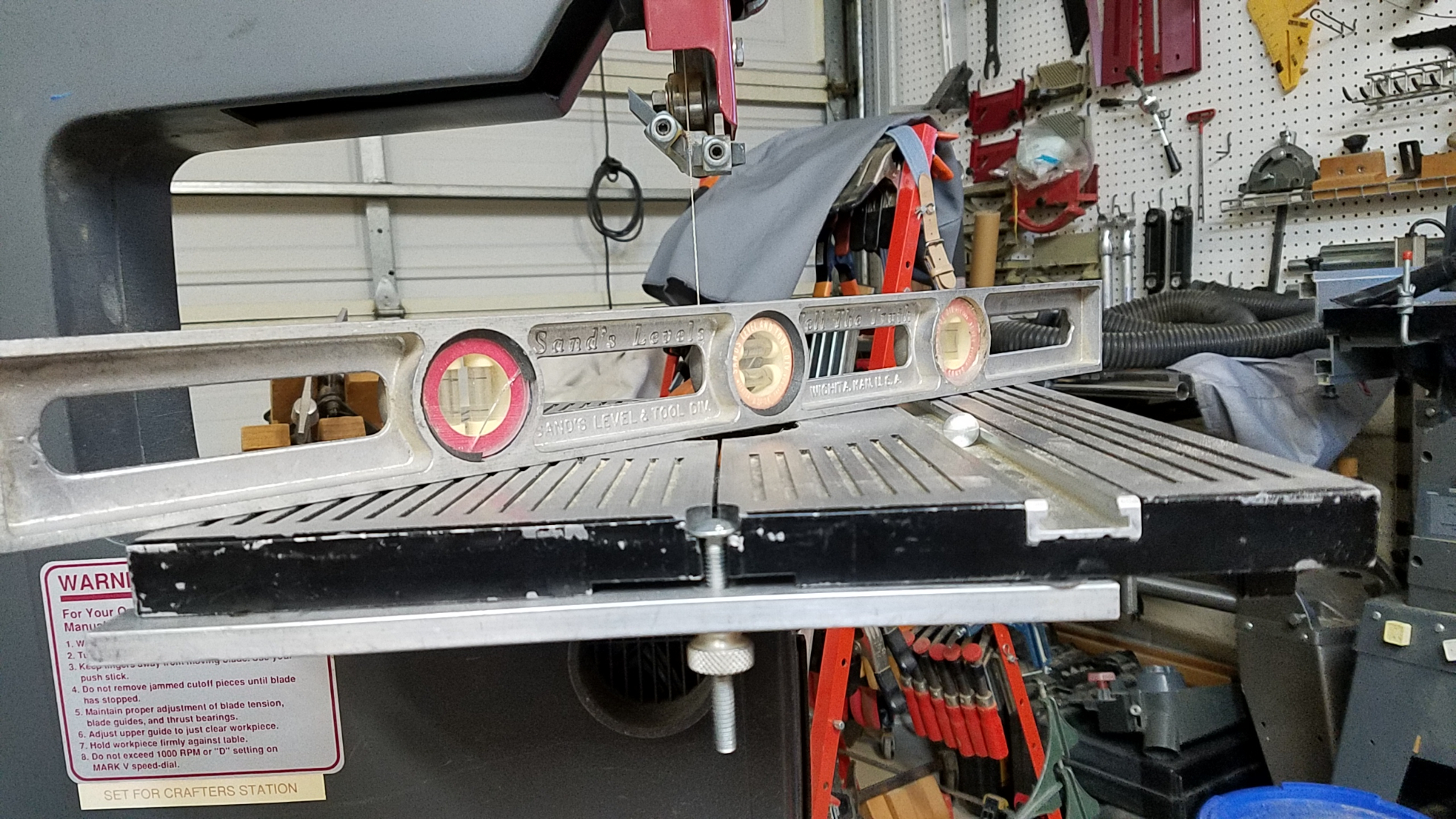

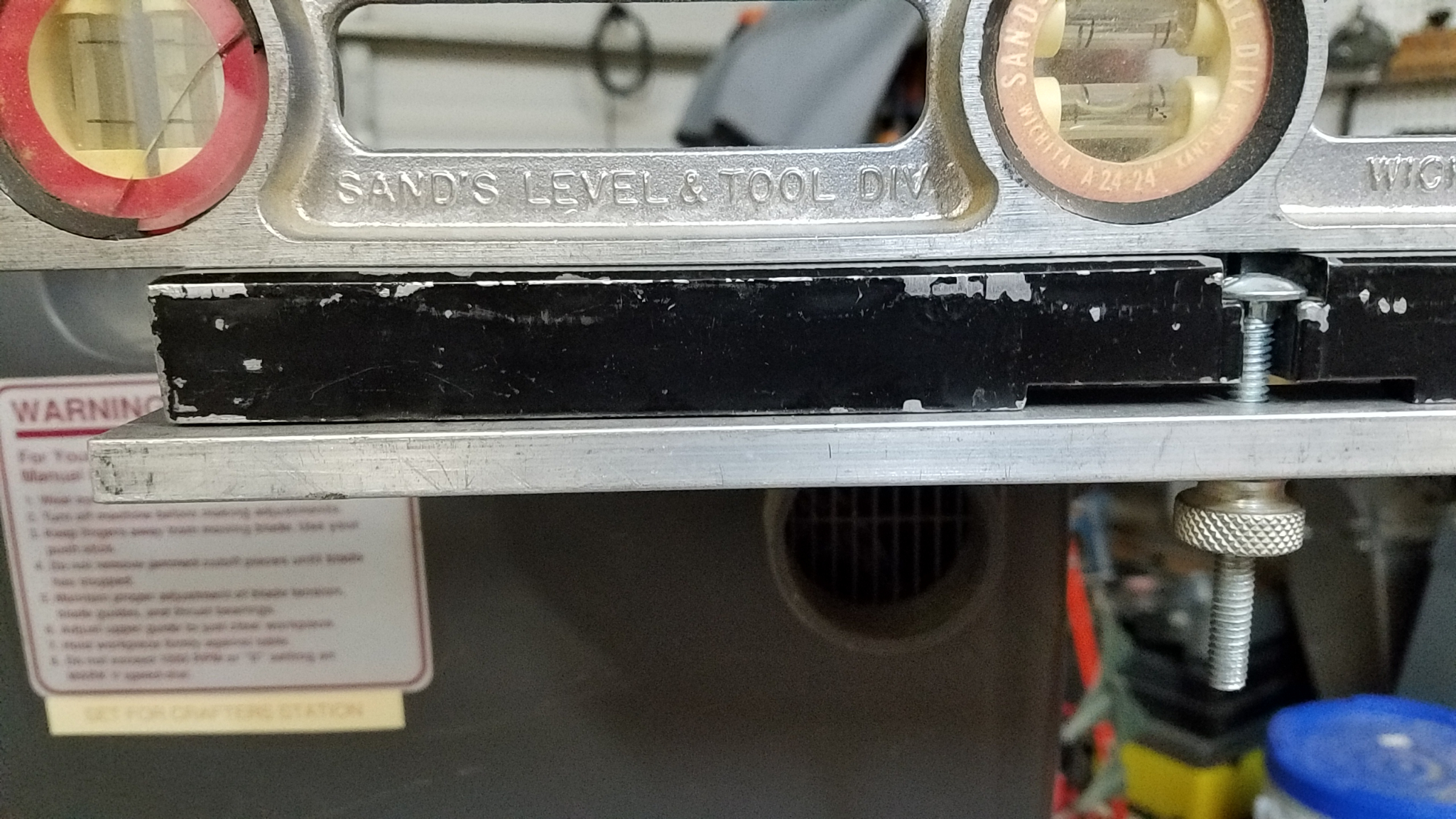

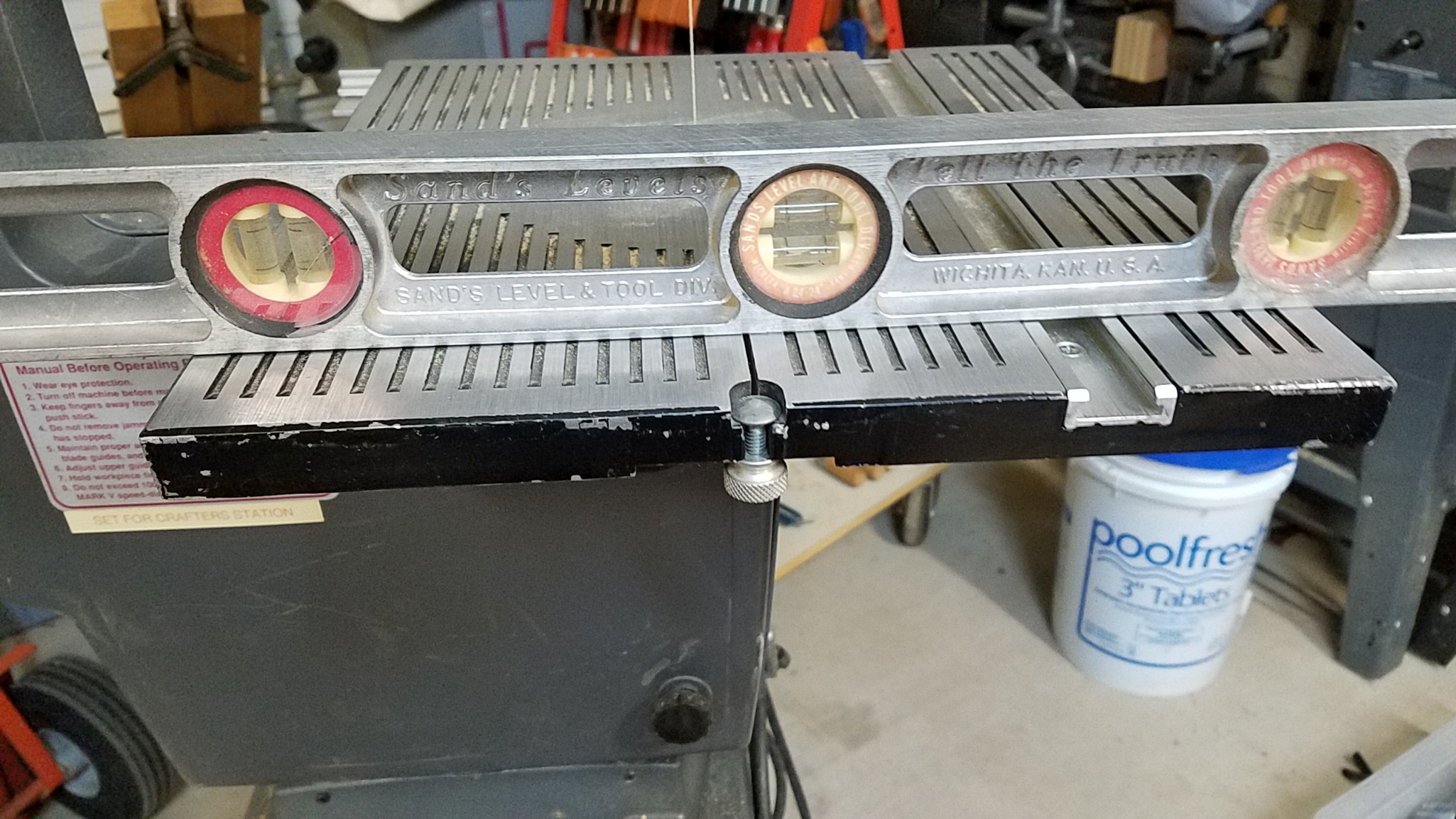

I don't doubt at all that your bandsaw table is not flat; even with the bolt on the infeed edge in place and tight. Furthermore, I don't believe you can make it flat using ordinary means.
I have mine "shimmed" so as to be square (almost) with the blade but even with shims in place it can be seen that the table is not flat.
These pictures I believe are self explanatory but questions are certainly welcome.
Bandsaw Table Flatness 053.jpg (1.84 MiB) Viewed 6689 times
Bandsaw Table Flatness 054.jpg (1.8 MiB) Viewed 6689 times
Bandsaw Table Flatness 057.jpg (1.65 MiB) Viewed 6689 times
Bandsaw Table Flatness 058.jpg (1.77 MiB) Viewed 6689 times
Please note that all of these images are of a table that has been shimmed to be square to the blade. Without the clamp(s) the left front corner is never perfectly flat to the rest of the table.
The last image shows that the table can be forced flat. As previously stated, this is caused by the slit in the front half of the table.

I hope that what I show here applies to your issue as well as it does to mine.
What I have here is a kludge arrangement but it did convince me that the table could be almost flat. It is certainly flatter than it was when I began this effort earlier this morning.
The single bolt in the middle just does not do what is needed.

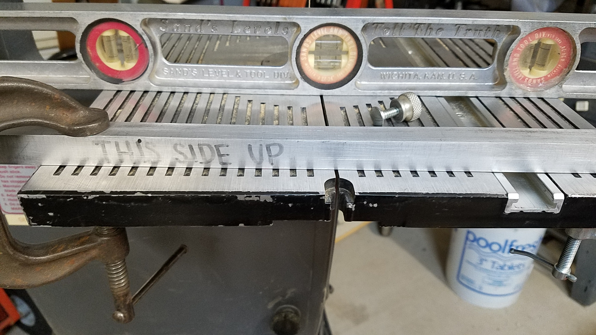

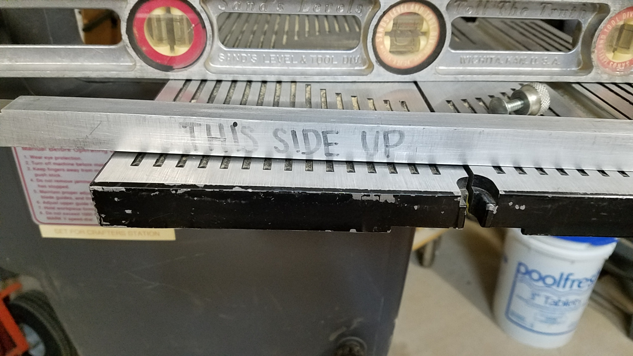

Bandsaw Table Solution (flatness) 002.jpg (1.74 MiB) Viewed 6685 times
Bandsaw Table Solution (flatness) 003.jpg (1.83 MiB) Viewed 6685 times
Bandsaw Table Solution (flatness) 004.jpg (1.99 MiB) Viewed 6685 times
There are two untapped holes on the underside of the aluminum bandsaw table. I am contemplating tapping those holes and using them along with the one we have been discussing to draw the table flat

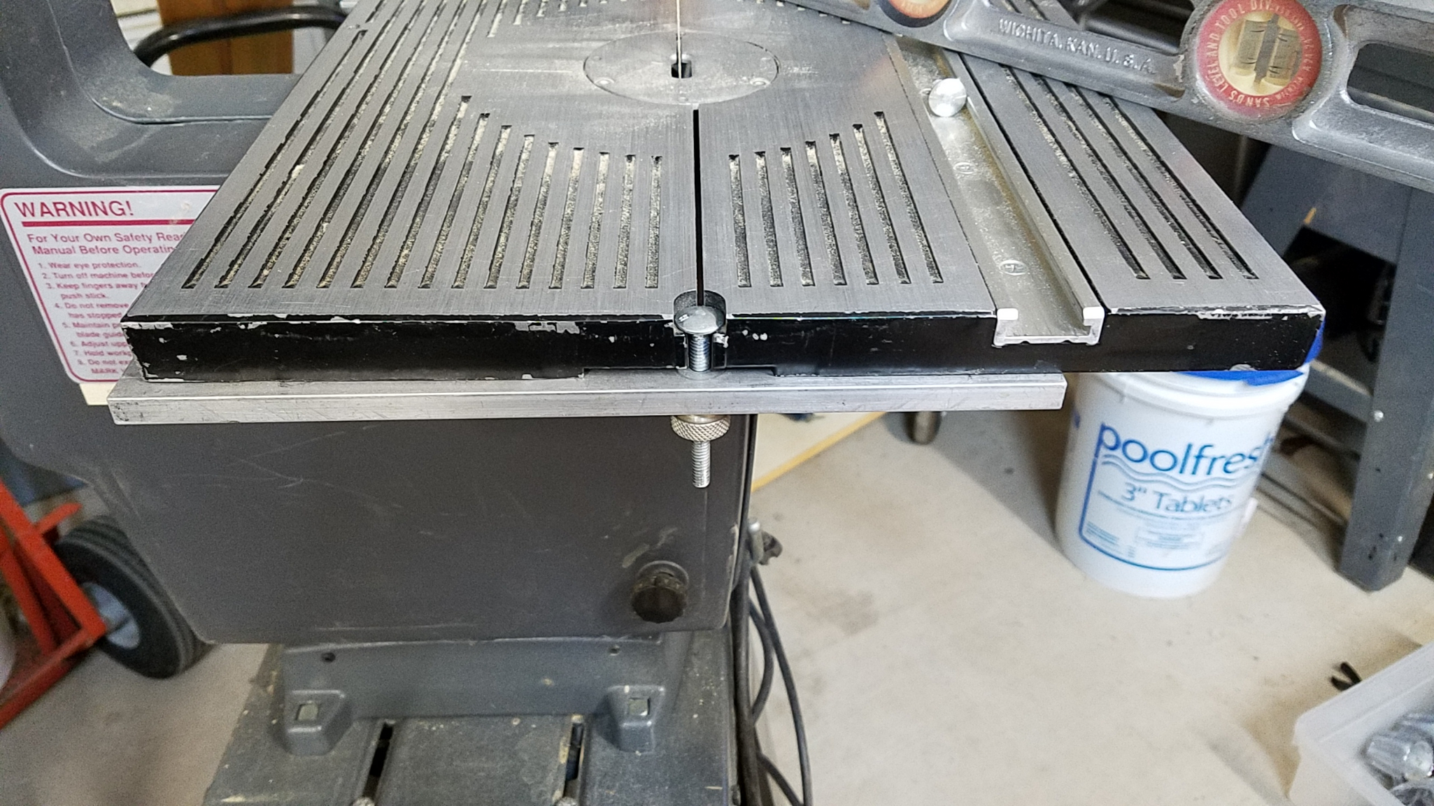

There is no need to check your bandsaw trunnions. Mine are perfectly fine. What I suddenly realized is that the trunnions are individually adjustable. Just loosen the table tilt lock and rotate the trunnions to wherever you want them. I clamped the trunnions to a known flat plate and then locked the trunnions in place (table tilt lock).
I then reinstalled the bandsaw table. The table contacts the trunnions at all four bolt locations (NO SHIMS). I set the table to be horizontal (square to the blade) and reinstalled my cheater bar across the front of the table.
Much to my pleasure, the table is square to the blade and flat.
I did two things differently than I have ever done in the past. I leveled the trunnions without the table in place. Then after installing the table, I installed the flattening bar across the front edge of the table. The table is flat corner to corner.

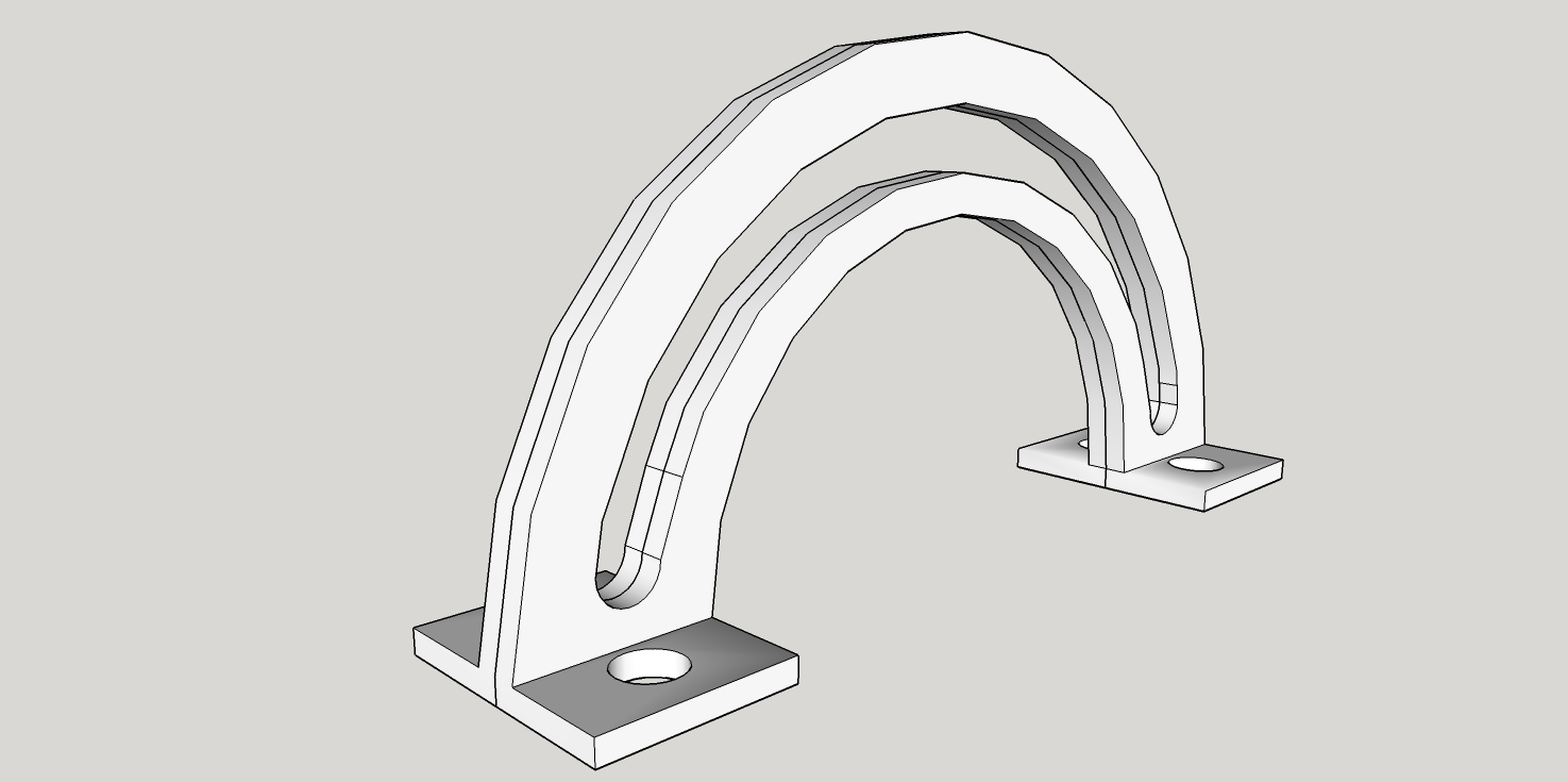

This is not quite all of the story but I will present the rest with a diagram of the flattening bar. But with what I have presented here, you can validate your bandsaw table just as I have done. This is not the "fix" it is only the "concept verification". The fix is in the flattening bar mentioned above.
