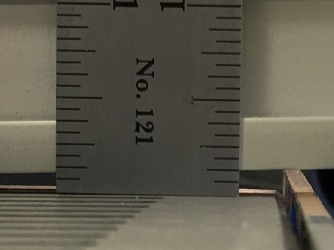

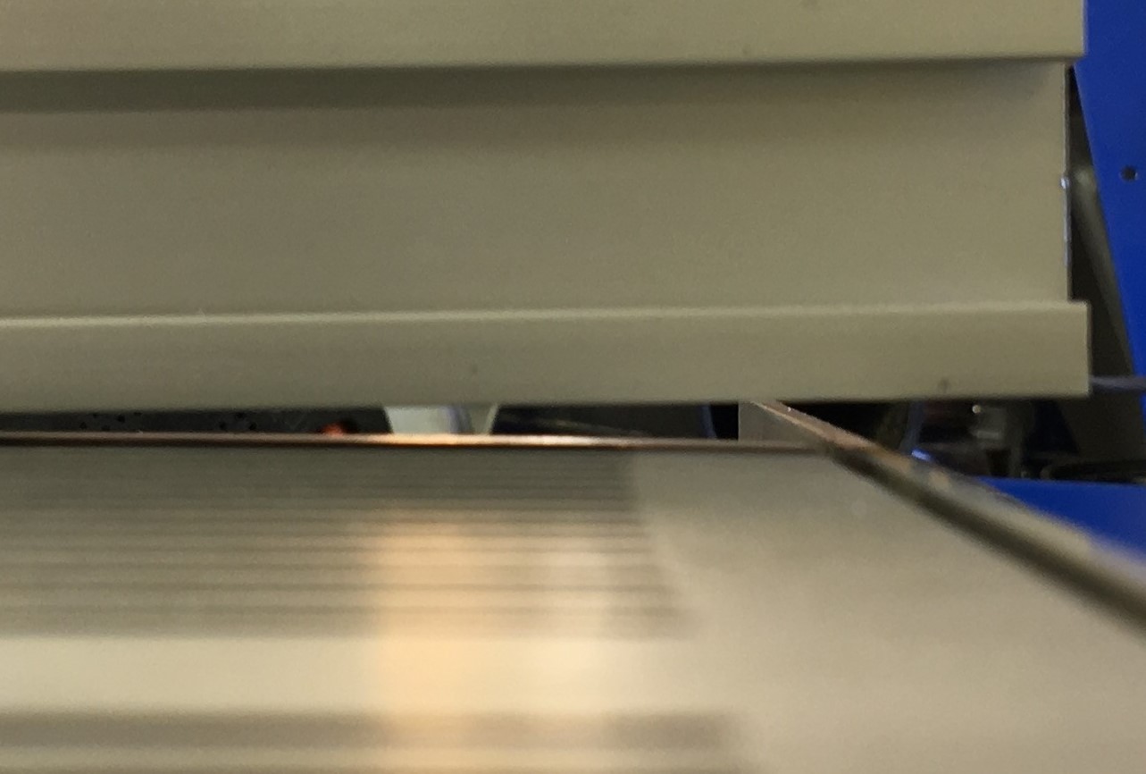

I finally got some pictures done. I have not taken anything apart. In the first picture I am pressing down hard on the front of the table. The second picture is probably more reasonable. The bottom of the fence is not tuching that bar on the end of the table.
- IMG_0251 (4).JPG (138.33 KiB) Viewed 5852 times
- Pressing down on front of table.
- IMG_0260 (3).JPG (69.49 KiB) Viewed 5852 times

I think we need to be looking at the other end of the fence.
Is the 'problem' warped, or fence does not rest on table?
Re: My bandsaw table is warped
The fence is fine. I checked it with a straight edge prior to taking pictures. It is definitely the left edge of the table. I used the same straight edge on the right side of the table and it was flat all the way across. Fence does not rest on left side of table but does on right side of table.
