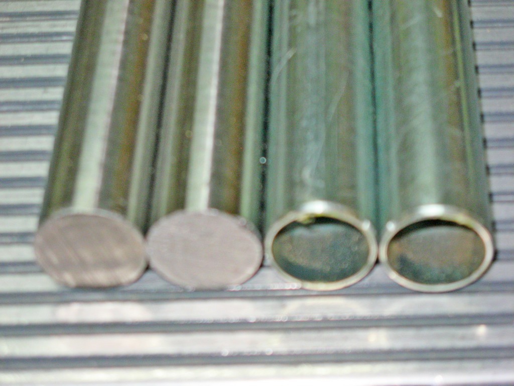

I got tired of the flimsy Shopsmith tubes and found these instead.
https://www.metalsdepot.com/products/co ... 20&aident=
They are solid steel precisely ground to a .001" tolerance.
The picture shows how they compare to the standard 5' connector tubes. I had them cut to 65 inches and the cost was $136 for both. They do weigh about 15 lbs each but make a world of difference in not only alignment but the increased stability of the tables.

I may be wrong but that seems like overkill to me!sehast wrote:I got tired of the flimsy Shopsmith tubes and found these instead.
Re: 510/520 table connector tube length
Yes it probably is but their 1" dia DOM tuning with a .120 wall (think 10ER thick wall bench tubes) is only $85 for two 6' lengths. About $30 more than the SS 5' tubes.Ed in Tampa wrote:I may be wrong but that seems like overkill to me!sehast wrote:I got tired of the flimsy Shopsmith tubes and found these instead.
They will be ordered this week. Thanks sehast for the link. That is a keeper!
