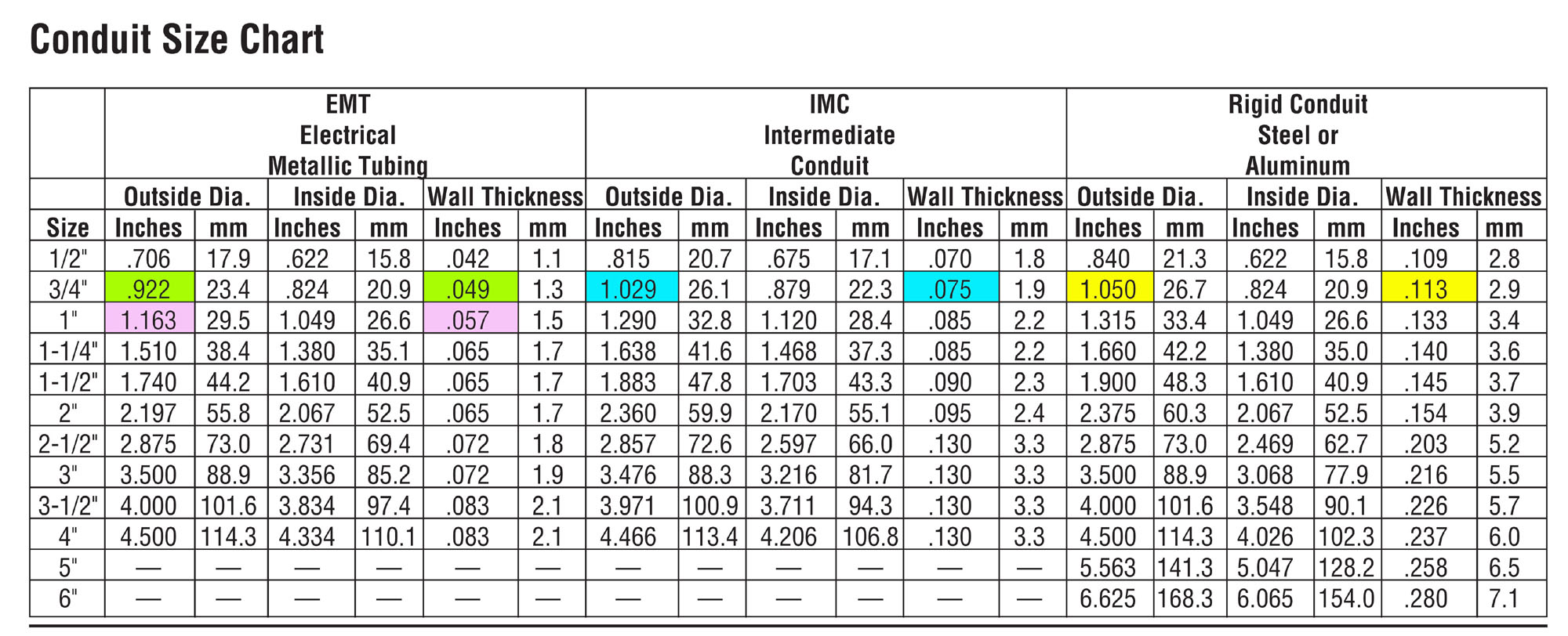

EMT is the thinnest wall version of the three main types of metallic electrical conduit. It is what you will typically find at hardware stores. Other types (IMC and Rigid) with thicker walls (and larger outside diameters) can be found at electrical supply houses. The below chart is from one manufacturer; there will probably be slight variations between suppliers. The sizes closest to 1" O.D. have been highlighted. Not owning a 505, 510, 520, or a Mark 7, not sure how critical the O.D. of the connecting tubes is; I found one post which said the O.D. of the Shopsmith connecting tubes was 1". And the differences in the rail types (round vs. extruded) and earlier vs. later versions of the 510 system, may affect which size conduit may work best for any given SS owner.
- Electrical Conduit Types, Sizes.jpg (296.93 KiB) Viewed 17387 times
Re: 510/520 table connector tube length / Conduit O.D.s
Thank you for posting this chart. It very clearly shows that EMT is not what should be used AND it serves as education for me. I have never had to pay the price for not knowing the difference between EMT and Rigid Conduit because I knew what I wanted when I went shopping. Had I ordered this without seeing it, I would have had a return task.br549 wrote:EMT is the thinnest wall version of the three main types of metallic electrical conduit. It is what you will typically find at hardware stores. Other types (IMC and Rigid) with thicker walls (and larger outside diameters) can be found at electrical supply houses. The below chart is from one manufacturer; there will probably be slight variations between suppliers. The sizes closest to 1" O.D. have been highlighted. Not owning a 505, 510, 520, or a Mark 7, not sure how critical the O.D. of the connecting tubes is; I found one post which said the O.D. of the Shopsmith connecting tubes was 1". And the differences in the rail types (round vs. extruded) and earlier vs. later versions of the 510 system, may affect which size conduit may work best for any given SS owner.
Also clearing indicated is the proper size. Ine inch OD is what is required for the extension tubes. That is achieved by 3/4" rigid conduit (1" rigid conduit)! Thanks again.
