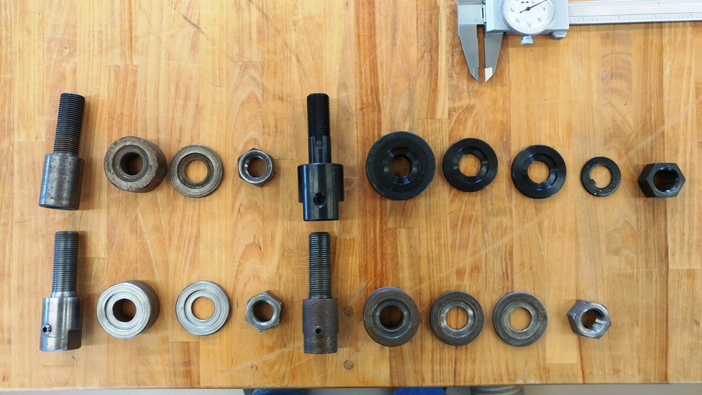

OK, I finally got curious enough to dig out all of my arbors that came with the 5 10ER's I have. That was 3 arbors and this is what I found about all three.
The threaded portion is 1 13/16" long, threaded all the way and no key way.
They all take a 1/8" allen wrench in the set screw.
Two have the normal wrench flats on the spindle end and one does not .
They all have the 3/4" thick by 1 1/2" dia spacer and is under cut.
Two of them have a single under cut 3/16" thick by 1 1/2" dia spacer and one has two.
In contrast the current (late 90's) arbor has this.
The threaded portion is 1 15/16" long, partially threaded with a key way.
It takes the now standard 5/32" allen wrench in the set screw.
It has the wrench flats on the spindle end and the spindle end is larger in diameter.
The thick spacer is 5/8" thick by 1 7/8" dia and is under cut.
There are two 3/16" thick by 1 1/2" dia spacers and a keyed washer.

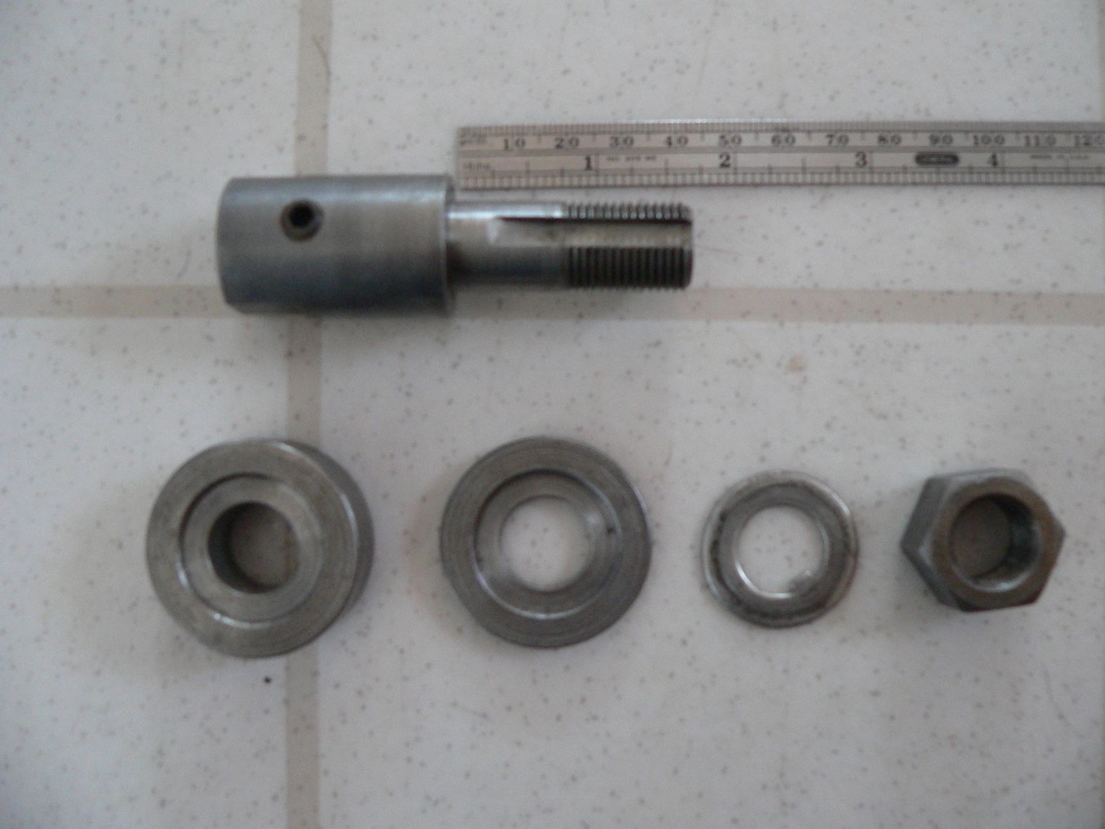

I have to think the arbor you have (pictured in post 232815) is very unique. The spindle end looks to be the same diameter as the other 10ER arbors but you say it has a larger set screw. The threaded shaft is only 1 5/8" long and not threaded all the way and it has a key and keyed?? washer. That is why with only one 3/16" spacer the nut is flush with the end of the shaft.
Garys:
I think you have a standard 10ER arbor but missing the 3/4" spacer.
The real odd ball is the one RPD has.

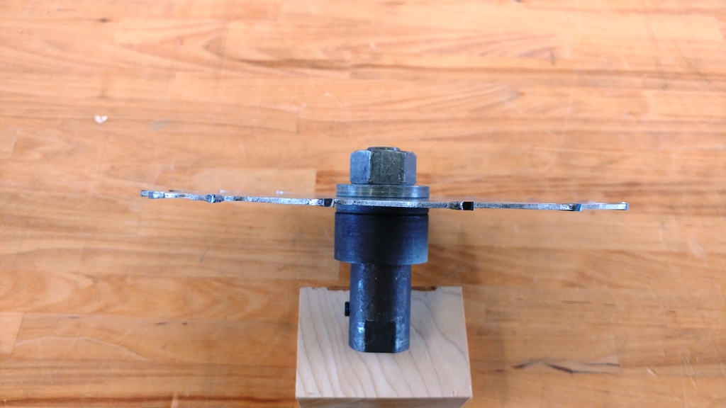

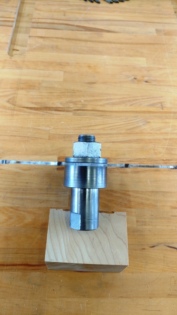

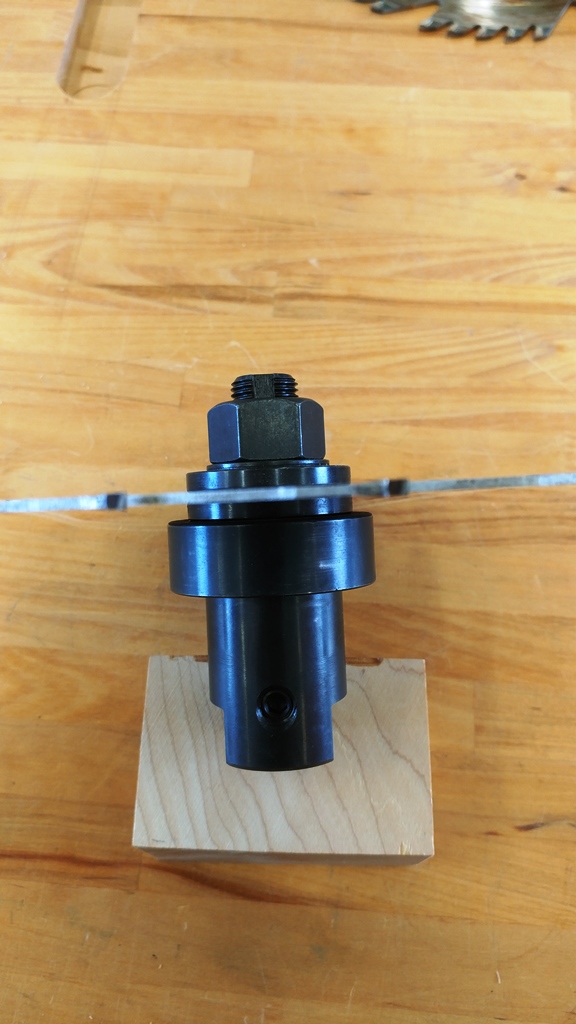

The pictures show 3 10ER arbors and the current SS arbor. The blade is thin kerf so subtract 1/16" from the shaft protruding from the nut.

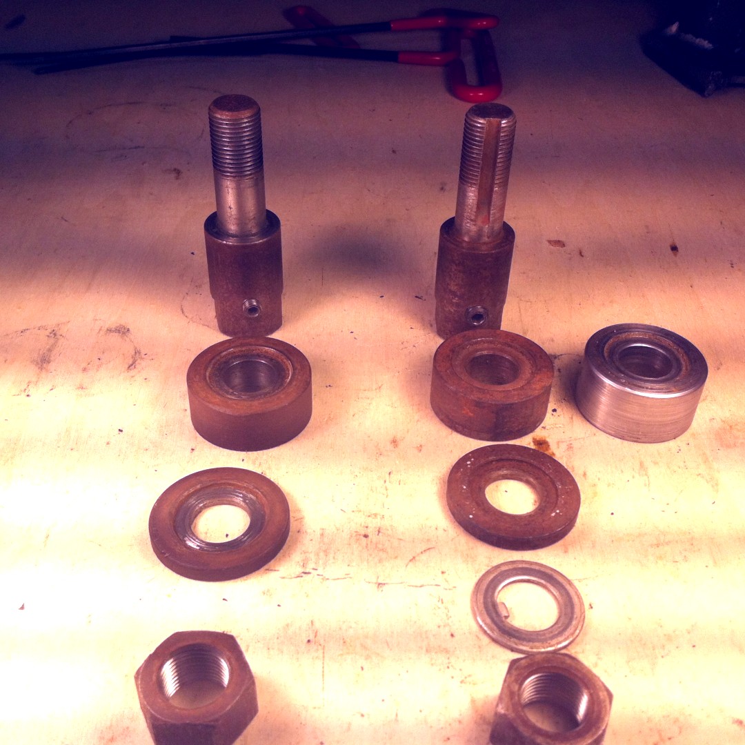

Sorry for the delay in responding, it has been a busy week.
I think I may have solved the mystery of the anomalous arbor. Today I climbed up and check my boxes of parts on the high shelf, and found a 3/4" washer in state of rust that matches the other parts of that arbor, (which is bright steel, not aluminum :o ), so I suspect that thicker washer was not stock and had been swapped in from a different arbor.
I have taken a new picture of the two arbors.
The one on the left has the 1/8" set screw and no key-way. Consistent with the 10er accessory catalogs.
The one on the right has the key-way and the 5/32" set screw, (and is reunited with the correct thick washer), Consistent with the 1954 Mk5/10er accessory catalog
Neither of them is threaded all the way. It could be that the length of threading was different between arbors made in the California plant and those made in the plant back east.
Regarding the arbor mentioned in the preliminary 10e manual. We know it was written based on the prototype machine and that there were other differences between that one and the production run. So either the design was changed prior to production or the person writing the Preliminary Manual made a mistake.
The 10e Owners Guide describes the arbor this way.

Can you please explain why the longer 5/8" arbors shouldn't be used for saw blades? When I got my 10ER a thin kerf saw blade was mounted in such an arbor, although mine had a keyway and tabbed lock washer. The 3/4" spacer was against the arbor, then the blade, then the 3/16 spacer outside of the blade, then washer, then nut. It doesn't seem like this would be any less safe than the arbor spacer setup in the Powermatic saw I normally use at the cabinet shop, which has no keyway or washer, and the rotation of the blade as always keeps the nut tightened. Considering these arbors would also be used for dado stacks with the 3/4" spacer removed, a 1/8" or thinner blade would seemingly go through the wood with much less resistance than a dado blade (not considering depth of cut).
Also, I know it's an old thread, but I'll contribute my find. I got 2 identical arbors with mine, one with a saw blade mounted, and one with a 1/2" thick grinding wheel mounted. The 5/8 portion is 1 5/8" long without being threaded all the way down. Every unused arbor that looks like mine show the second 3/16 spacer, so I assume they were misplaced long ago.
